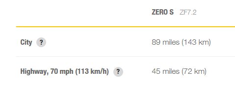

    From an aerodynamic perspective the math is pretty simple, twice the speed yields four times the drag. For example: the drag at 70mph is four times the drag at 35mph. It takes that much more horsepower (and fuel) to overcome the increase in drag. This aerodynamic principle applies to any vehicle, not just Tacomas, but the fuel consumption may change slightly for different engines and gearboxes.
    We all like pictures, here is one explaining power available versus power required and one aspect of max airspeed of a particular aircraft. Note the difference of horsepower required between a speed of 60 and 120.
