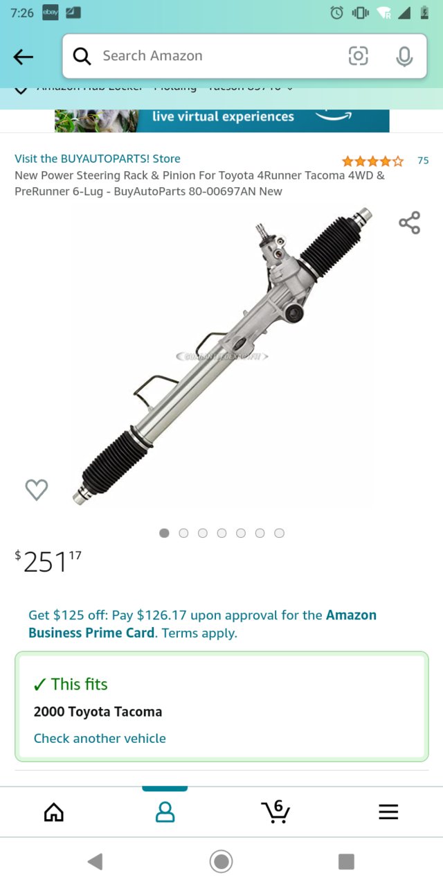

    You can get an OEM replacement for about $400.00. standard price anywhere you check.

    Primal00
    Primal00 Member
    Sep 25, 2021
    #378065
    5
    This would be the one..
