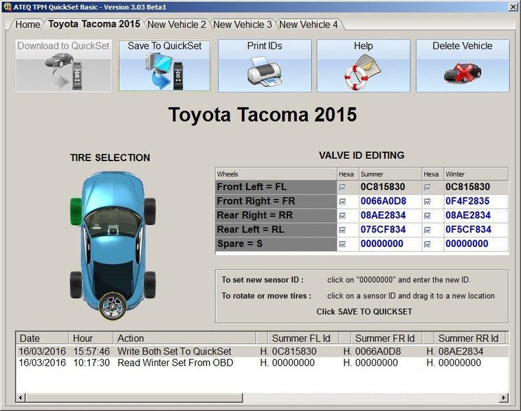

    The ECU should have 5 spaces available, including spare.

    Thanks! Is that a screen shot of the latest TechStream version? It looks different than what I remember from using 2 years ago.

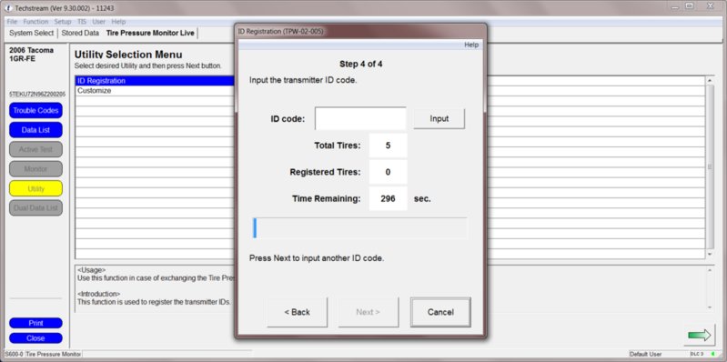

    The Techstream version is here:

    Thanks again! What software is the first screenshot you responded with?

    ATEQ. Click on the image, which will bring you to the corresponding thread.

    Well...I finally got my matching wheel, got a used Tacoma sensor of eBay, so now I have a complete OEM 5th wheel spare setup mounted and at 35psi.
    My frustration and request for help is I installed my Drewtech Mongoose OBDII software/driver and got my 2 day tech stream subscription. Connected fine between my computer and ECU. But I can not figure out how to replace the 5th Tire sensor data...it is currently 0000000.
    Looking above in post 4 at the second image, when I go into the ID registration, on my screen it says Total Tires 4, where in that picture it's 5. So I'm only able to enter 4 sensor IDs before the registration program quits.
    Is there a way to change the value to 5 tires?

    There is no space on the computer for a 5th TPMS. I spent 3 hours at a dealer trying to have the one in the matching spare added. I was told it can not be added. So I know your pain. I even sent a question to Toyota about it. I was told the same thing. The people at Yota need to start asking us what we want!!!
