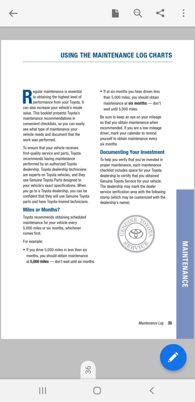

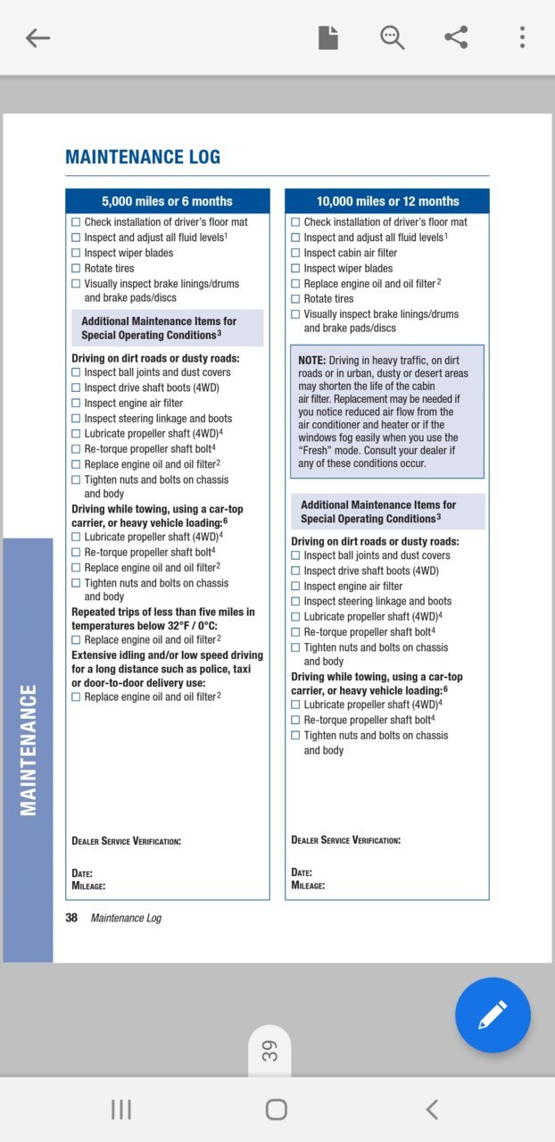

    Some folks are missing the fact Toyota recommends scheduled maintenance based on miles, months and/or special operating conditions.
    Only the owner/driver and not other forum members or even the dealership can determine the proper scheduled maintenance intervals.
    I rarely change oil at 10K since I don't drive 10K annually. Instead I change my oil annually or sooner if I've been operating my Tacoma under special operating conditions. Screenshot_20191004-163729_Adobe Acrobat.jpg Screenshot_20191004-163805_Adobe Acrobat.jpg

    The best method for proper oil change interval for your truck OP is the following. Choose your oil of preference and do a series of oil analysis tests (about 3 tests to develop a trend). The lab will give you a recommendation on what an appropriate OCI should be for your vehicle.
