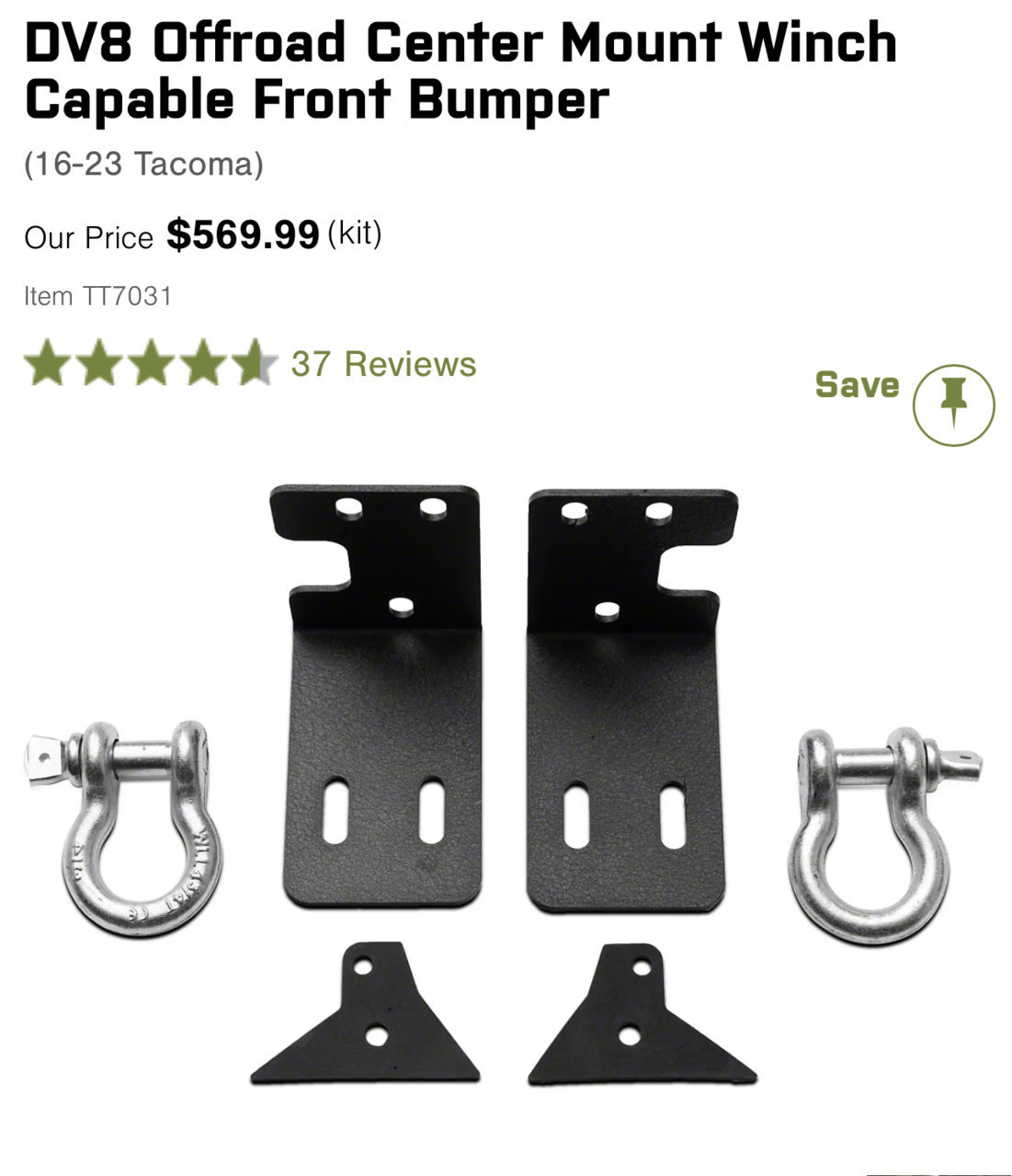

    Pictures of the DV8 where it's thinner? The stock crash bar is just an aluminum beam extrusion, relatively thin. Is the DV8 model you're looking at aluminum or steel?

    @3JOH22A, this is what replaces the crash bar, from squared aluminum factory to this plate steel.
