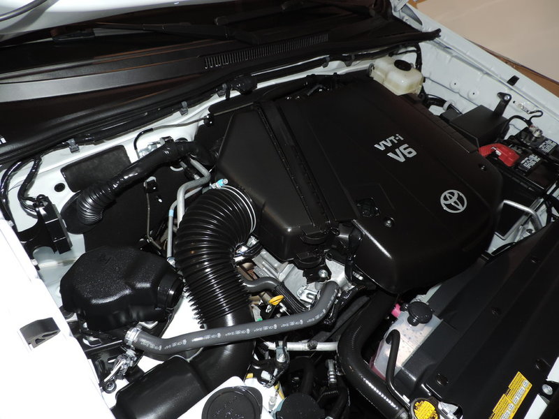

    Here is what mine looks like when I get done with it…..
    The truck gets a bath every 7-10 days as well as the engine bay cleaned and detailed.
    All I use is simple green straight up a gong/fender brush and a wheel woolie for the tight areas then some stoner trim shine/shine spray or Adams In & out spray…..

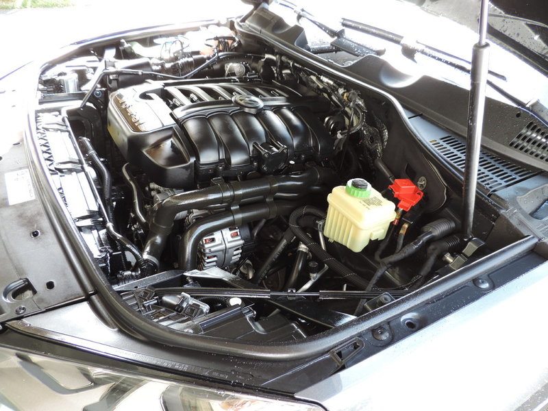

    And here is a Pic of my Volkswagen Touareg which is a 2012 still looks new but then again it has only about 18,000 miles on it….

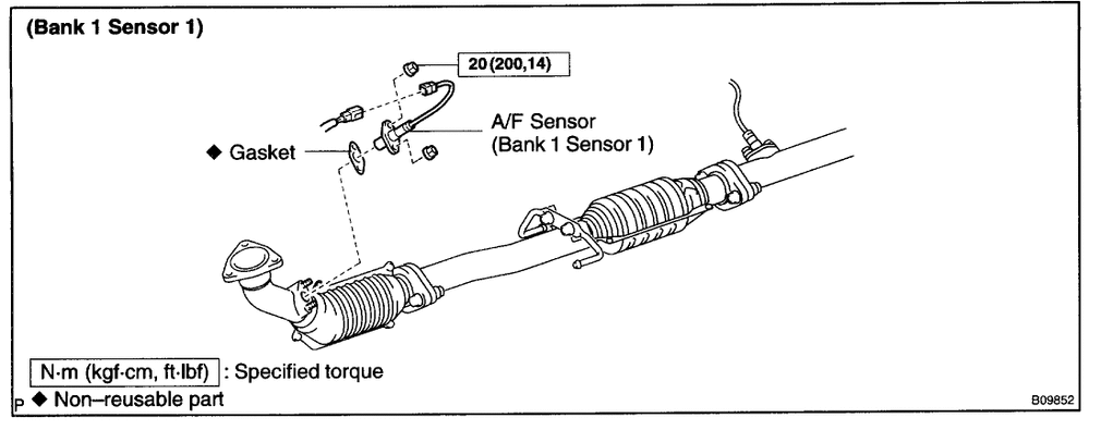

    I thought the air fuel sensor screwed into the manifold before the cat or am I thinking of something else?

    This is for a 2.4L on a Tacoma Prerunner why would it be any different other that having another bank added (bank 2 sensor 2) for the other cylinders? As it clearly shows it before the catalytic convertor.
    Starting from 1996 all vehicles with OBDII system requires to have at least two exhaust sensors. The sensors are located before and after the catalytic converter. The sensor before the catalytic convert is also called Αir/Fuel (Α/F) Ratio Sensor and it is used by the Engine Control Μodule (ECΜ) to adjust the air/fuel ratio. The rear O2 Sensor located after the catalytic converter is used for the catalytic converter efficiency and monitoring.

    This occurred on a Gen1 2.4L Tacoma. I mentioned it as a point of caution. I haven't looked yet at my 2015s 4.0L AF sensor(s) location. Could be they are farther back than the Gen1 2.4Ls. Again - when washing the engine, be aware of these buggers.
    The air fuel sensor is the first you'll encounter if you follow the path of your exhaust pipe(s) starting at the manifold. It looks very much like an O2 sensor.
    The O2 sensor is the next along the way, usual a ft. or two further back from the AF sensor. The distance between these 2 sensors is model dependent.
