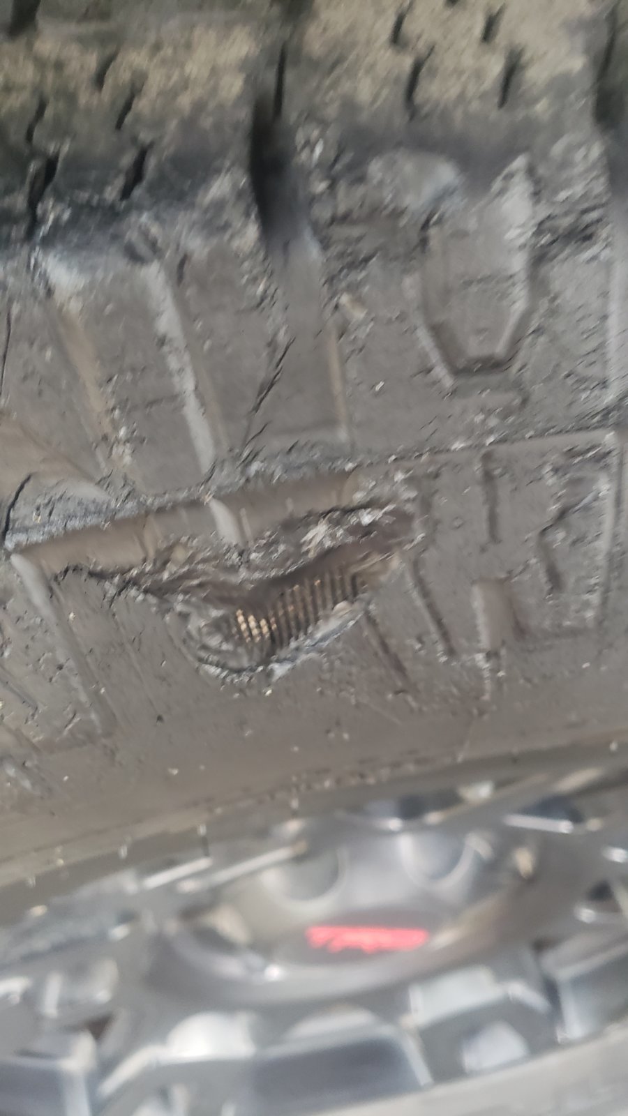

    My stocks were off before I hit 100 miles. Just read too many issues of the factory tires not holding up with extensive dirt use. I went E load 265/70/17. They served me well for about 35k miles before an unfortunate incident on some volcanic rock chewed up a couple sidewalls which resulted in some expensive decisions into how my truck sits today. At least 6000 offroad miles in that first 35k not a single puncture despite some hard (fast) dirt driving
    Pic of sidewall damage.
