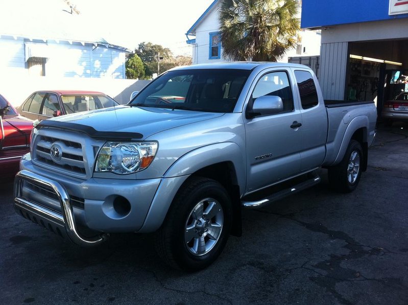

    Hi. I have a 2005 access cab 2.7 4x4. It has 89,547 miles on it and so far nothing has been done to the transmission as far as maintenance. Any suggestions? Thanks. tacoma 007.jpg
