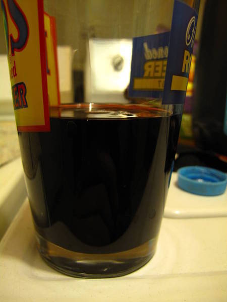

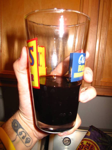

  16. Feb 26, 2012 at 8:42 PM
    #36
    AstroluxAtom
    AstroluxAtom Well-Known Member
    Feb 25, 2012
    #73581
    55
    Sunnyvale, California
    '05 v6 4.0L DCSB Offroad Prerunner Debadged
    3" Pro-Comp lift kit, Pro-Comp Tires, Magnaflow exhaust dumped at rear axle.
    Heres the used fluid @ 113k miles. Very dark maroon (BLACK) but it smelled fine. Pretty sure it has never been changed before...I didn't see any signs of wear on the outside of the pan bolts.
  17. Feb 26, 2012 at 9:41 PM
    #37
    Rich91710
    Rich91710 Well-Known Member
    Feb 23, 2012
    #73470
    16,331
    Rich
    Los Angeles
    08 Base
    Satoshi with FJ badge, factory cruise, factory intermittent wipers, Redline Tuning hood-lift struts, Hellwig Swaybar, Rosen DVD-Nav
    That's not a flush, that's just two sequential "drain and refills"... the same thing we should be doing every 60k.
    I wouldn't normally have an issue with what he did (the 2nd change is better), except that he added detergent to the first change.
    ATF is a VERY highly detergent hydraulic fluid in and of itself. I'd be concerned about compatibility between his detergents and the Toyota WS ATF, and of course, that detergent circulated through the entire trans, but his 2nd fluid change only replaced about 4 quarts of the 16 or so in the trans, so that detergent is still in there.
    BTW: 2nd Gen Tacomas use ONLY Toyota WS fluid, dealer item, you can't buy it at Pep Boys. If your "trans guy" did not use it, get thee to a dealership and have them do a complete fluid exchange with the proper machine and fluid.
