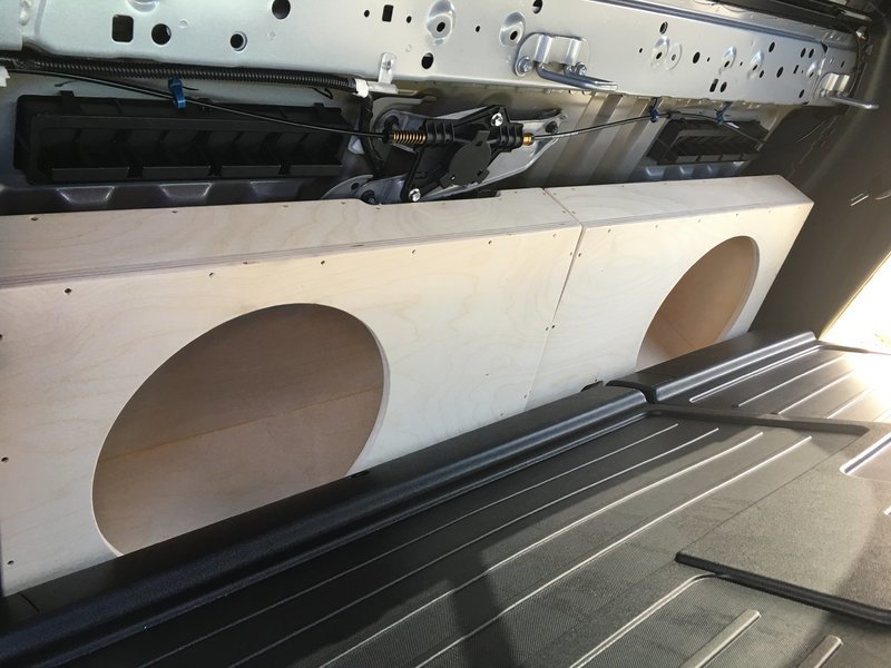

    Controlled with a helix dsp 2
  9. Jan 22, 2017 at 3:40 PM
    #49
    bc818
    bc818 Member
    Oct 10, 2016
    #199431
    15
    Bobby
    2017 silver trd sport
    And 2 12" tw3 for bass

    Where did you get this sub boxes?!? I have a set of tw3's but haven't found a good place to get a quality box! Please do share!

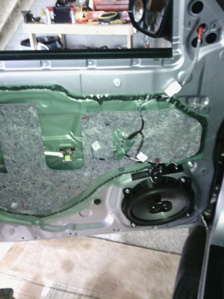

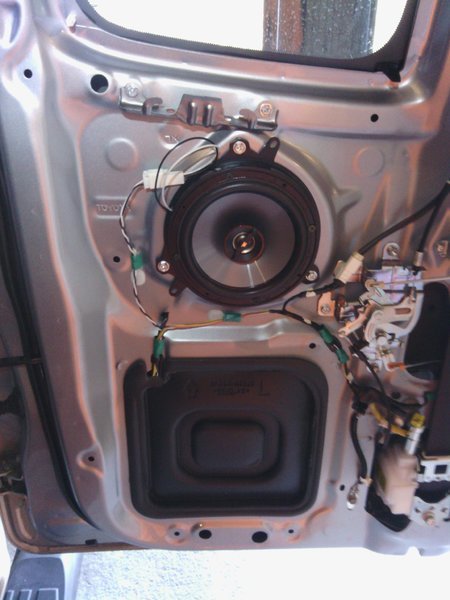

    Landon
    2017 Toyota Tacoma SR5 Double Cab
    I still have the stock head unit. Replaced my door speakers. Had to use mounting brackets. Links as follows:https://www.amazon.com/Metra-82-814...&qid=1485227357&sr=8-1&keywords=metra+82-8146
    and
    https://www.amazon.com/Metra-82-814...&qid=1485227357&sr=8-2&keywords=metra+82-8146
    Much better clarity in the mids and highs. Bass is a lot more clear also. Still rolls off around volume of 30. Soon I will be adding and amp and sub. I would say, yes, get new door speakers. I'm pleased with mine. Would purchase and install them again if I had to do it all over again.

    Contact mr. Marv. He custom built these for my setup/truck. He can build whatever you'd like. He is very knowledgeable and does amazing work
