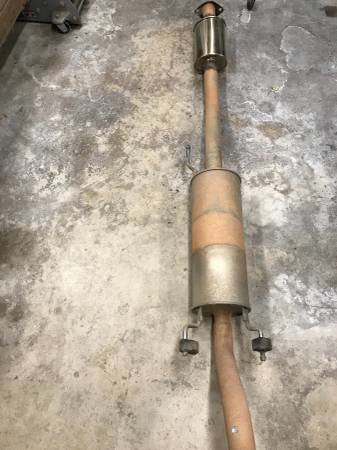

    Recently installed a factory TRD catback,
    and it seems a bit primitive, and with a drone. The system looks kind of simple, basic, and unrefined.
    Just piping and a big muffler.
    Is it worth welding in a resonator? I hear those can help with drone.
    Can't help but wonder if the Tacoma uses caveman cheap technology vs a BMW that will have way more of everything underneath; probably 2 resonators, x-pipe or h-pipe, 2 mufflers with vacuum actuated valves, and so on.
    A finely tuned music instrument. Whereas the TRD part seems more basic unfortunately.
    Would a resonator help with that?
    I just saw an ad for a TRD catback for sale, and guess what. The owner added a resonator. Vibrant 1141.
    Visible shiny at the top. The Tacoma underbody probably has enough room for one, and resonators aren't that big.

    You can buy a resonated exhaust tip. Might be simpler.

    4Runners come with a resonator from the factory. Maybe see if you can pick up a used one cheap and have it added to your setup.

    If you still have your factory headers and ypipe with cats, the id say theres no need for a resonator. I am running catless headers and ypipe and had an additional borla pro xs muffler added to it. When deleting cats, it gets much louder so that would be the main reason to add a res, unless you are unhappy with how loud the TRD catback is
