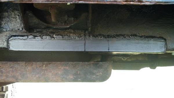

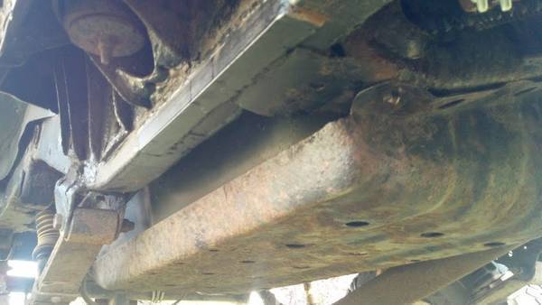

    Here is the weld mark. BEfore anyone comments, I have 11 other photos I took, so I will be posting them after this picture, I can't figure out how to post all the pics at once so bear with me.

    I don't know how much he ground down those welds but they look like complete shit...that was not a good weld job.
    After seeing those pics...my original opinions stands, it would be a fun toy, especially to SAS. But as for a reliable practical DD I would not feel safe driving it honestly, the whole front suspension looks like a rusted mess covered in grease/shitty paint. Have you driven it? Taken some turns in it? Is it tight? The engine bay looks pretty clean though which is a plus. And the whole rear end/leafs (minus the shocks) look decent.

    I wasn't able to drive it today, just get the pics. Also, when you say "ground down the welds", what exactly do you mean and what does that do to the integrity/strength of the steel and weld?

    Well sometimes you can grind down the bulbous welds to make them flat or flush, but it's not really necessary. It would not effect strength too much (unless you ground off the entire weld) as the strength is the melted bond between the 2 surfaces that have melted together to form one solid piece of metal. This is a good looking weld. It's continuous, consistent and has good over lap and coverage.
    This weld looks nothing like the weld on the frame. Notice how the welds look like they are flat and smooth? If it had not been ground down even if it was a shit weld it would still have bumps and round spots, but it looks flat as a piece of paper (except where there is no weld material of course) Another thought just came to mind; what exactly were they trying to fix with that little piece of metal? If it was a hairline crack you wouldn't need a whole long narrow strip like that. I'm curious what was wrong. I'm thinking maybe a rust patch that was out of control?? Not sure at all on that one.
    I mean when you compare the two it's disgusting how they let that weld on the frame pass like that. I don't really even see a continuous bead on the top except for the 2 edges. I would make it a priority to drive it and get a good feel of that front suspension. The frame welds can always be ground all the way down, cleaned and re welded by a friend with a mig welder that has some idea what they are doing.

    I mean when you compare the two it's disgusting how they let that weld on the frame pass like that. I don't really even see a continuous bead on the top except for the 2 edges.[/QUOTE]
    So in your opinion, no go?

    Agreed.
    Looks like some of my earliest welds with a cheapie Clarke 95E 110v stick welder.

    So in your opinion, no go?[/QUOTE]
    It's still a tough one...but after seeing the pictures usually one section of the truck reflects on the rest of the vehicle. So if the whole front end looks like it's been dipped in the ocean and left to sit for 7 years, and some redneck with some aviators as a welding mask garage welded that frame with a gas less Lincon Electric I would guess that the rest of the vehicle, both parts seen and unseen are in rough shape and you will be spending more money fixing stuff than you will be modding and playing with it. I would go find a gem that's more money but in better condition. Unless you test drive it and something else convinces you based on some X factor you see in it once you take it for a test run.
