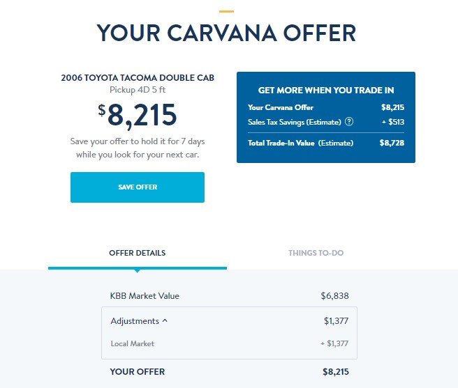

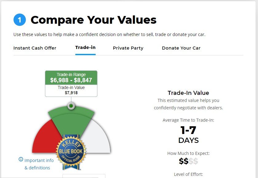

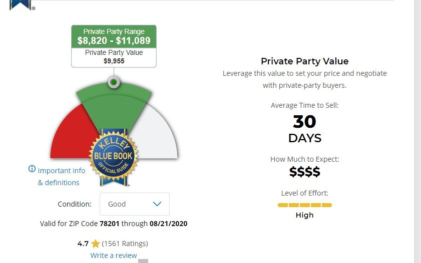

    KBB and NADA results can be off the make sometimes on Tacomas. Just like the the Carvana thread. My truck is a 06 DCSB 4x4 TRD sport and KBB has my truck in $8800 - $11000 private party and less on trade in. NADA has it being $8800 - $10700 trade in. Universal Toyota had my truck at $10400 trade but they didn't have what I wanted. Probably for the best. Carvana was $8200. Although my truck isn't stock but that might be a minus on those numbers.

    I totally agree with you. And that was my point -- the numbers can be off and we all know that. However, $13,500 appears to be way off and too high for a car with unknown gremlins that you will have to pay a fair mount to diagnose and repair properly. Could be straightforward -- or it could be a nightmare. For that price I don't want the risk.
