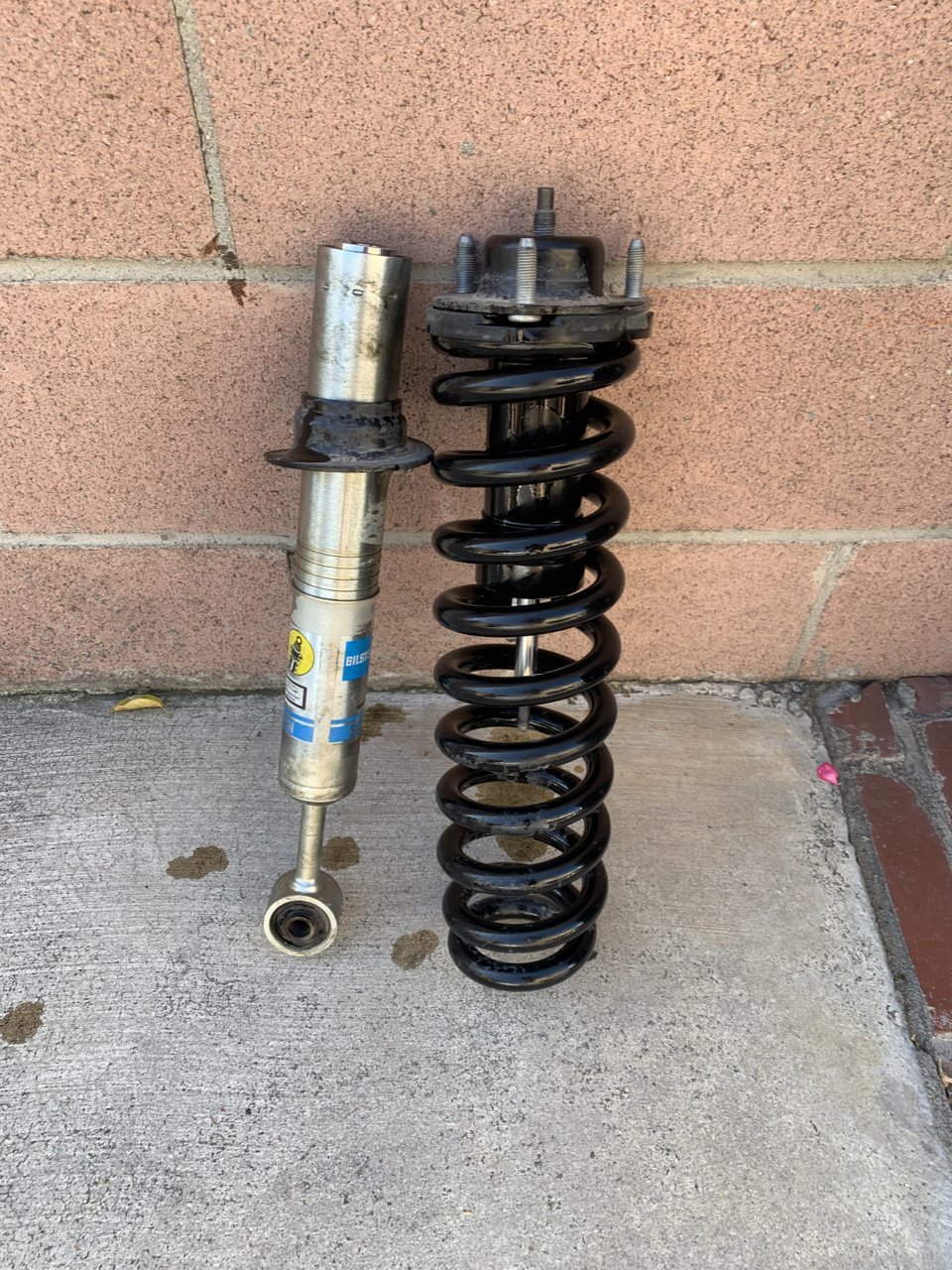

    Yup.
    if you’re actually wheeling the truck you will definitely blow a set of bilsteins. To my understanding they’re all built the same so 6110s might last a tad longer than my 5100s but I still think they would’ve exploded.
