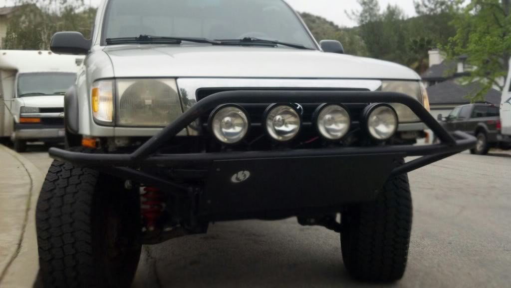

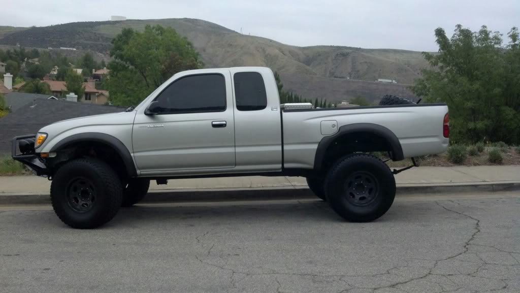

    Hey guys, this is my first post here, coming from the world of offroad VW's.
    I have a guy who wants to trade his 2000 Tacoma for my Baja Bug, which I have listed at $7500. I don't know a lot about Tacoma's so I was hoping you guys may be able to help me out on what you think this truck would be worth.
    Here's all the info he gave me:
    2000 Tacoma 3.4 TRD Supercharged
    157k miles
    Prerunner bumper front and rear
    Four 4" offroad lights in front
    HID headlights

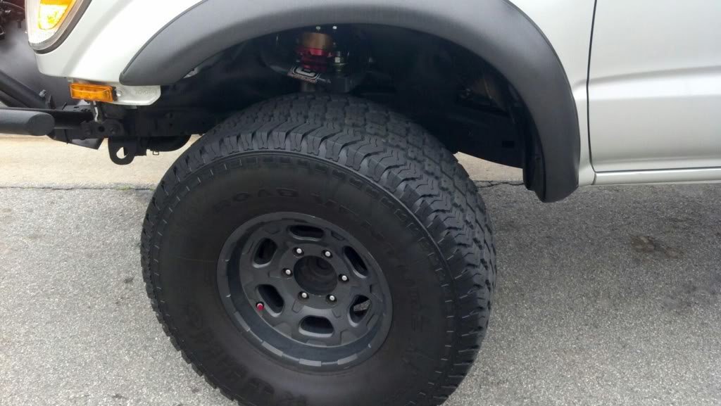

    Camburg Mid-Travel kit w/ SAW RaceRunner coilovers
    Shackle lift in back with adjustable shocks
    33x12.5R15 Rims and tires
    Full size spare on rear bumper
    10" sub
    Automatic trans
    Now I'm new to Tacoma's, but I am not new to cars or offroading, so I have my fair share of concerns.
    First off, the exhaust is still stock, which worries me because I've heard stories of people destroying systems and catalytic converters because the stock exhaust can't handle the supercharger.
    Also, he told me he only has the upper arms on the mid-travel kit, and that the truck has about 9" of travel in the front. Am I going to be able to take whoops at a decent speed with this setup? I know that sounds like a naive way to phrase the question, I guess I'm curious if this is a decent setup or if you need the lower arms for the full benefit. Right now I just pin it through the rough stuff in my bug and it bounces right over. Don't want to give that up.

    The CAT concern is not true.
    I don't see a rear pre-runner bumper, only a tire carrier.
    I'd be a little skeptical about 9" of travel. I wouldn't take whoops at decent speeds with that set-up. You need a good LT not a mid travel.

    That truck looks very clean. You should post up a few pics of your bug so we can make a comparison. But just from the info I obtained, it may be worth the trade depending on what you are wanting to do with it. that truck looks to be a 2WD...is that correct? I would prefer a 4wd... but maybe that's just me.

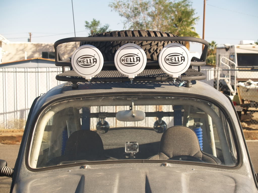

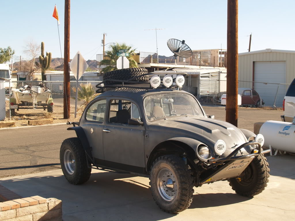

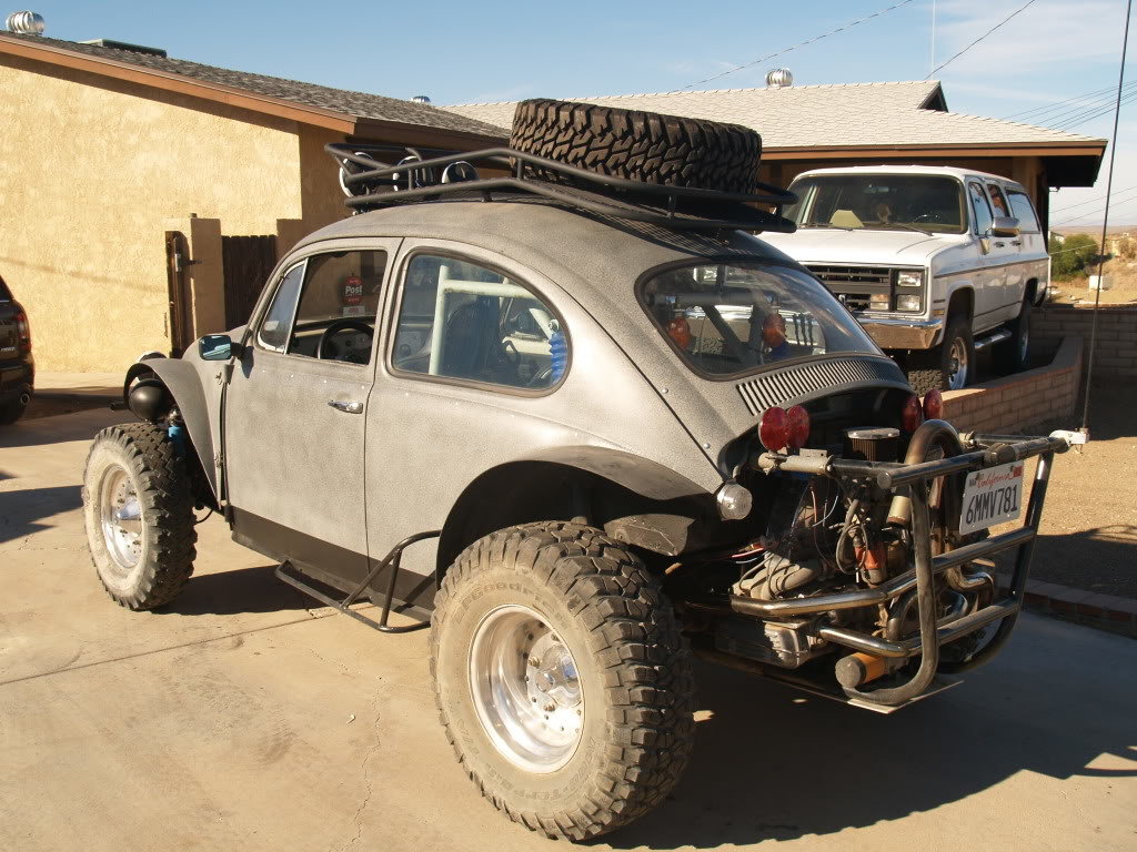

    It is a 2WD. Here's a couple pics of the bug

    That bug is freakin awesome.

    I think it's two skinnier tires in front and two bfg's in the rear.

    Correct me if I'm wrong but it looks like there is a spacer onto of the C/O

    I'm seeing what everyone else is. No rear bumper,it's a 2WD and I'm not sure about it being considered a mid travel ( I'm not very knowledgeable about lifts,but in my short time here I've learned enough to know that spacers will lift but not supply travel ). I'd keep the bug,especially if you're not really into the supercharger.

    It's got coil overs and UCAs but it looks like there is a spacer stacked on top of the coil overs to me.

    Good eye, I didn't notice those spacers at all! I have spacers on my trailblazer, not looking to get another truck with spacers. Really stiffens the ride. Lots of good points, looks like I may be holding onto the bug for a bit longer.
