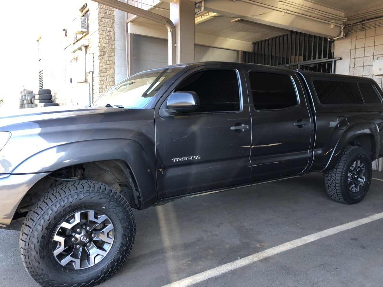

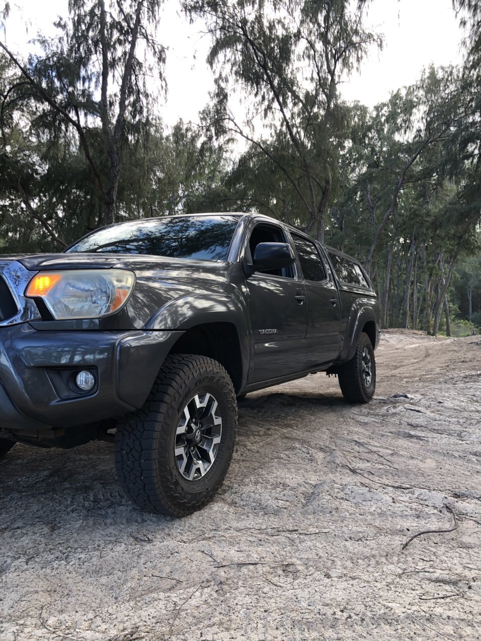

    I bought my truck 2012 double cab 4x4 at 90k miles. It’s an AZ truck but it was shipped to HI so no rust. the couple that was selling it were going through some tough times and just wanted what they owed on the truck, 19k. came with a shell and some 5100s fairly new as well.
    some minor tree scuffs and the hood and roof are fading. Seats had seat covers on it her whole life.
    I added some 3rd gen off-road wheels a 1.5 in toytech lift in the rear. I flushed all fluids when I first got it. Did the brakes replaced the needle bearing. I plan on swapping suspension components as I near 120k but as of right now she’s tight as a tiger. She was really babied her whole life first owner was an older gentleman second was a older couple and now me who takes her through Hawaii mud and sand every weekend:)
