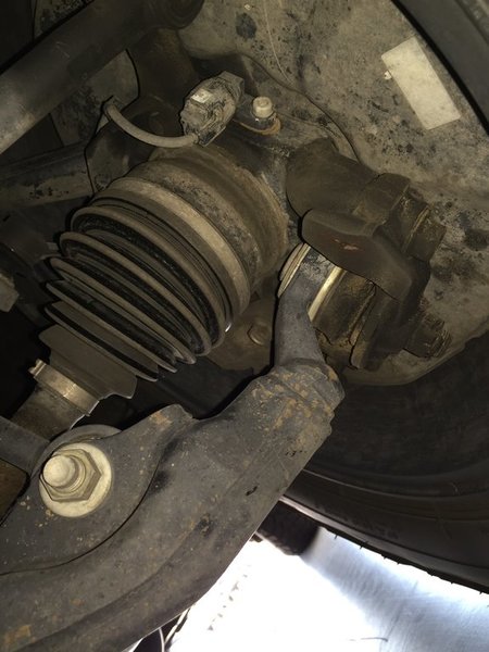

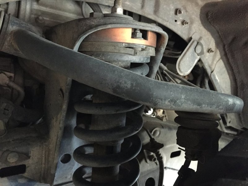

    110k+ miles on these OEM parts and it has been through glamis several times plus the occasional desert excursion.

    Is that a 1 inch spacer giving you 2 inches of lift?

    It's been in there for years, but I think that's what it was.

    Where did you get that ball joint spacer?

    I have a 2" lvl The ride is not stiffer. It's actually exactly the same as stock. Assuming that you are using a leveling kit above the strut top plate, not a spacer in between the coil spring and the top plate.
    I'm 4X4. No vibes.

    That was like 9 years ago and I think I bought it used on a 4Runner forum.
