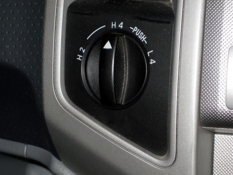

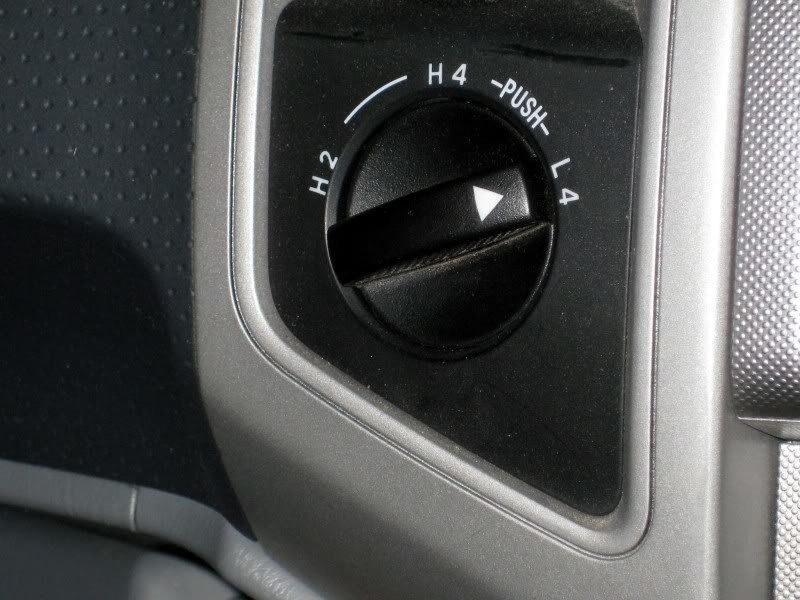

    Your Truck ID says only SR5... are you also an Off Road TRD (all Off Roads are SR5s, but but not all SR5s are Off Roads)?

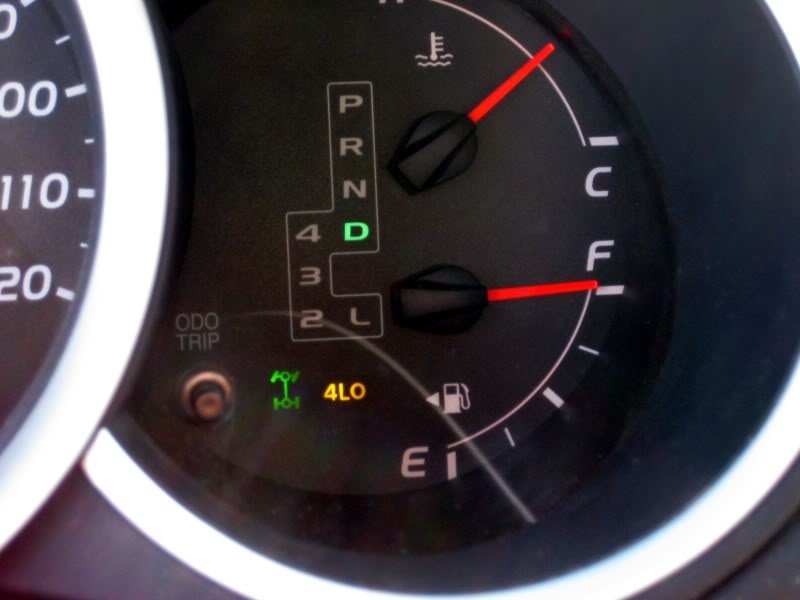

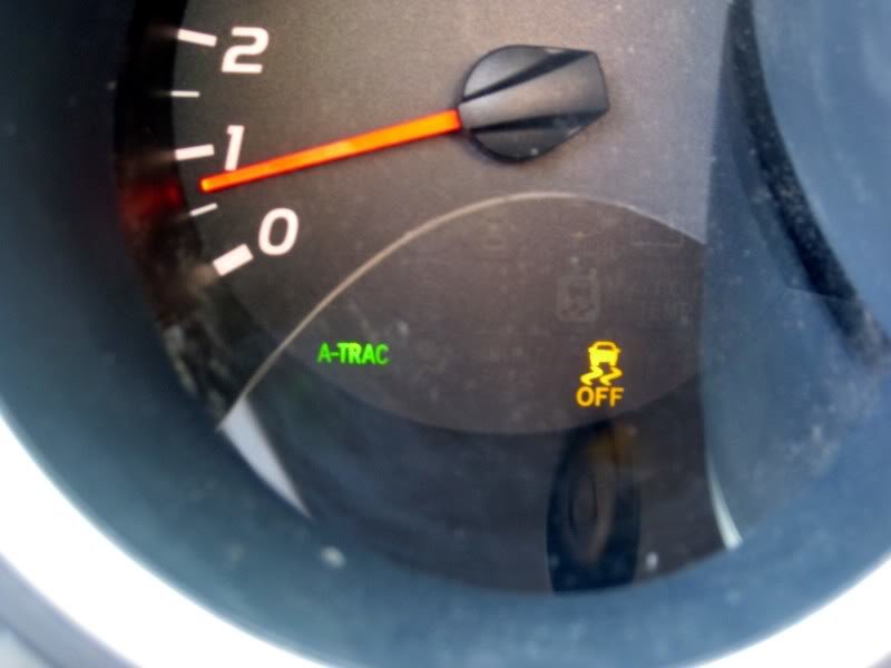

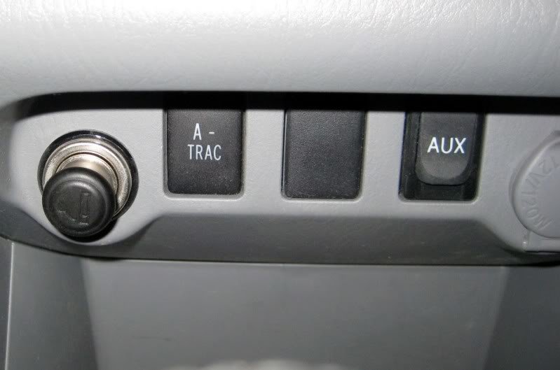

    The A-TRAC works only in L4 on 2009+ Off Road 4WD Tacomas, once the A-TRAC button is pushed. A-TRAC is a crawler drive that is the closest to having front and rear lockers engaged that you can have from the factory.
    TRAC is the automatic limited slip that works in H2 and H4 whenever one of the drive tires loses traction... it doesn't need anything to activate. You can prevent it from coming on if you desire wheel spin by holding down the VSC OFF switch a few seconds, while STOPPED.

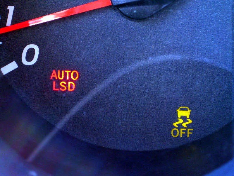

    AUTO LSD is an enhanced limited slip in H2 (only), and is activated by a quick push of the VSC OFF switch (moving or stopped)... use to get unstuck in 2WD (4WD is a better way to keep from getting stuck).
    If you are still unsure about if your questions have to do with A-TRAC (L4) or TRAC & AUTO LSD... just ask!
  7. Aug 22, 2011 at 7:54 PM
    David K
    David K Well-Known Member
    Jun 27, 2009
    #18969
    11,348
    San Marcos, Alta California
    2010 4WD Off Road DC
    Differential Breather Mod Light Bar: 4 Cree LED lamps Bilstein 5100s Ride Rite Air Bags
    PART 2)
    2WD:
    Push the VSC OFF button quickly for AUTO LSD (TRAC without any engine output regulation/ brakes only) for best 2WD traction.
    IF you don't want any traction help, hold down the VSC OFF button until this light comes on:
    4WD HIGH:
    TRAC without regulation is on with H4. Hold down VSC button for a few seconds while stopped to turn off TRAC.
    4WD LOW:
    L4 is open differential only (no traction control), unless you have an OFF ROAD TRD!
    Last Resort... if A-TRAC is unable to get you through (this I've got to see), then you have the rear locking differential!
    The Off Road TRD 4WD... purely unstoppable, from the factory!:D
