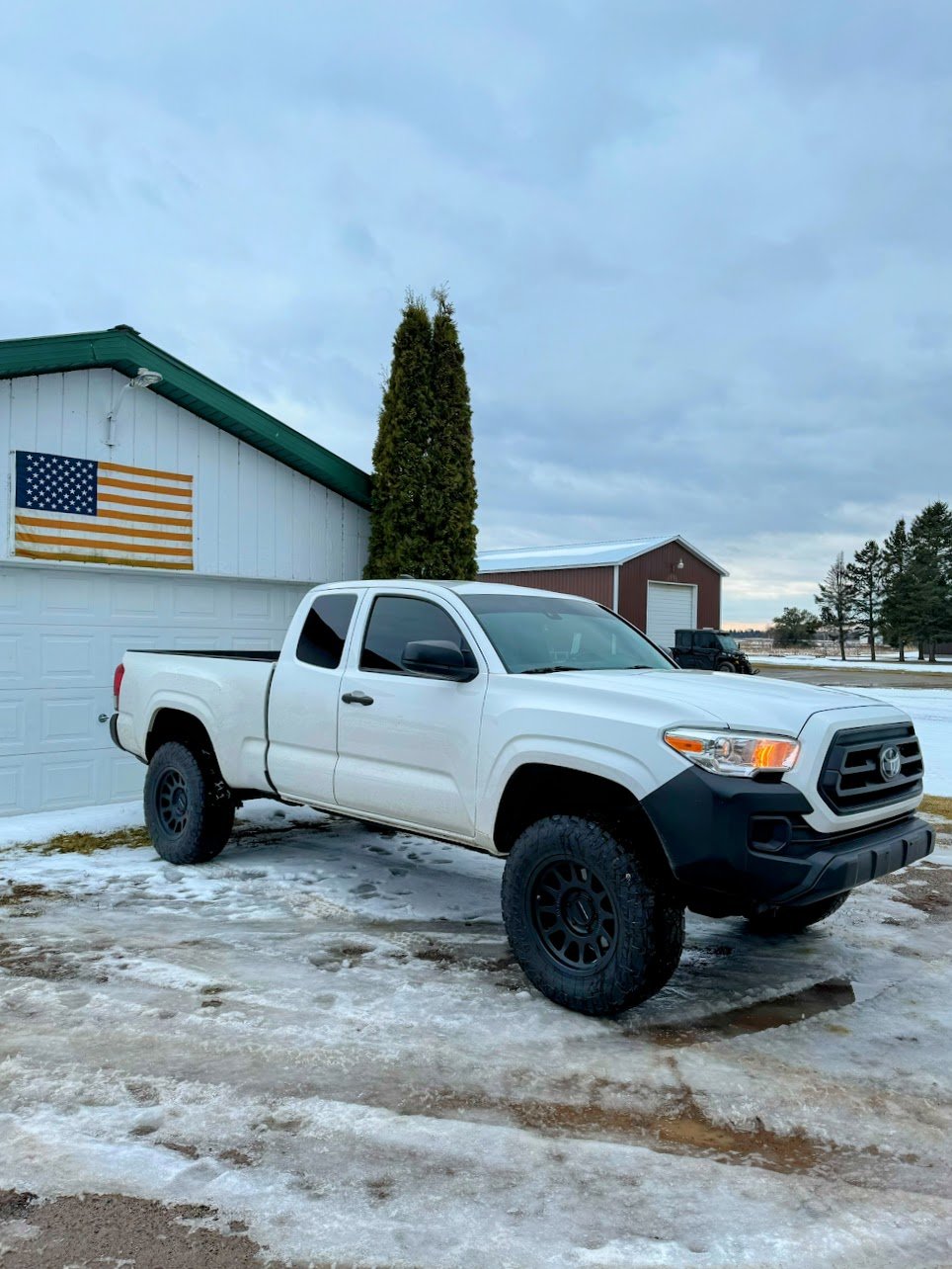

    No needle bearing required, no diff drop required. :) just don't ask me to pull you outta a ditch. LOL
    I also run E load Toyo AT3's on a 2.7L Tacoma with no problems. 2/1 lift. Simple and cheap, gave me the look I wanted and rides same as stock. Lift set me back a whopping $160 with alignment!
    baboltin[QUOTED][OP] likes this.

    Looks good man !
    barch88[QUOTED] likes this.

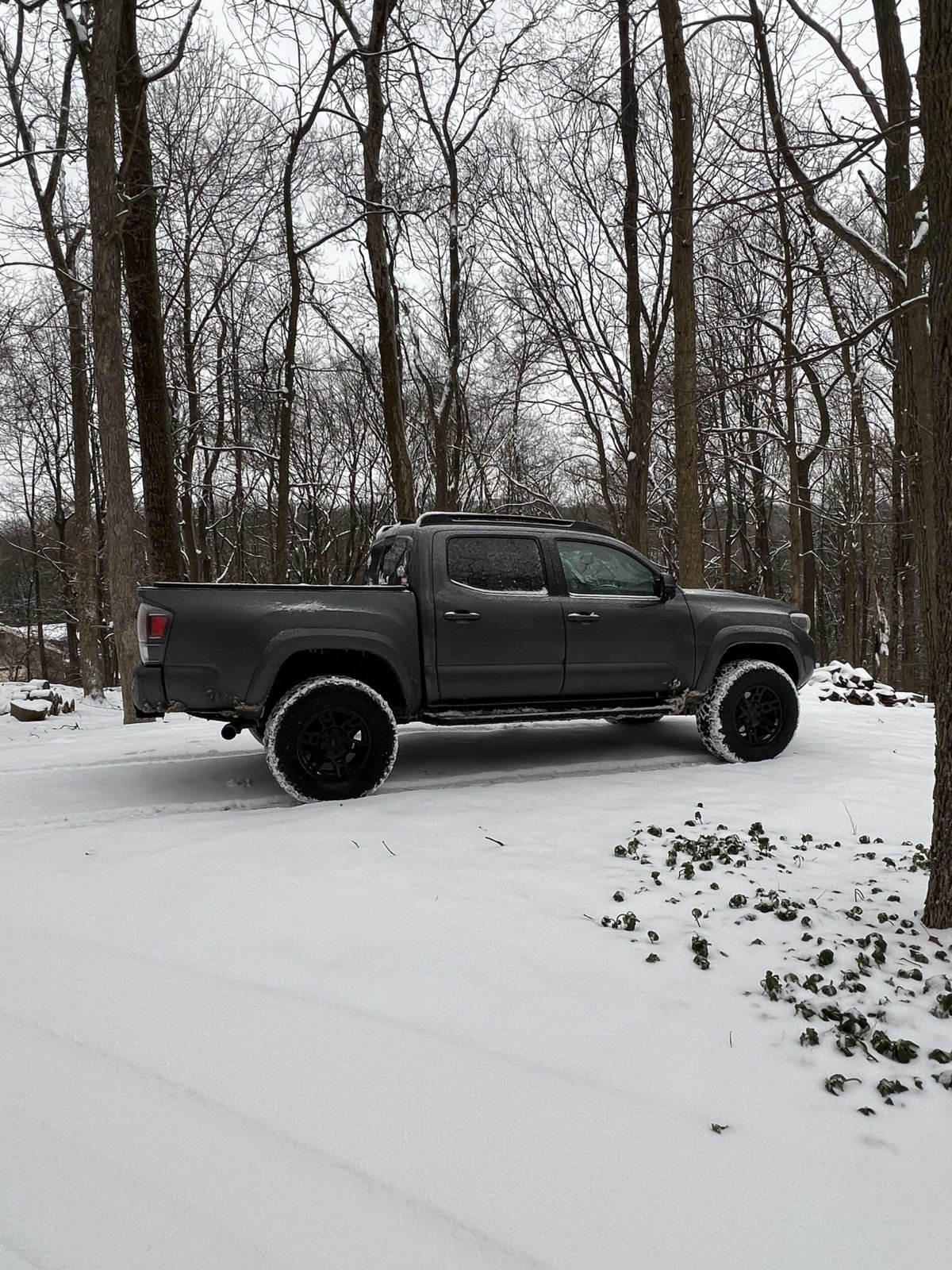

    2"/1" and 285/75/16 on 0 offset wheels
    Junkhead and baboltin[OP] like this.
