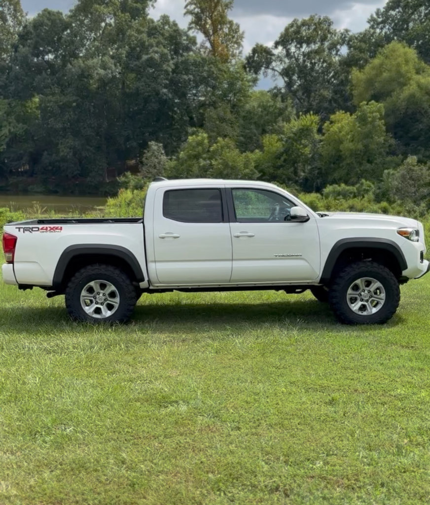

    I have bought a 3.5 inch strut off Amazon and I bought it slightly used. I put it on and it seems as if it maybe shorter than 3.5 inch lift than other peoples leading me to believe it might be 3 or 2 inch strut and that my truck would lean more on a 3.5. I have nothing in the back btw.

    It looks higher in the front than the back, but that could be due to a number of factors. Too many variables to form an educated conclusion.

    Like was suggested, measure your fender lip-to-wheelhub distance. Stock is 21" front, 22" rear.
    By the way that thing looks, you're probably not real far from 3.5".

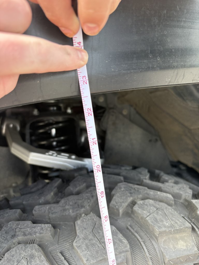

    I measured and it measured out to 22.5 so what would that mean was I given a wrong strut or is that my supposed to be right.

    RC is crap for lift heights they combine the 3.5" claim for both the 2nd and 3rd gens but the 3rd gens sit 1" taller to start. They also don't hold their lift height very well and tend to sag over time. Invest in quality the 1st time around.

    You have less than 2 " lift.

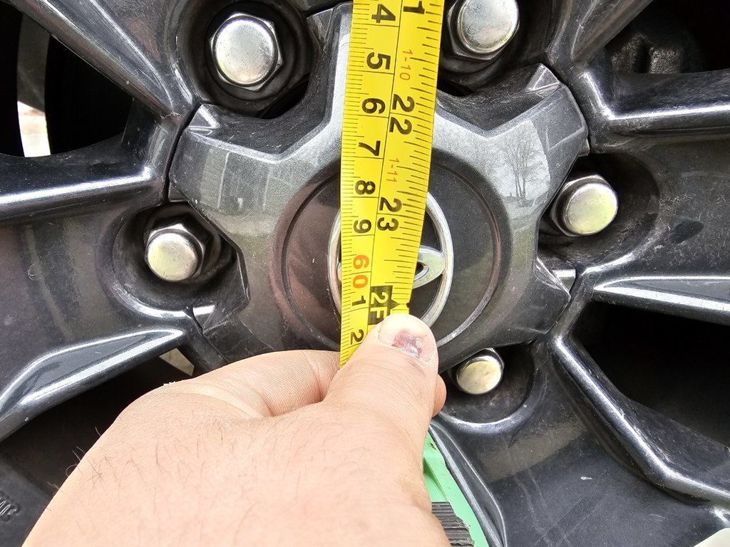

    you only get 3.5" lift on a 2nd gen truck. also the hub to fender heights truck to truck doesnt seem to mean much. heres mine with 4" lift

    For what it’s worth, here are my measurements with king coil-overs and OME Dakar medium leaf springs.
    FL 22.25
    FR 22.5
    RL 23
    RR 23.5

    Pretty close to my 885 coils w/aal on 0 setting
    Dude got robbed
