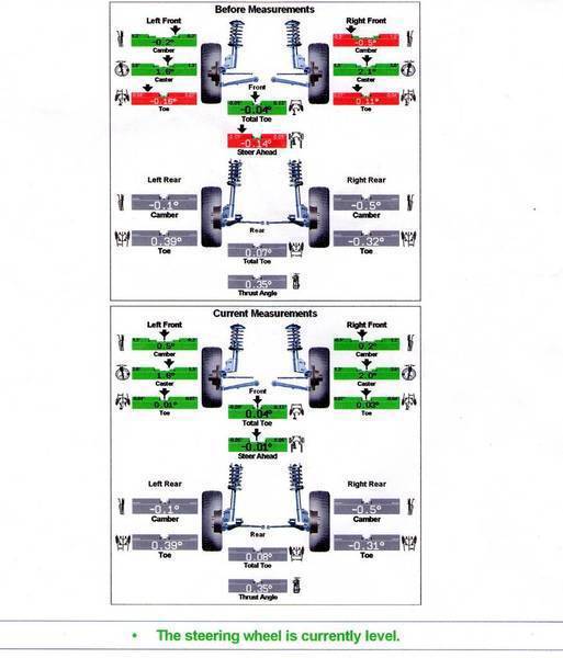

    Hello TW! I just had my truck aligned today because i got new wheels and tires. I also had them take out a readylift leveling kit before the alignment because my truck didnt handle very good. I thought it was because of low caster due to the front being lifted 2.25"? But after the alignment the truck still drives the same way?(wanders) So i want yalls opinions on whether or not my alignment #'s are good for a stock trd off road. It looks like the tech.(a 28 year toyota veteran) didn't even adjust the caster. I asked him about it and he said it was within spec.? He also said that the caster is maxed out? I'm a little frustrated and could use some advise. Here is my alignment sheet. Thanks

    left front Camber should be at the most .2*, and you should have more caster. If you lifted, you will need new UCA's to get it in spec.

    Thanks fella's, but I'm not lifted and the tech. Is tellin me my caster is maxed out? This shops machine shows .5 camber to be perfect?

    .5* Camber is "In spec", but it would be better to be closer to 0*. If your not lifted, Caster should fall in line. Good chance the tech doesnt know what hes doing....

    ^he said he's been a Toyota tech. For 28 years?

    What is the caster suppose to be on a stock truck?(trd off road)

    Should be about 2.3*
