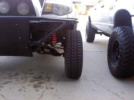

    so i messed my alignment up on the gorman run, i have to drive to palm desert tommaro so i decided to get my alignment today, these are the numbers i got
    left
    camber -0.7
    caster 2.8
    toe 0.05
    right
    camber -1.7
    caster 2.6
    toe 0.05
    seems like the camber is really low :( , what should i do? i just dont wanna fry my brand new tires

    my last alignment i had them at like .2* they said the castor and camber are maxed out....i need to replace my tie rods, the have like no grease in them.

    it drives good haha, but i hate that damn feeling when im turning into or out of a driveway...feels like the wheels are shaking

    haha yeah! it def looks like my tire is pointed in.

    the shaking has nothing to do with alignment. and camber doesnt cause the tire to wear rapidly camber causes the tire to wear unevenly. toe being out of spec will cause the tire wear rapidly. but with that camber split your truck should be pulling left. camber pulls to the most positive side when your camber split is more then .5
    but all in all to answer your question your good man dont worry about your tires wearing out just keep rotating them

    i bought the firestone lifetime alignment, so im gonna replace the tie rods and have them re do it. it drove straight, but i didnt pay to much attension

    if it drives straight i honestly wouldnt worry about it just keep rotating your tires with every oil change..
