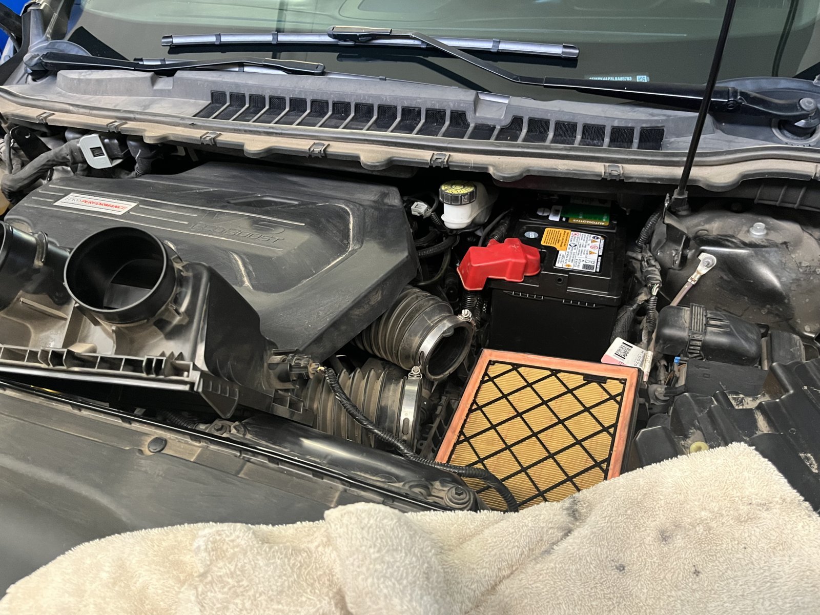

    Yep, the batteries last 2 maybe 3 years out here in the desert. My wife's 2020 Edge ST, I just replaced. That thing has the AGM, 48lb, frigging almost have to get a cherry picker to get the thing out. Have to remove the airbox cover and turn the battery up on its end. I was thinking acid is gonna pour out of the thing. Anyways, I won't complain about changing out the Tacoma battery anymore, that's for damn sure.

    On the wife's 2020 Ford the battery went into survival mode. She was telling me that she couldn't start her car with her phone. I wasn't concerned. Next she was saying that she couldn't unlock all 5 doors with her remote. I wasn't concerned. Then she was saying her heated steering wheel wasn't working. I wasn't concerned. Finally she says "I got a low battery notice for my car on my phone." Ah Ha! I had no idea that the AGM batteries on the new gizmo vehicles do this. Anyways, replace the battery and now she has all of her fancy things working on her Ford. I don't know if the new Tacomas will be like that but just something to maybe be on the look out for. FYI
