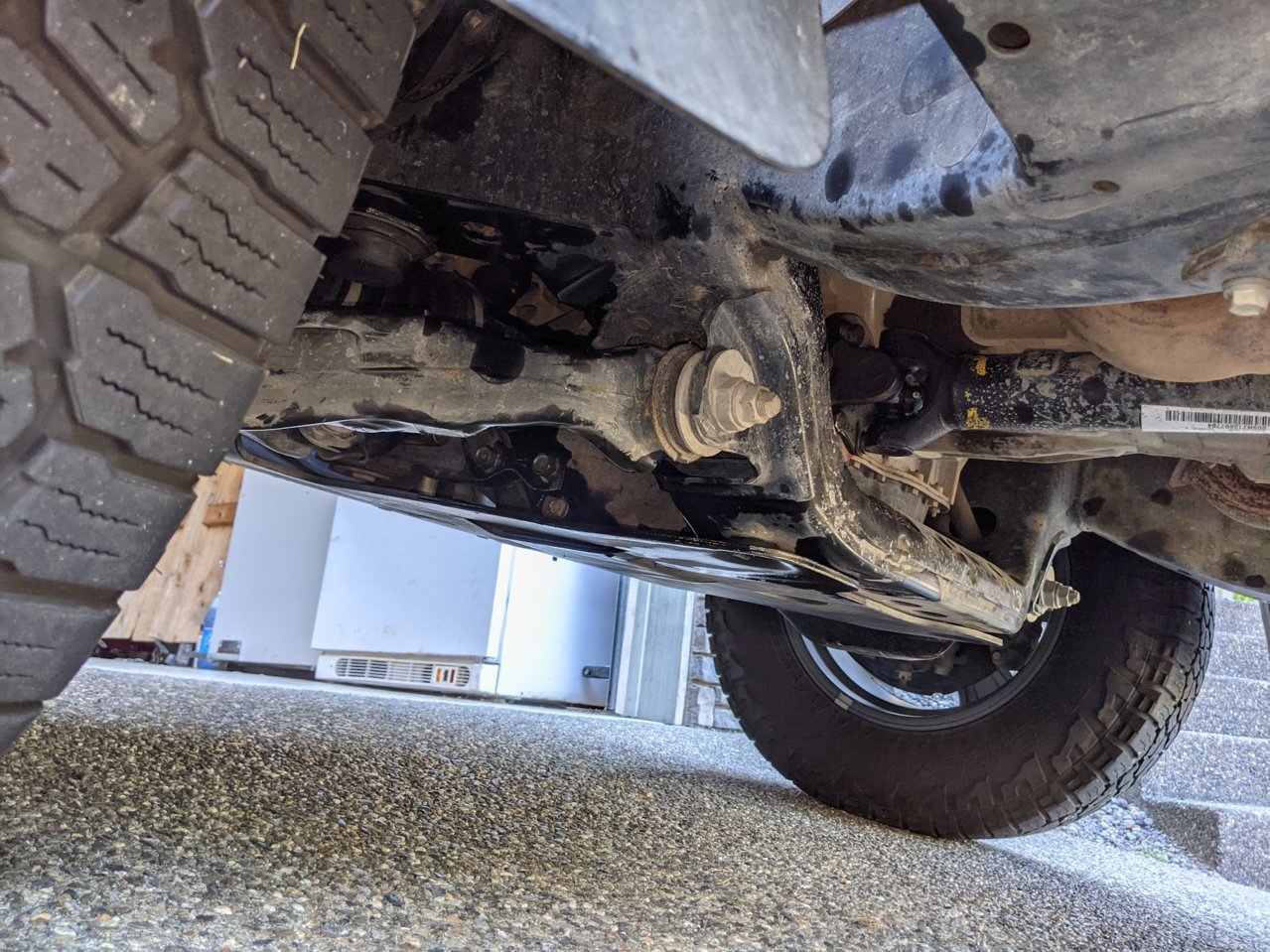

    I found a pic that I took when mine was leaking:
    disel_V1[QUOTED][OP] likes this.

  18. Nov 8, 2022 at 5:53 PM
    #18
    disel_V1
    disel_V1 [OP] I eat cold pizza rolls
    May 10, 2021
    #365327
    495
    3rd Gen
    few things here and there.
    Small update.
    Def leaking… dropped the skid plate, cleaned it up, put the plate back on, drove it around for about 20 then parked it.
    Dropped the skid again a few hours later and there’s a good amount of fluid on the plate.
    I just dropped it off at the shop that did the service.
    It wasn’t clear exactly where it was leaking, but it def wasn’t leaking prior to the bushing swap.
    I wonder if I’ve done any damage since it’s started a few days ago? I surly hope not..
