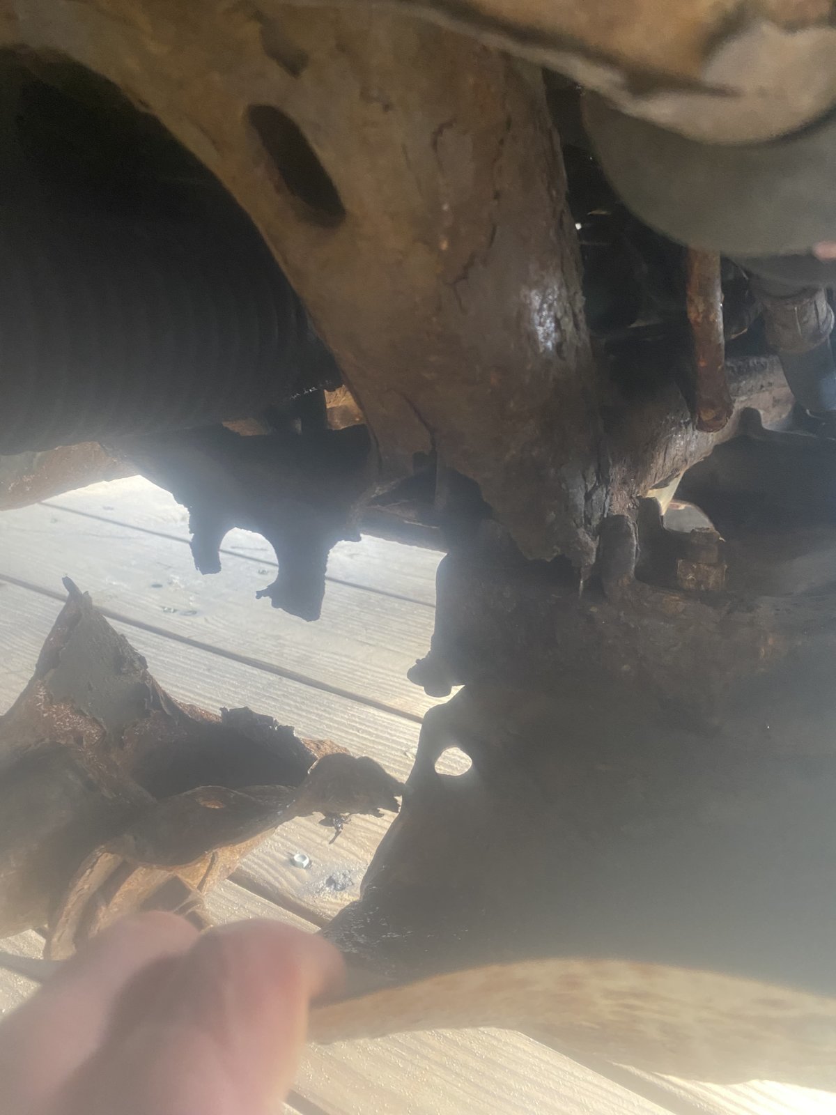

    2005 Tacoma sport
  3. Apr 19, 2024 at 5:25 PM
    #23
    AJwisco
    AJwisco Well-Known Member
    Mar 28, 2024
    #446819
    74
    2005 Tacoma sport
    This was mine, finally broke

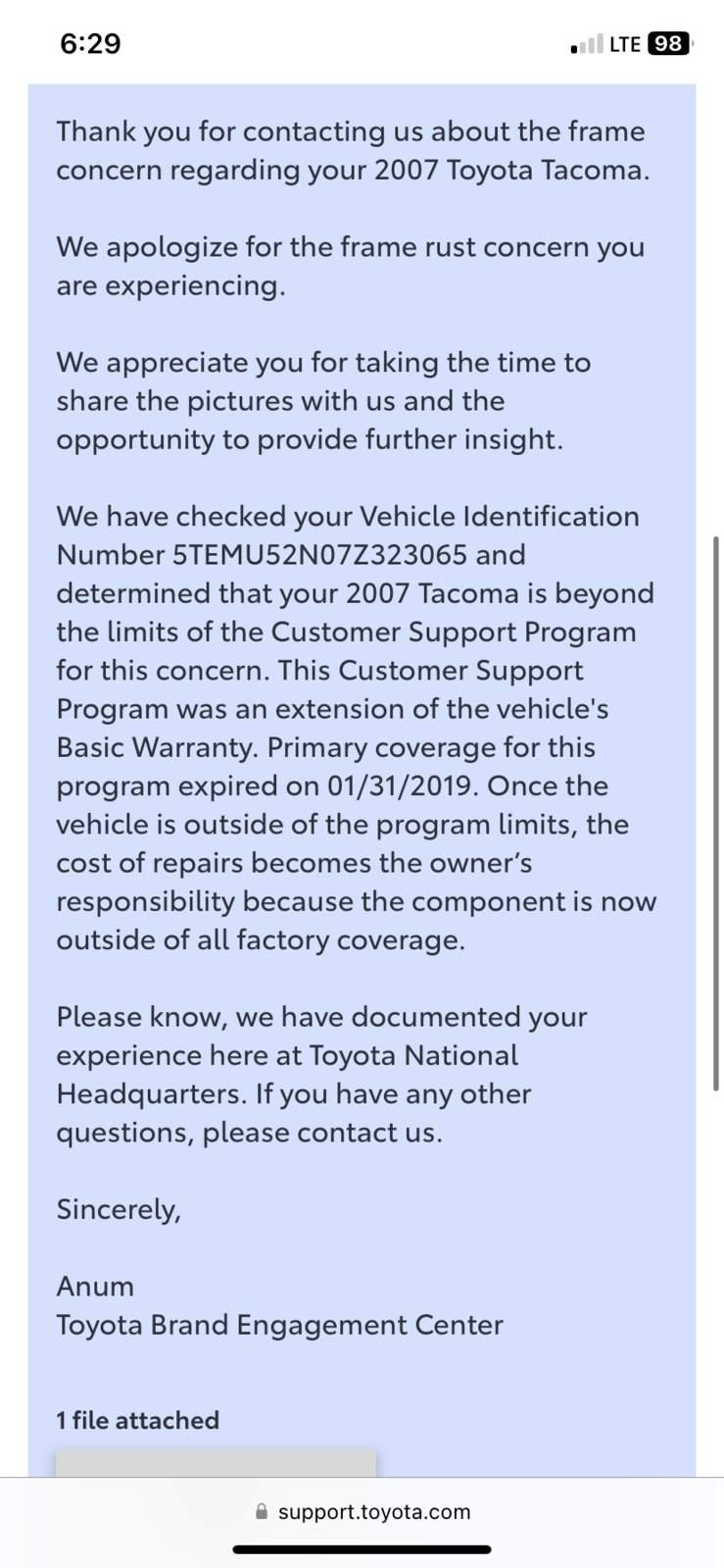

    Nope. You're well past the window of getting a new frame and Toyota will not do anything. If your tech has only seen one like this, he's obviously not from the rust belt. Sorry.

  8. Apr 20, 2024 at 4:31 AM
    #28
    AJwisco
    Mar 28, 2024
    #446819
    74
    2005 Tacoma sport
    You’ll get a letter like this☝️
    2009Access4x4[OP] likes this.

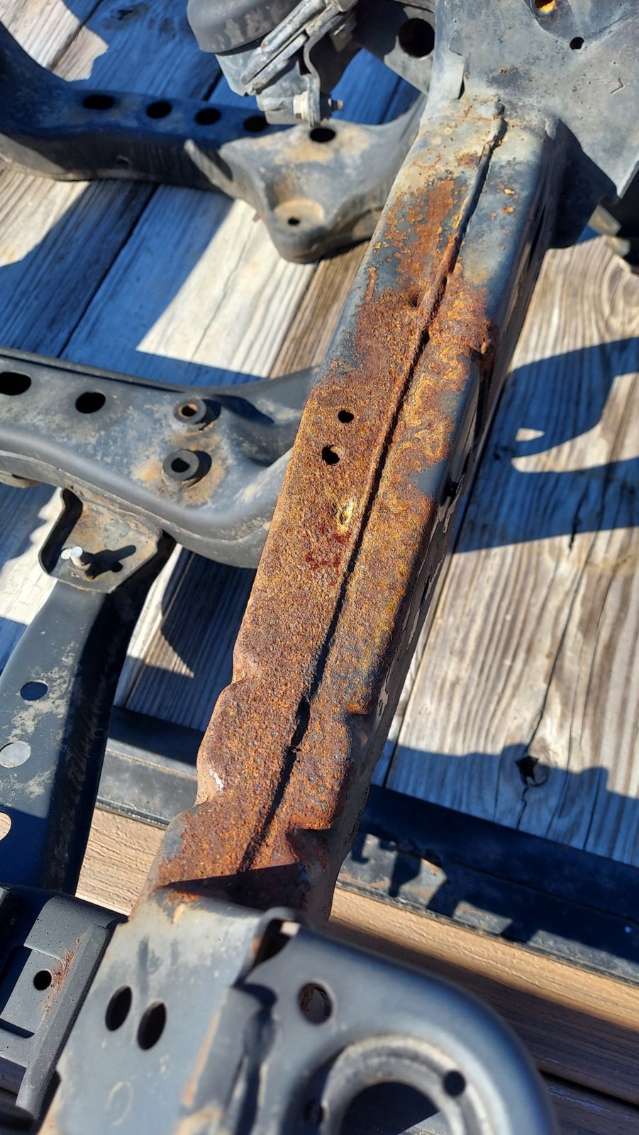

    That is one seriously neglected frame that has lived in salt or brine world.
    Rest assured there is more rust elsewhere you just haven't found.
    Toyota will do nothing now, you are well past the 12 years since 1st use date.
    A clean southern frame if you have skills, time, space and tools to DIY is an option.

    Josh
    Illinois
    2010 ACLB OR
    Your best option is a southern frame I found this one in Mississippi a couple of weeks ago and I'm gonna be swapping the frame this winter after I do some welding on the new one, weld where the 2 pieces of C channel are riveted together completely shut and paint the frame with POR15 and then treat it with fluid film every fall. Only spot of rust on the new frame is on the driver side in front of the shock tower and it's just surface rust, but the rest of the frame damn near looks new
