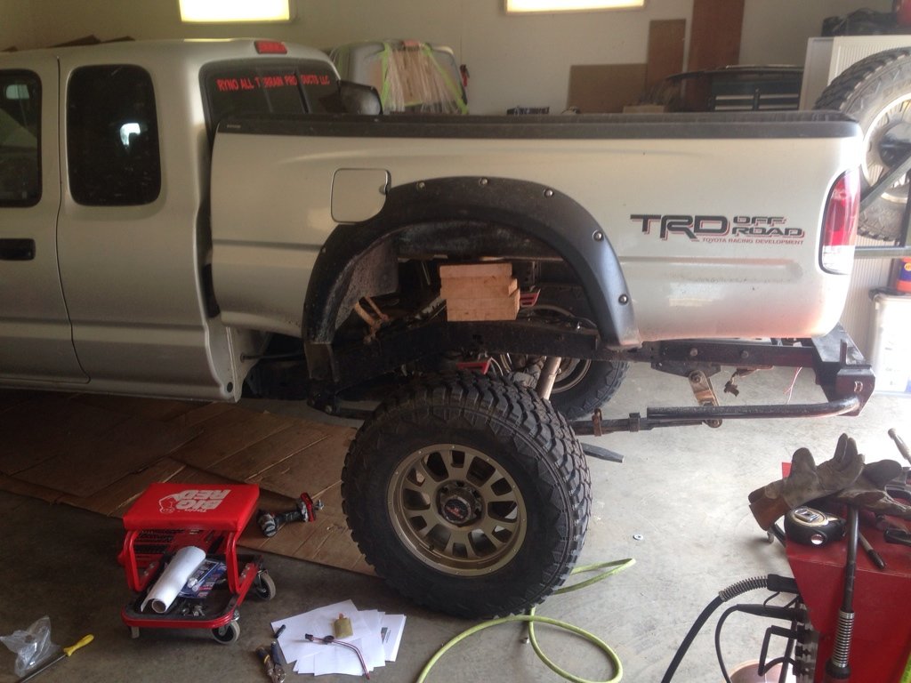

  16. Apr 29, 2014 at 10:15 AM
    #16
    RAT PRODUCTS
    RAT PRODUCTS Well-Known Member
    Apr 12, 2010
    #35140
    13,727
    Farmington, MN
    Cummins Coal Roller
    Smokin with a smarty.
    6 bolts hold the bed on. Then lift driver side up and stack some wood up and you have plenty of clearance. I just pulled my fuel pump last weekend. Very easy this way.

    Plenty of folks lift the bed and it will definitely save a little time. I have done it both ways.
    With this type of repair I prefer to drop the tank and get it up on the bench. If you have drained the fuel down to a gallon or two, it is pretty manageable and much lighter than one would think. This allows you to work on things like a gentleman and look inside the tank and clean any crap that may be sloshing around. This is also a good time to touch up external rust spots and inspect/clean/anti-seize all the associated hardware. Then there are all the rocks that collect between the skid and the tank, rubbing little holes in the tank.:eek: Additionally with the tank out, any rust issues on the frame next to the tank location can be dealt with easily.
    In the end, rust on the various fasteners may dictate which way you go.

    Wow I like the side lift of the bed, that is interesting. Yeah I am not sure about rust ect. I took the skid cover off from below the tank years ago, I know somewhat risky but I don't take it offroad really. Anyway, the tank looks to be in really good shape. I probably should drain the fuel out and go from there. Bad part is I JUST filled it up lol. I have a pump I can use I think.
    Guess I will drop it this week/weekend and go from there. I got under the truck and got a friend to try and start it and with my ear to the tank I heard absolutely nothing.
    ***ISU when you lifted the bed did you mess with the tail light or tag light wiring at all or did you just pull the 6 bolts?

    In 96 the tank didn't have quick disconnects. My truck does. It made things a lot easier. Getting those fitting loose might be a bitch. Use a line wrench.
    When I lifted the bed, I didn't mess with any wires. If I went any higher I would have needed to. There was plenty of room to wrench and get my cordless impact in there.
