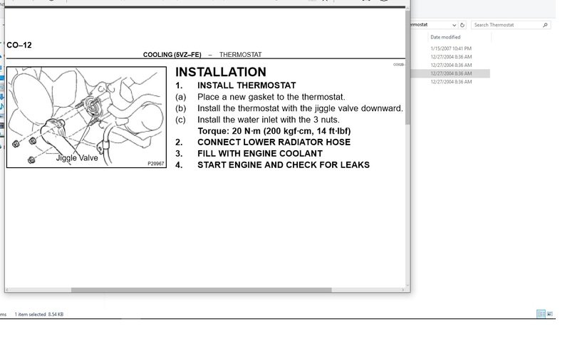

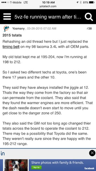

    2004 Black Tacoma Prerunner TRD V6
    Mine came 12 o'clock from factory...just saying :rolleyes:
