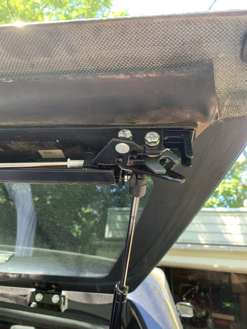

    Howdy all
    My cap came in tough shape. The latches were seized, linkage was bent, no key, etc.
    I replaced everything, but the passenger’s side latch linkage keeps popping out as shown
    It’s assembled the same way it came, was something done wrong that causes this?
    thanks

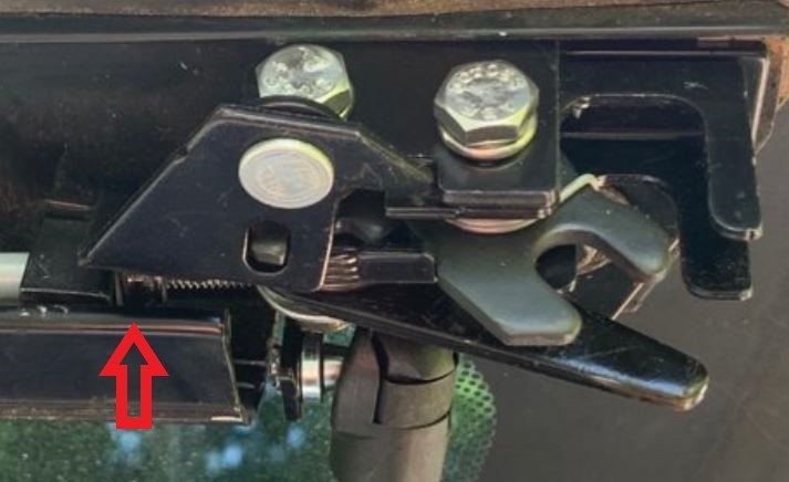

    For starters I would assume the plastic sleeve on the rod where it meets that housing on the latch mechanism (second photo) would make more sense on the other side of that sleeve
    doesn’t make the adjusting nut any easier to get at though

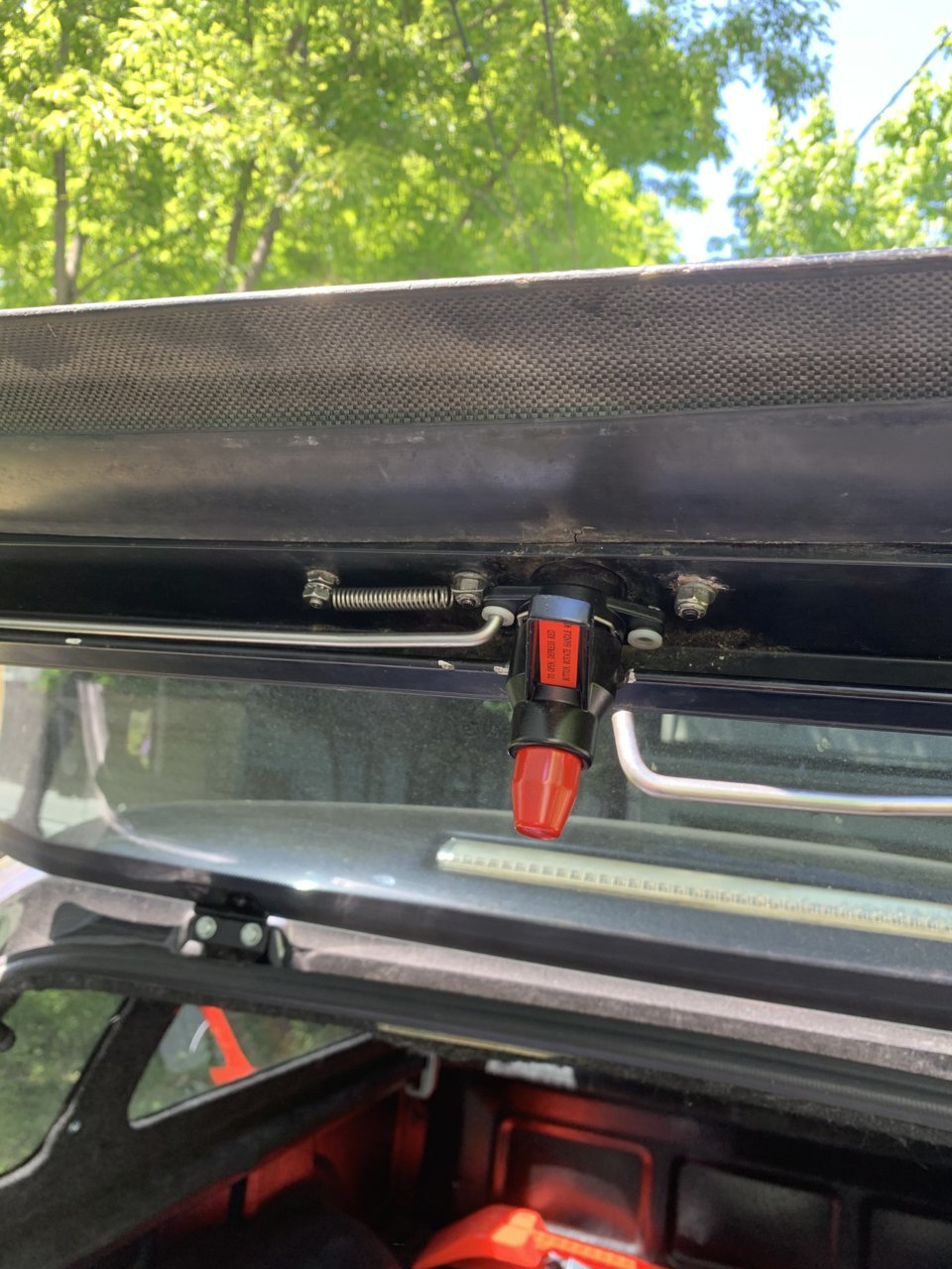

    It may just be the camera angle but the rod looks bent where it shouldn't be and not bent enough where it should be.
    The part that goes into the handle should be 90 degrees like the one on the left side of the picture and the rod should be straight along the run (like the left side). I would pull it out and correct that and if it still pops out them put a steel spring nut on the back of the rod where it goes through the nylon bushing. Ex. https://www.mcmaster.com/steel-spring-nuts/push-on-external-retaining-rings-6/

    must be the angle, the bars are new and comparable to the old ones it came with.

    I'm not sure what you're talking about and there are various styles out there depending on which manufacturer you went with (which model, which supplier they were using at the time or what they could get, etc). In the OP's picture, it looks like there is an adjustment nut (see red arrow). If you have a picture of yours showing what you are talking about maybe someone will have an idea that may be able to help you.
