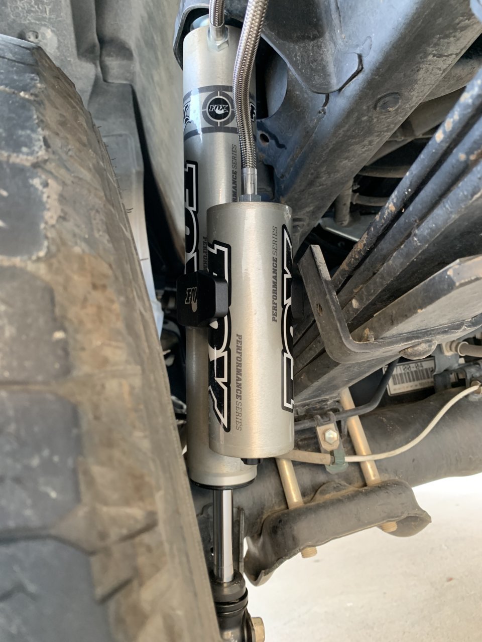

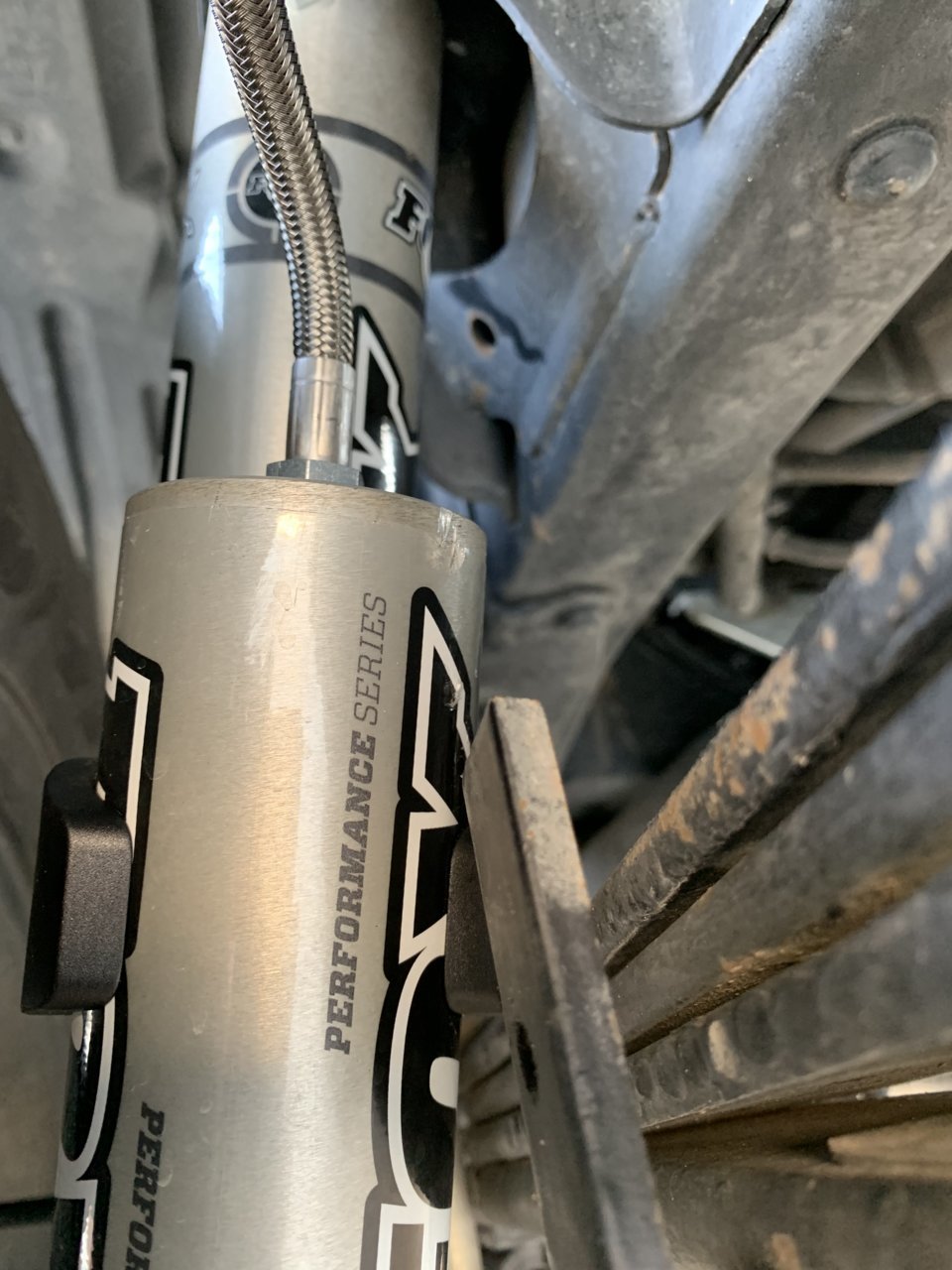

    I just got my lift installed this weekend and after driving home, I checked and noticed a small chip in the rear reservoir. I’m thinking it may have been from the leaf bracket but what do you guys think?
    Should I have the reservoir mounted flush with the bottom of the main shock?

    Just twist it an inch to clear the leaf pack bracket.

    That’s what I figured but just wanted to verify.
