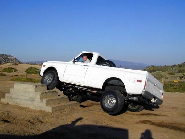

    Well a couple days ago I tired to drive my prerunner up these stairs, I could only go up the first block, when I tried to get to the second block the left rear tire just spun, then it would lift off the ground. The right rear tire didn't even move.
    These are the stairs

    Bloodhound
    Bloodhound Space For Rent
