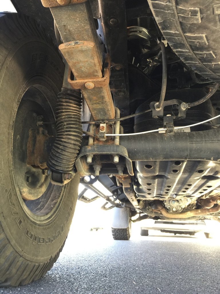

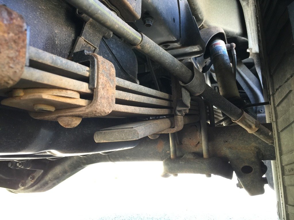

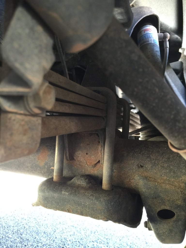

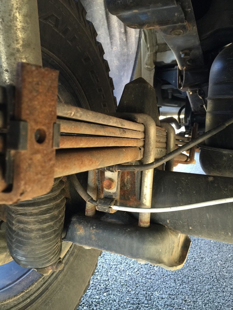

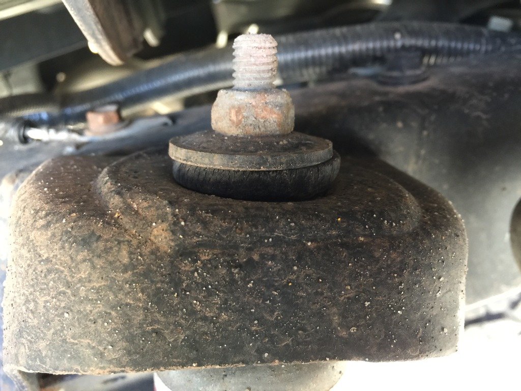

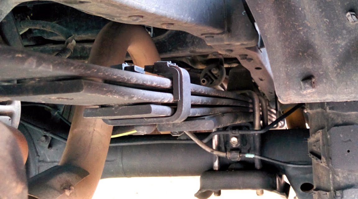

    Well a few weeks ago I started a thread in general about a washboard ride... I didn't check to see if there was a suspension forum lol... So here I am. Truck has 24800 on it, factory 2013 TX Baja suspension.

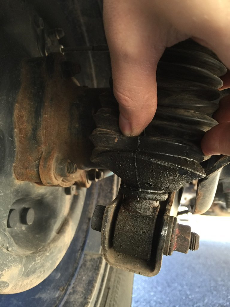

    A few weeks ago I started noticing a washboard ride and just a general decline in the ride quality of the rear of my truck. I feel like the bed is getting significantly more bounce then it use to, however when I jump on it the suspension seems to react opposite of what the photos suggest. When you jump on the left corner of the bed, it feels very stiff. When you jump on the right it feels much softer. My right rear spring looks like its shaped wierd and had some sort of flexing in front of the axle, other then that it looks flat. The shock looks fine and when I touched the boot a bit of sand trickled out. My left rear spring looks flat and not as twisted as the passenger side. However the bottom of the shock boot looks like its covered in oil. Also noticed the top grommet of the driver rear shock looks dry rotted.
    When i took it to Toyota a few months back they said it looked and felt fine. I dont know if all these changes are from then. I just purchased Wheeler's 3 Leaf AAL, but now Im considering selling them (havent installed yet) and installing some OME Dakar's and removing a leaf or 2 from them...
    What do these photos tell you guys? Shot springs and a blown shock? That's what Im seeing.

    Yes the springs seem like they are worn. The shock could be blown but who knows. I would look into a set of springs. Stock ones aren't designed like an off road spring.

    Have you carried a few heavy loads in the bed? Do you drive some crappy pavement to work every day? The rear leaf springs on the Tacoma are crapola. Take it in for warranty if you can. If not it's time to buy some good aftermarket leaf springs. Don't reinstall Toyota rear leafs if you are paying for them yourself.

    Yeah, definitely don't do an AAL on those negative arch leaf springs. When I said aftermarket leafs I meant buying entirely new suspension leafs from someone other than Toyota. Both All-pro and OME carrying a few different leaf springs that are MUCH better than the stock leafs. If Toyota does give you new leafs for free than putting a progressive AAL will help with holding a load, but totally new aftermarket leafs would still be better.
    When the leafs has negative arch like yours they lose that nice springy feeling. That's what has happened to your suspension.

    Leaf springs looks normal to me, I don't think shocks should leak fluid though--so yeah, shock is damaged IMO.
    Toyota springs are designed to ride flat and go negative. That's just how they are. Here are mine:

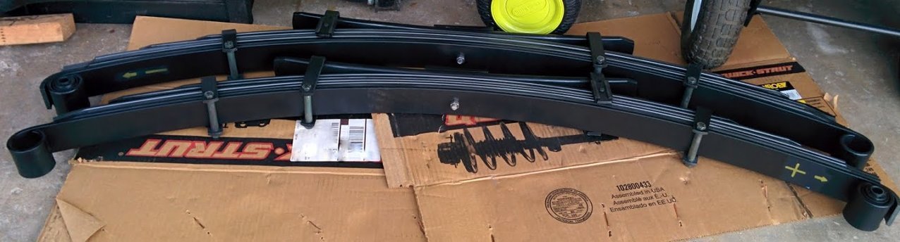

    Mine are 6-years old and I'm replacing them with OME Dakars for $400 and change, plus I bought the extra leaf.
    Here are my new prefurbished Dakars waiting to go on. I took out the extra overload and put in a D29XL AAL.

    Well took the truck in today and Toyota says the rear springs are in spec and they saw no evidence of a faulty rear shock, and that some oil on the shock boot should be expected after 25k miles. Im like ok, then fix the other one that doesn't have any oil.
    Looks like Im going to have to call Toyota about the shock.

    Well Toyota says my drivers rear strut is blown and they're ordering me a new one.
