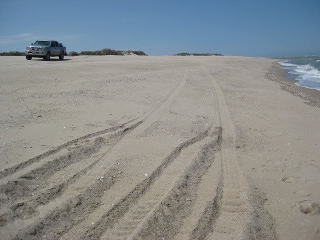

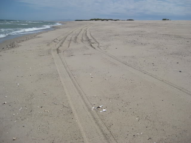

    Limited slip systems will also improve the sand experience... as a spinning tire only DIGS you in deeper... If you stop moving forward (in sand) and gas it, you will only spin yourself DOWN. STOP and let MORE air out... remove any built up sand in front of the tires, and try again to move ahead. Repeat if necessary... There is a point where the amount of air removed will get you going, in sand.
    See the difference between 32 PSI and 15 PSI...

    great pics showing the difference, wondering if anyone has ever taken and picture to show the non believers, thanks
