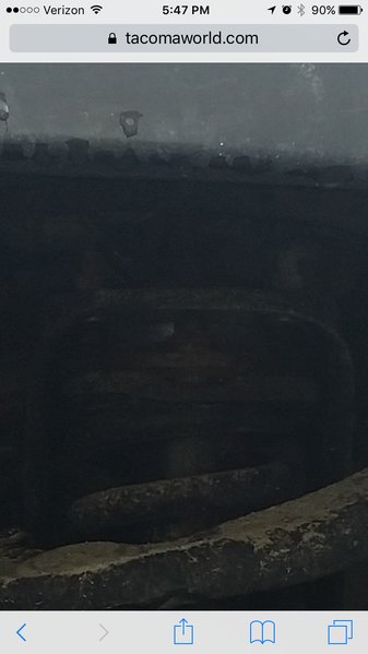

    Hello neighbours
    I have recently purchased a 2012 Tacoma Base and I read in some of the dealer documentation that it had an aftermarket lift. I can't tell if it does or not. Can anyone tell me if is is a lift kit, springs and coilovers or if it is just stock? Thanks in advance.

    What type of shocks does it have...looks like Bilsteins, but its hard to tell from the photos.

    Looks to be leveled. Rear looks stock. Probably has spacers.

    The shocks on the rear do say Bilstein on them, but they also say Toyota on the same shock, so I am thinking maybe stock?

    Stock
    Looks like you have a front spacer, and possibly rear blocks by the looks of your leaf springs...they look a little flat.

    1.75" Billy's plus 1/4 spacer on both sides. 1" block in rear. 265/70/17 nitto g2 SCS matte dark bronze 6s
    Second pics shows a front spacer lift.

    Excellent, thanks for the help. I guess I will have to put proper lift on my list of things to do.
