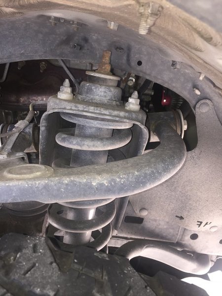

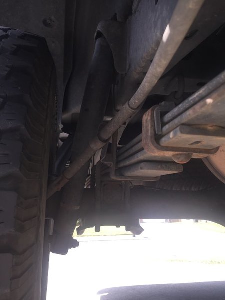

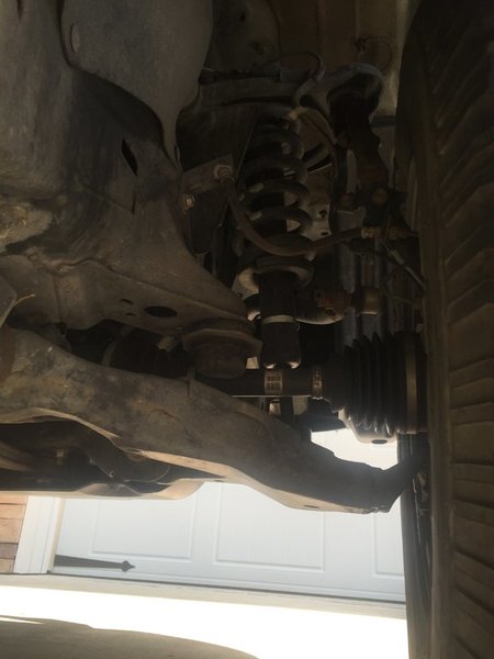

    Hello! I can already tell that I'm going to enjoy being a part of this community. I picked up this 2010 DCSB a while back and it seems to be slightly higher than some others that I've parked next to and with limited research, the tires (265/70/17) appear to be larger than can run on the stock suspension. So I'm sure something has been done to it but I'm unsure if it's a leveling kit or something else. Can you tell from these pictures? Any info appreciated.IMG_0125.jpgIMG_0127.jpgIMG_0128.jpg

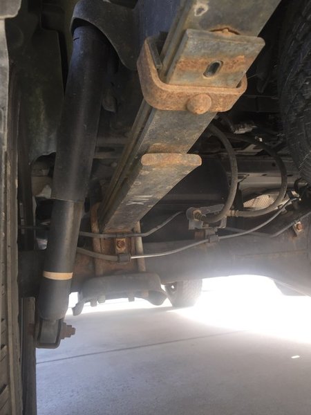

    First off, welcome! Pretty sure you can run 265/70/17 on stock suspension, but snag a picture of the front shocks and springs and then the rear leafs.

    Your tires are actually the biggest size you CAN run with stock suspension and no rubbing. If your truck is lifted, it's by no more than an inch judging by your pictures. If you look at the coilovers themselves they'll have some telltale signs of a lift. We need to know just a couple things.
    A) what brand are they?
    B) is there any sort of spacer between the top of the shock and the top mount?
    C) are there any spacers aside from the required washers in the spring assembly?
    If the front shocks are unmarked (black) you have the stock tokicos and they are not adjustable. If this is the case and you said no to b and c, then your front end ain't lifted. I would put money on someone leaving the rear stock if the front is as well. Lots of gus only mod front ends to level the truck. Hope that helps.

  5. Sep 19, 2015 at 11:26 AM
    T4RFTMFW
    T4RFTMFW Well-Known Member
    Jul 23, 2014
    #134525
    69,757
    Looks all stock to me. Nice truck.

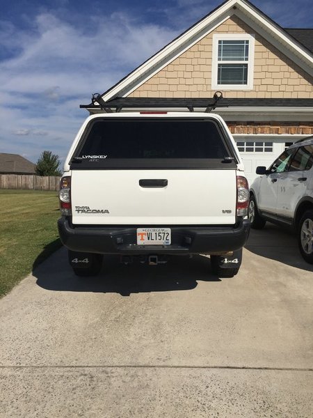

    This might sound odd, but can you post a pic of the truck from the rear? I have a similar truck setup and have wondered if the black bumper makes the ass end look a little.. dark, with the big ass shell window right there.
    Not an angled pic, but maybe about 10 or 15 feet away and squared up with the rear end?

    Yup, all stock. Stay away from spacers, dude!

  11. Sep 19, 2015 at 1:31 PM
