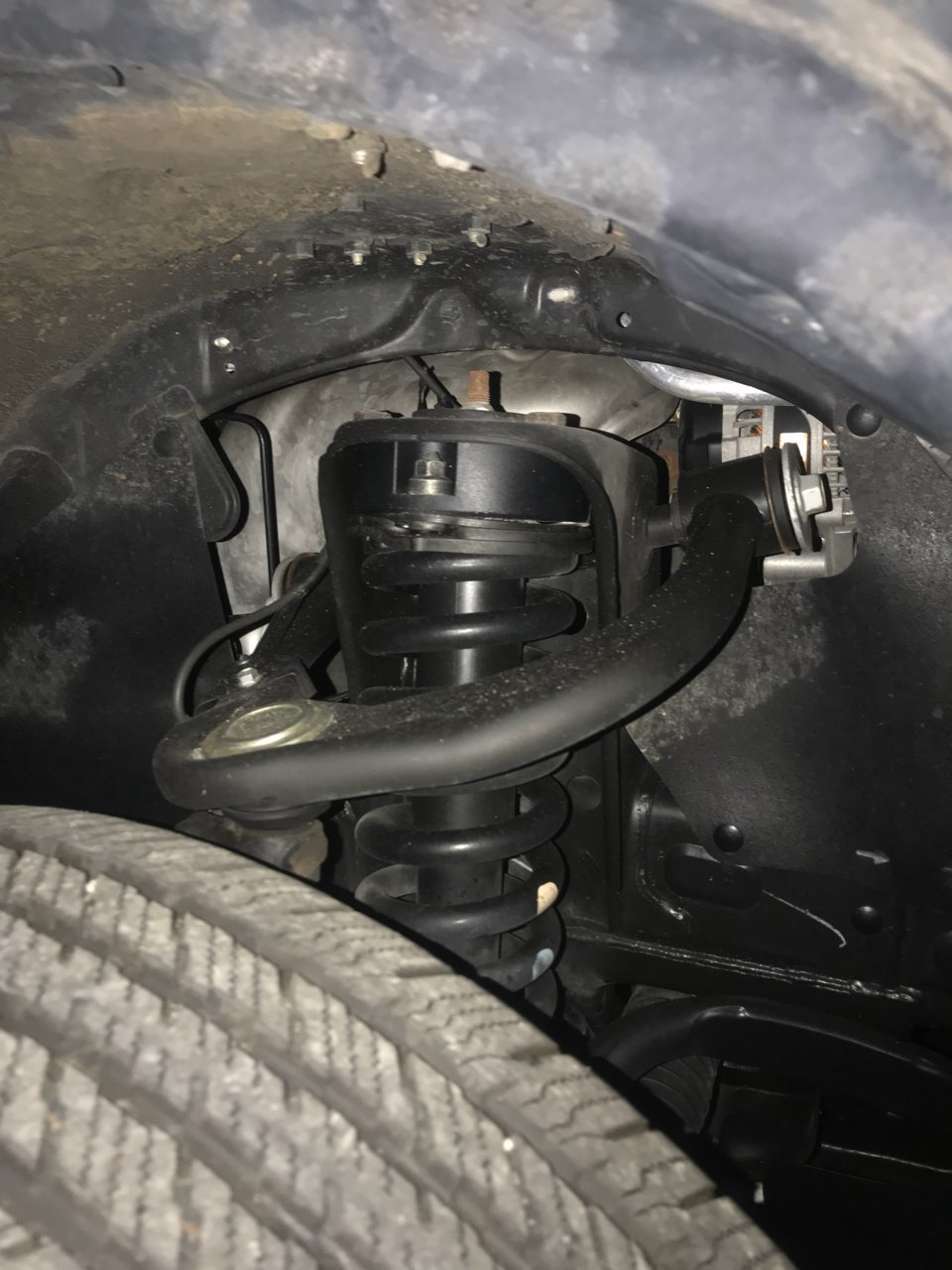

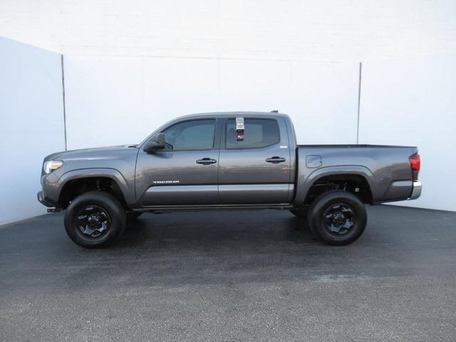

    I purchased a pre-owned 2019 Tacoma from the dealer and they said they think there is a lift on it but couldn’t give me any details on lift height.
    So can anyone confirm there is a lift and if so how would I determine the lift height?

    That’s definitely not stock height

    Yes, get pictures of the leafs, UCAs and struts to find out more

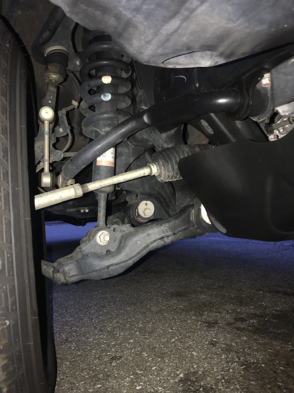

    Take pics of front coils and rear leafs. Maybe they can be identified.

    Not from this side. Can you take another picture from the other side?

    Looks Like a 3” lift

    Maybe theyre really tiny tires, hard to tell from that shot

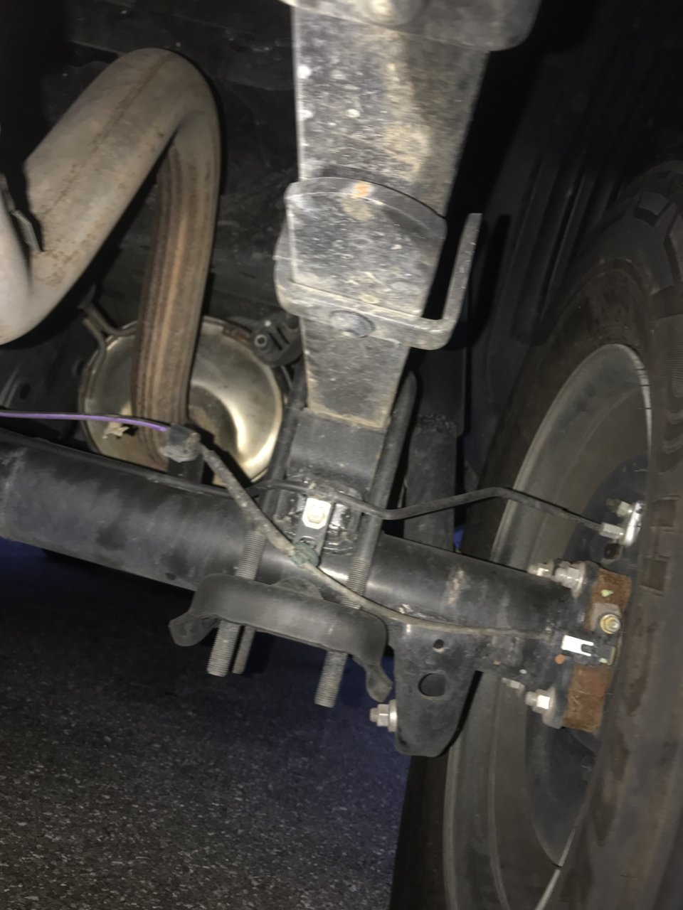

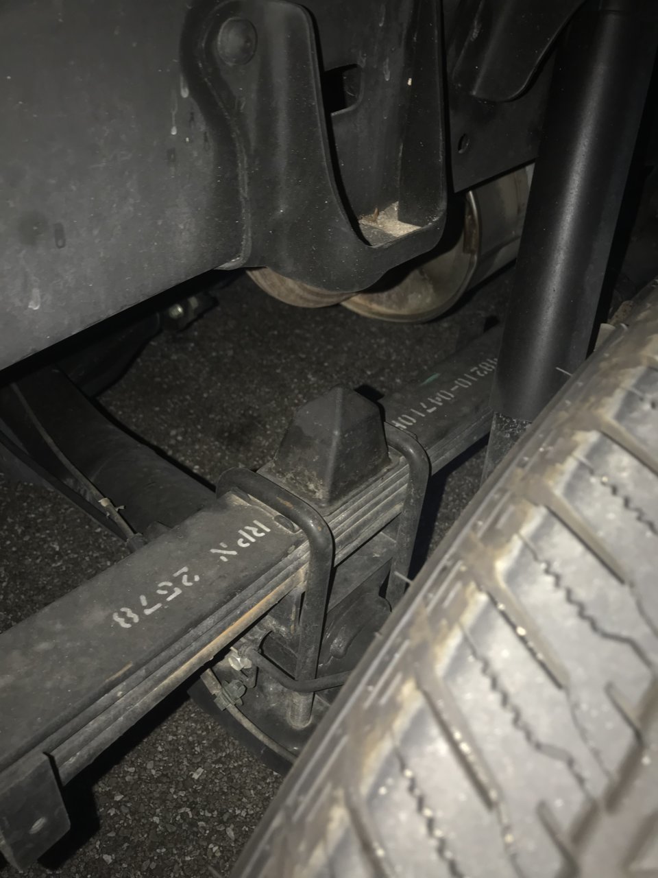

    Looks lifted, but like all the other members are saying, you will want to take photos of the leaf springs in the rear and shocks/struts in the front. Take photos of the mounting points for your front shocks and struts (some times people put spacers at these points) as well as where your leaf spring pass over/under the rear axle (flipping the springs or adding blocks also creates lift). Finally, take pics of the manufacturing stickers and logos on the front shock and struts and the rear leafs so we can see who made them and if the parts are designed to lift your rig.

    Its lifted, but for looks and clearance. You have block. If you would like more function from that lift, I'd price out a 3-4" suspension lift.

    Yup 2-3 ” front 1.5” rear block lift

    3/2, 1.5" spacer front(nets 3"), 2" block rear. All stock shocks/leafs.

    The other thing you may want to check is the bump stops. They look stock on the front, if you have a spacer lift and don’t increase the bump stop (to limit up travel), bad things can happen as the shock will bottom out before it hits the bump stop. Pics in the link below

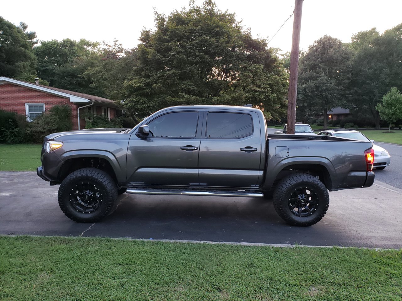

    Definitely a 3 1 lift kit. You can tell it's not leveled. On mine I did the 3 2 to lift and level it.20190810_195911.jpg

    Also mine has 285 70 17 tires that fill up the wheel well a little better
