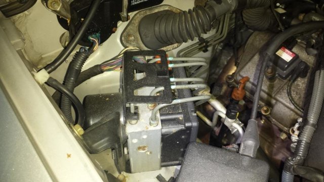

    Does your Tacoma have an ABS pump and control module mounted under hood on left side close to the firewall in engine compartment?
    Many owners delete ABS altogeather as it's not totally necessary anyway.
    Not all 1st gen Tacomas had factory ABS to start with.
