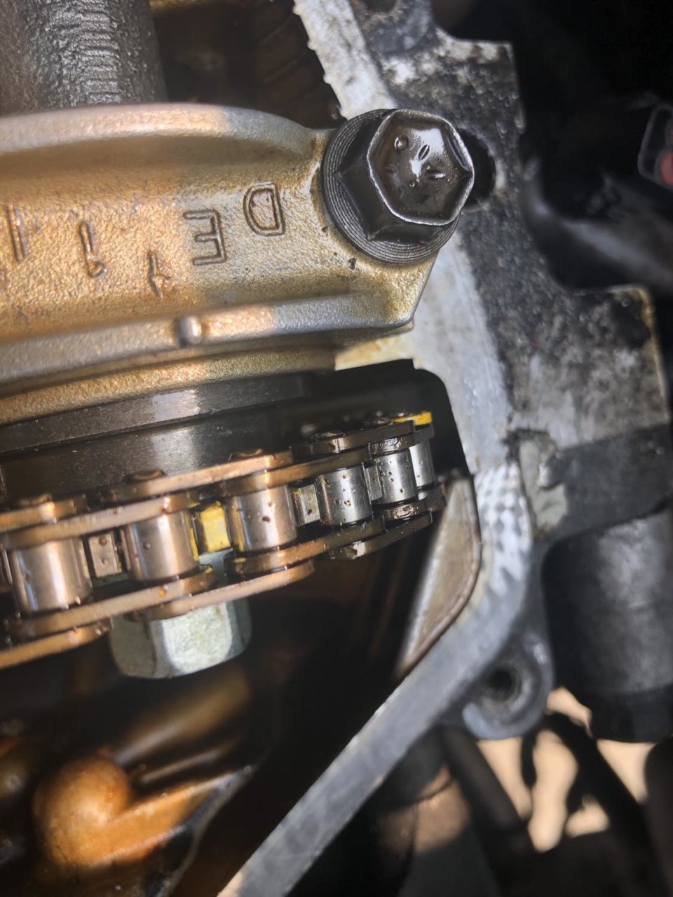

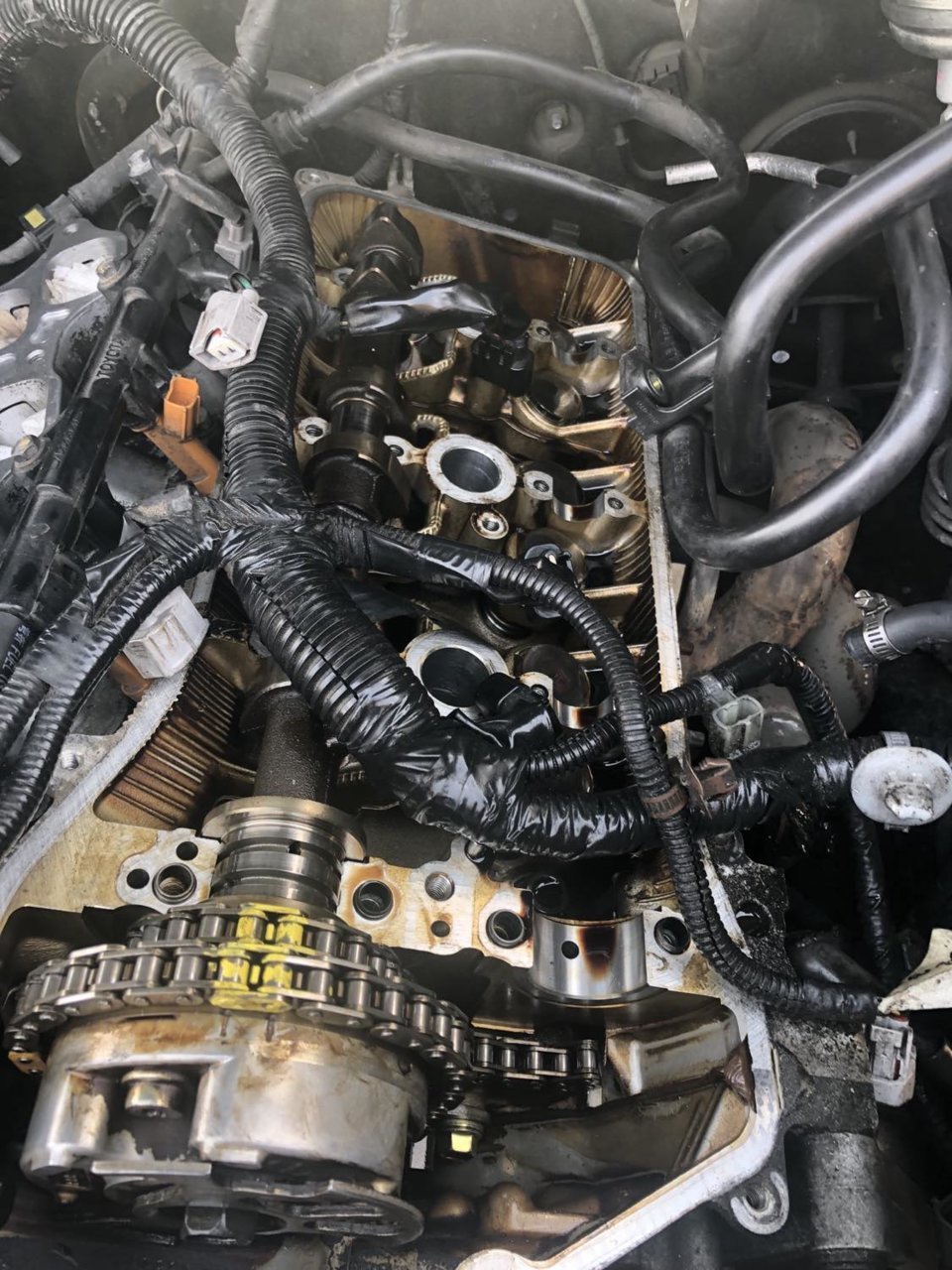

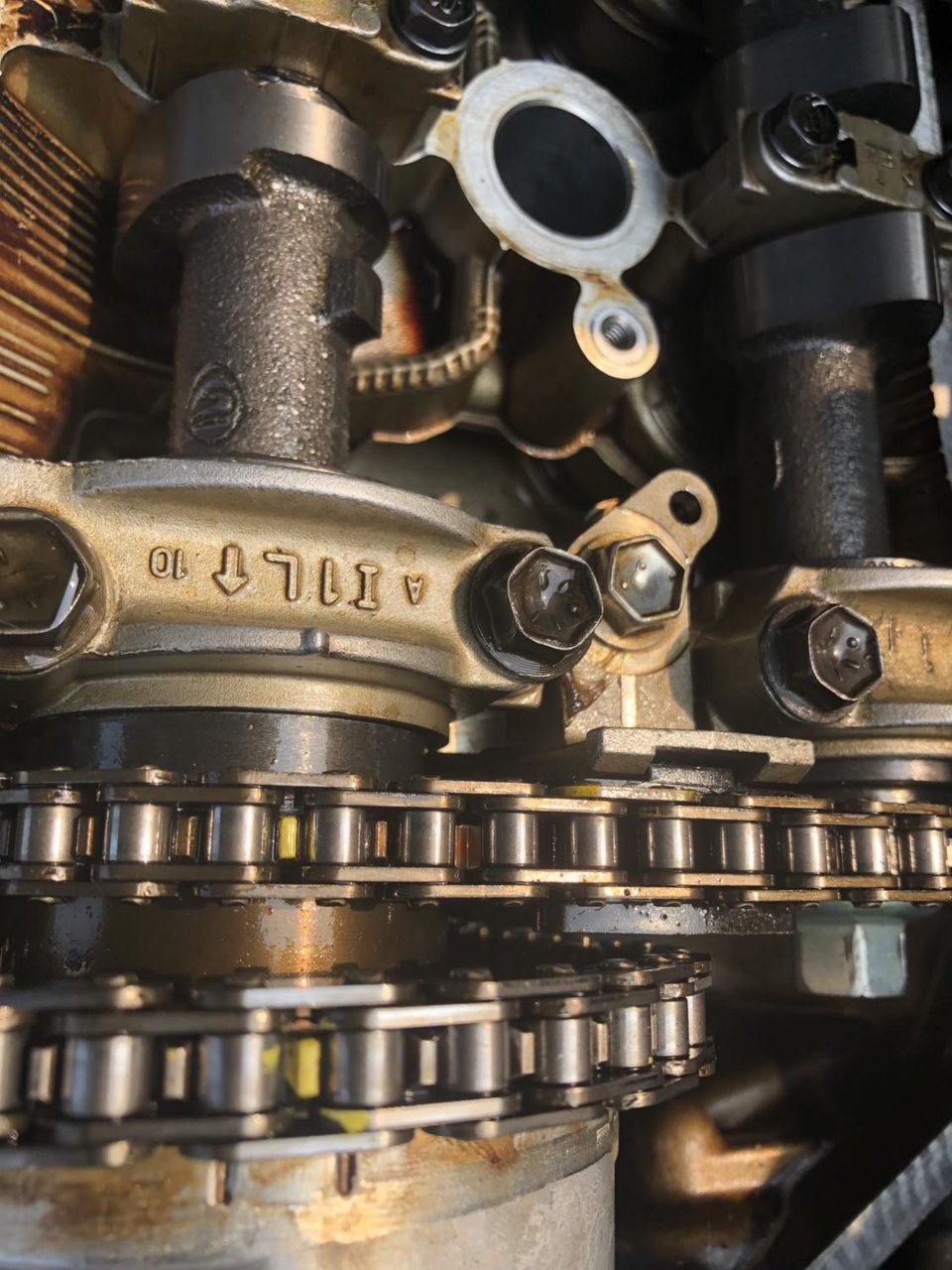

    Is my timing chain set up right?

    Seems like it moved 2 spots after I turned the crank 2 times

    Assuming your yellow paint lines with the dots, yes.
    Did you have the chain completely off? Or just a sprocket?

    yes the paint is on the dot.I took both chains off and had them hanging on the sprocket

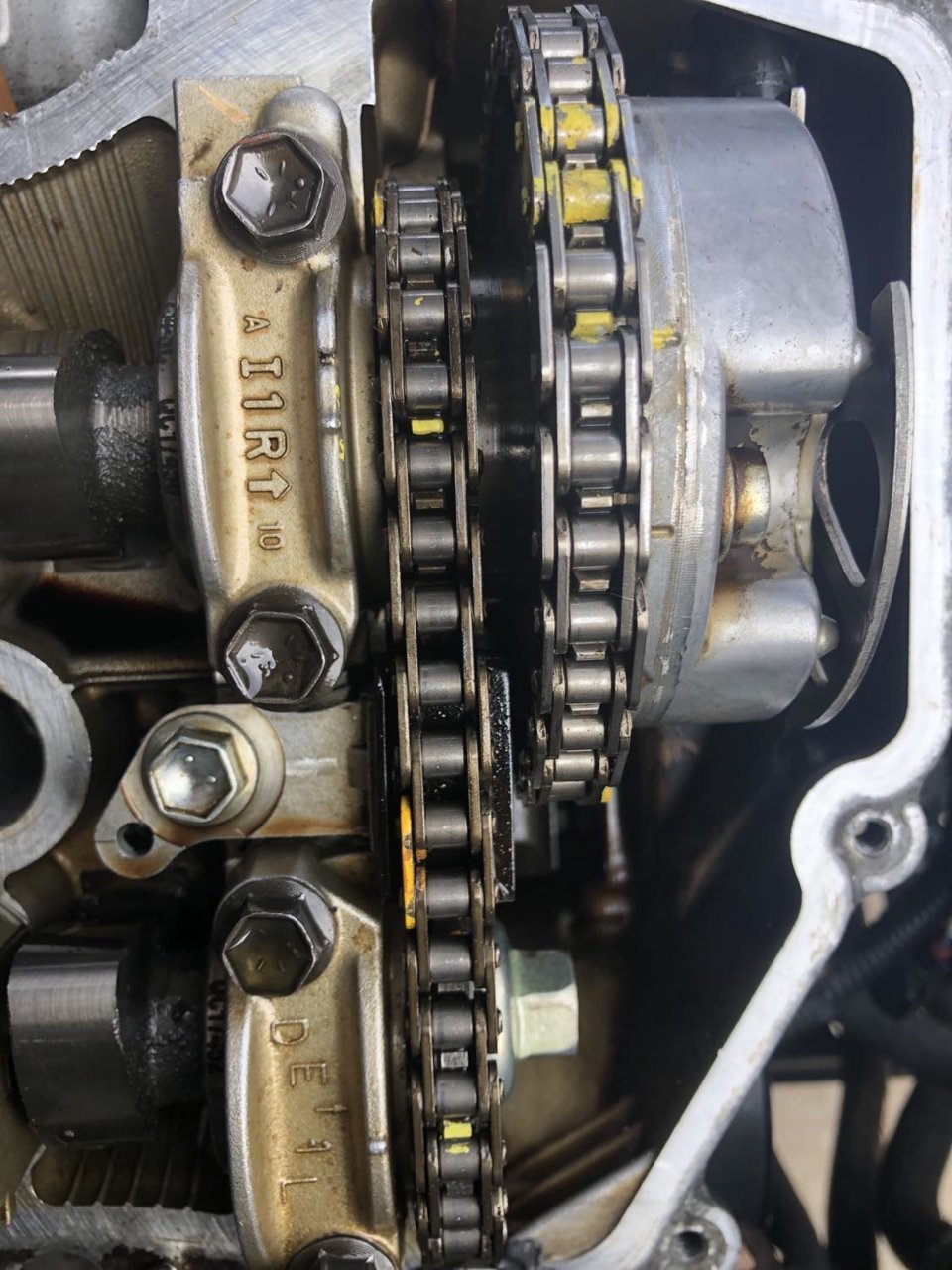

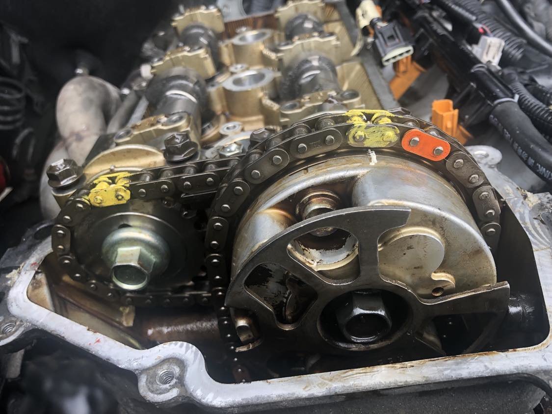

    They are not in their original chain links anymore after 2 or 3 crankshaft turns....
    This was the original before i did anything.

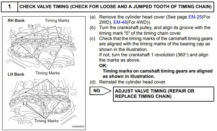

    Hmm my picture shows wrong, @Dm93 or @TnShooter can you share the repair manual timing chain assembly?
    It looks like they are off one tooth.

    The marks on the chain will not be in the same place after the engine is rotated, they are there for initial timing setup only.

    as long as the marks line up then it's good correct

    All my marks are lining up. Just can't look at the crank mark because I didn't take the cover off.

    If your marks all line up like they are supposed to then your timing should be correct.

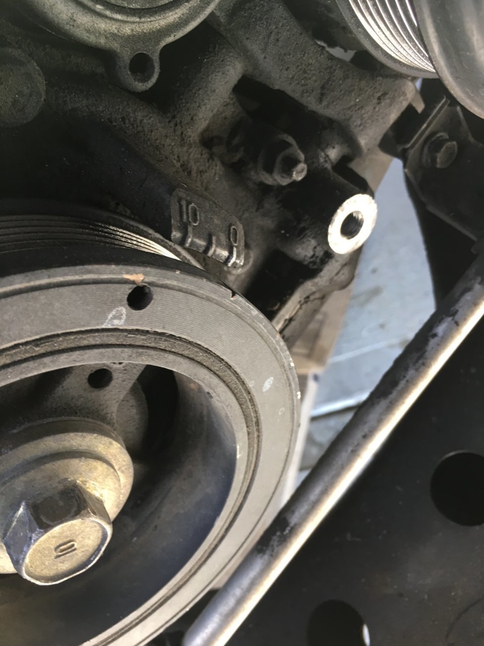

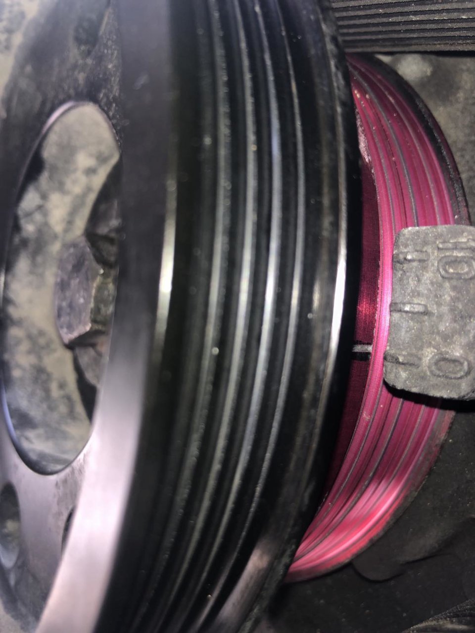

    Crank you should be able to look at the balancer for the 0deg mark no?

    i didnt take the timing cover off,
  15. Jul 24, 2023 at 5:42 PM
    TnShooter
    TnShooter The TacomaWorld Stray
    Sep 2, 2010
    #42625
    20,880
    Deogee
    07' TRD Off-Road, Auto
    STOCK
    The balancer is also called the crank pulley.
    On most vehicles, there is a mark on the crank pulley and timing cover.
    Line them up and you are on TDC (or 180 out).
    I don’t know if the 1gr has those marks. I never looked. (Yet)

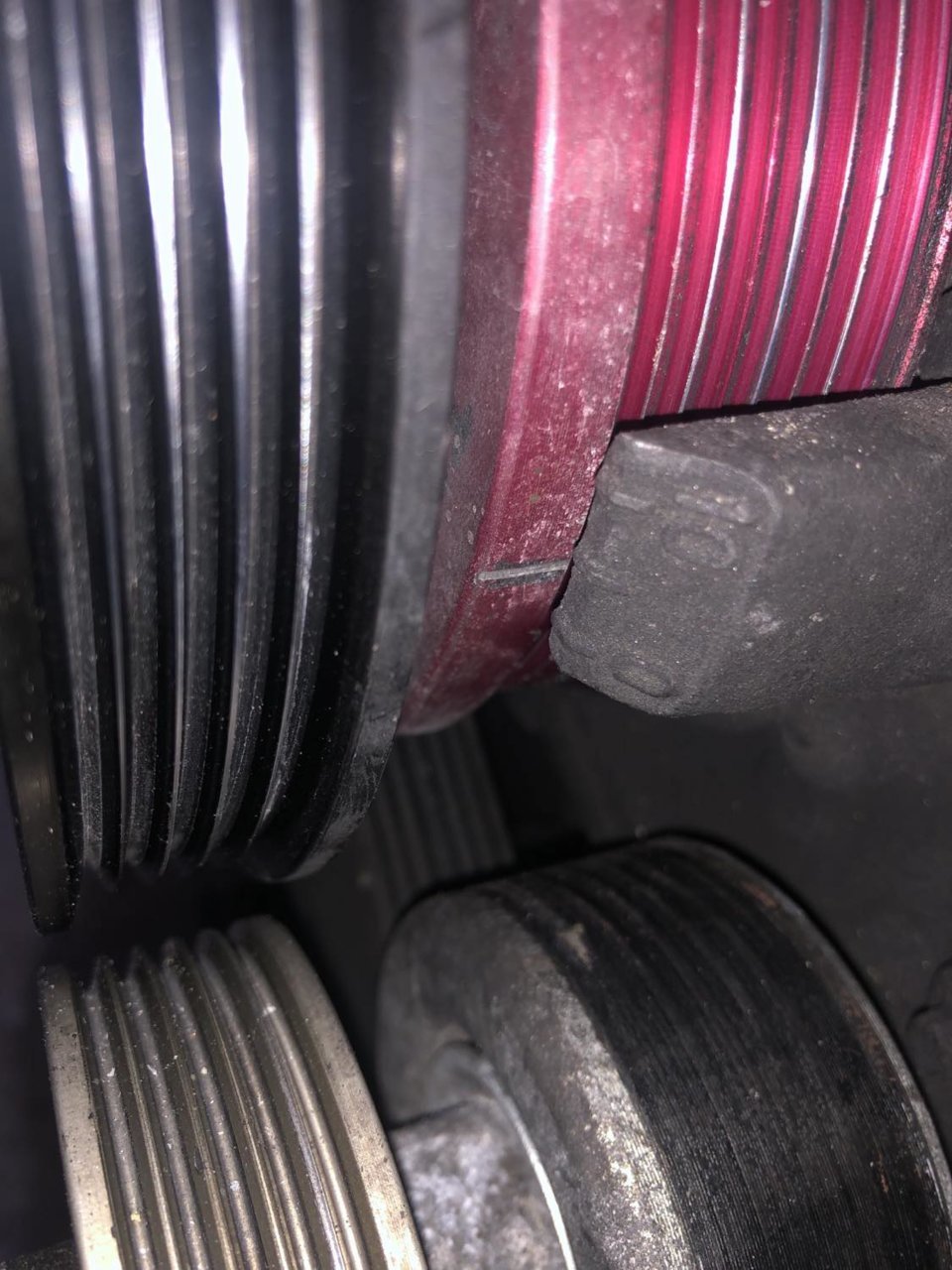

    I don't have the original. I have the non stop pulley. I marked it,, but probably not a accurate as the original

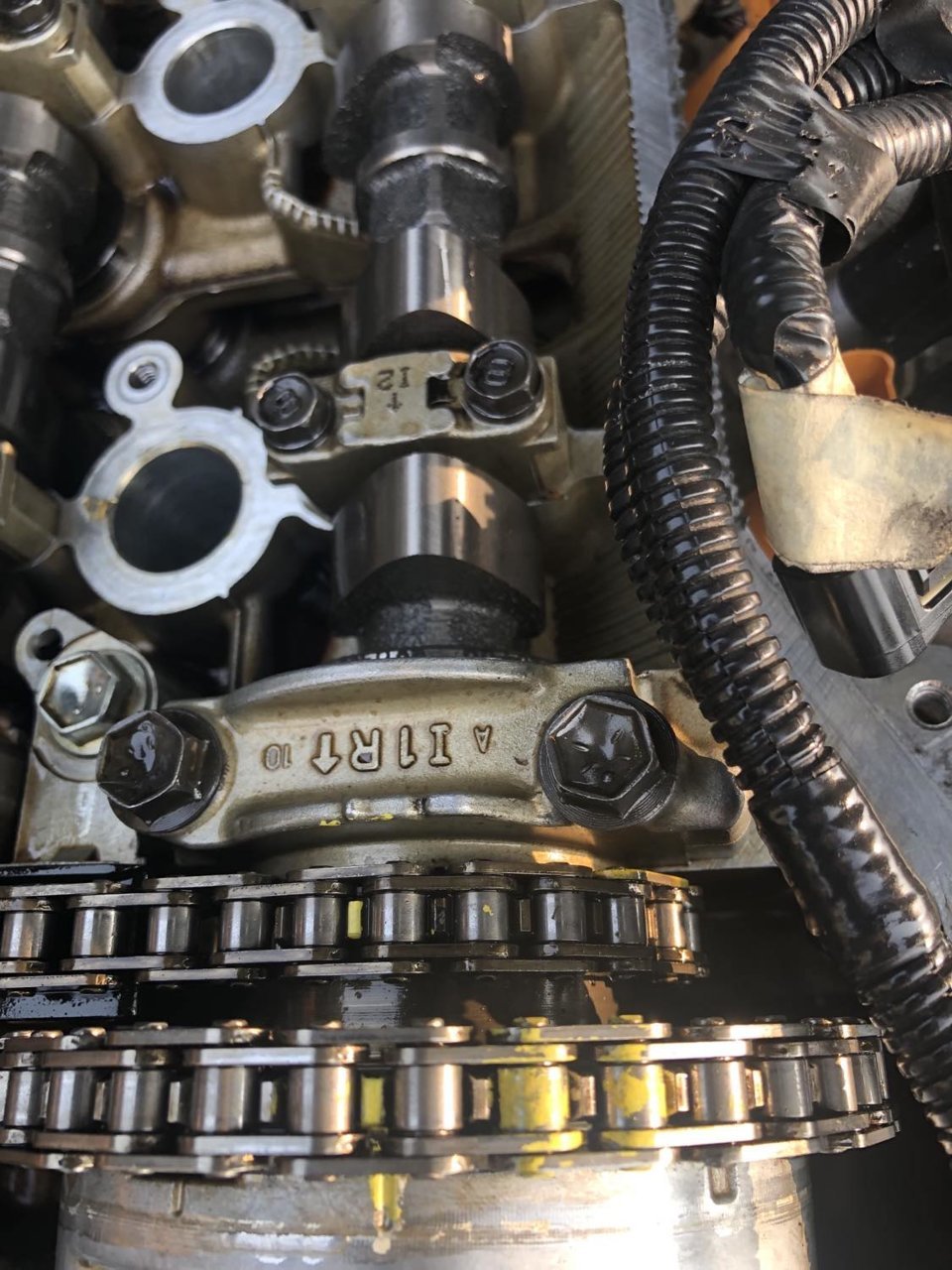

    look at that.. This good?

    might have to double check the marks on the chain. not sure if I left it TDC

    after moving my chains to the marks. I do have it sitting at 0
