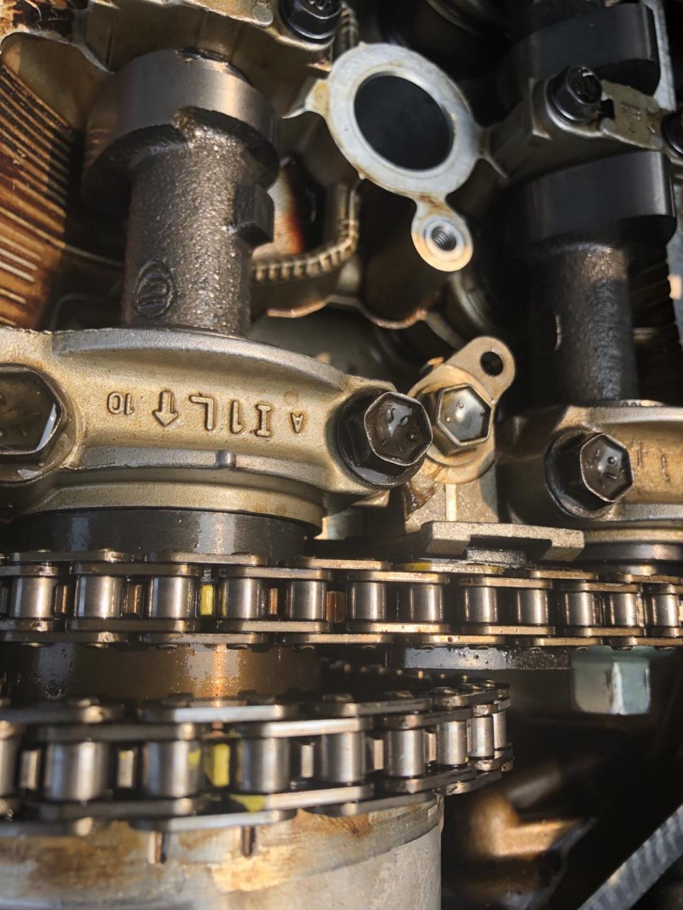

    this is the right position for the marks?

    If the dot on the exhaust cam is lined up with mark on the cam cap. Then it looks right.
    Are those pictures of the marks currently?

    yeah, it all lined up correctly

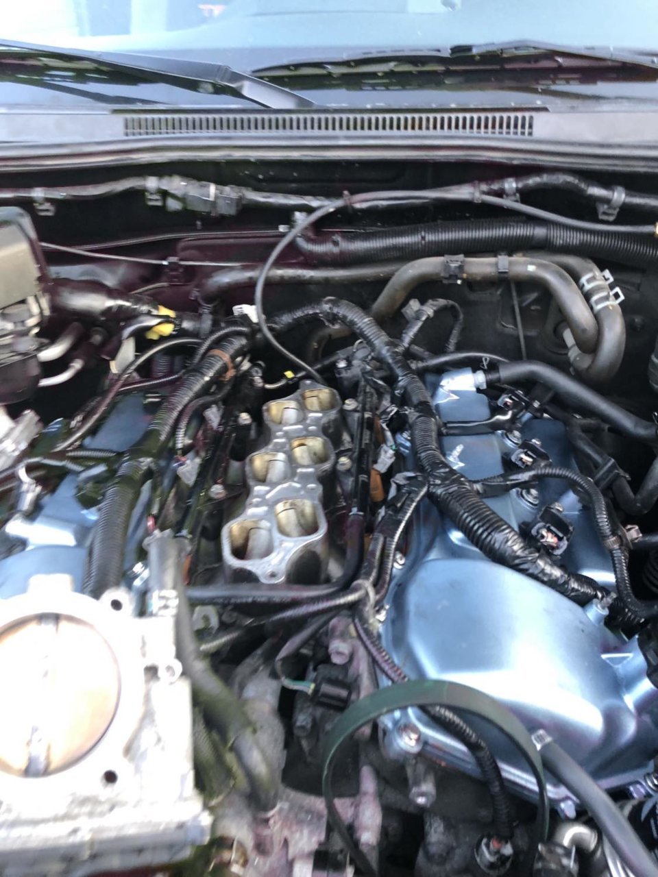

    Can I just do the compression test like this?

    yes
