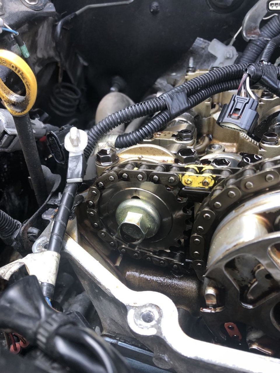

    I did the compression test. looks like the drives side is lower.

    Hopefully it is just that timing is off on the driver side.

    could that be a reason that the pressure is lower?

    Yes.

    Most likely a tooth off. Since you said that you rotated the engine by hand, and everything went smoothly. Either intake or exhaust.

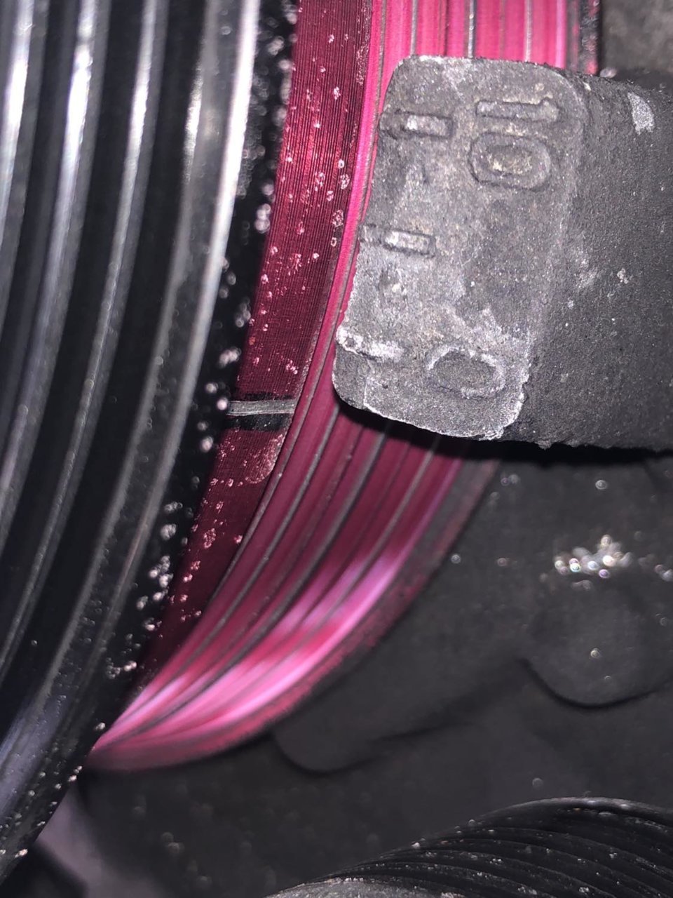

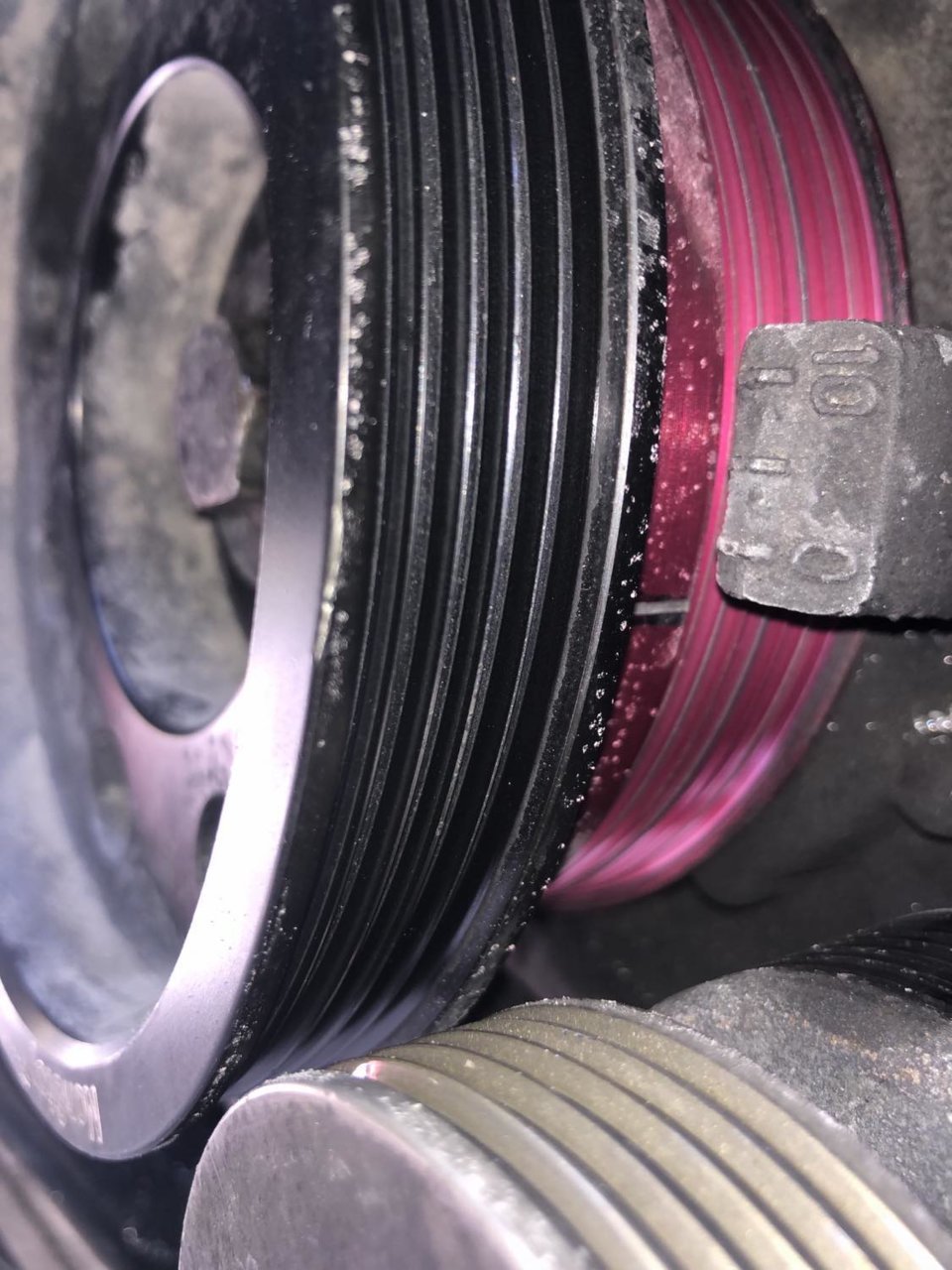

    okay I'm going to put the oem style pulley on, because it has a mark from the factory. MY nts pulley was marked by me and is probably not accurate. I want to pull the timing chain front cover off but I know its a lot of work and I never done that before

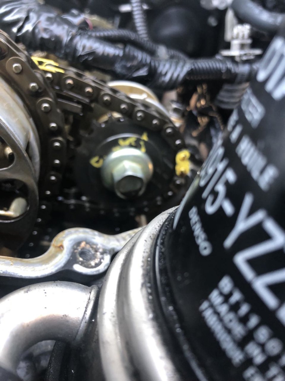

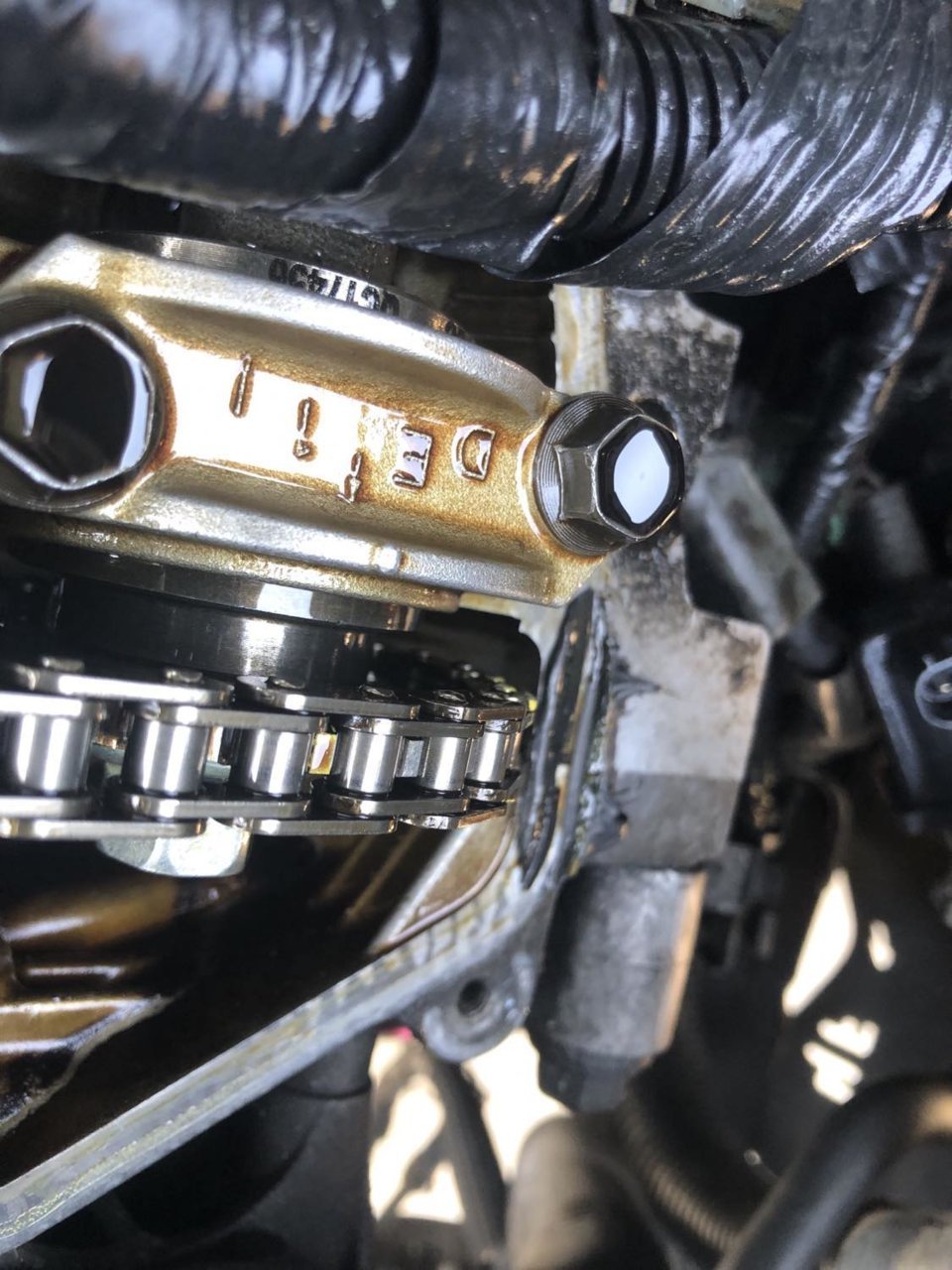

    Looks like my timing is off.... looked good when I finished last time...
    HondaGM likes this.

    Can't trust this pulley though

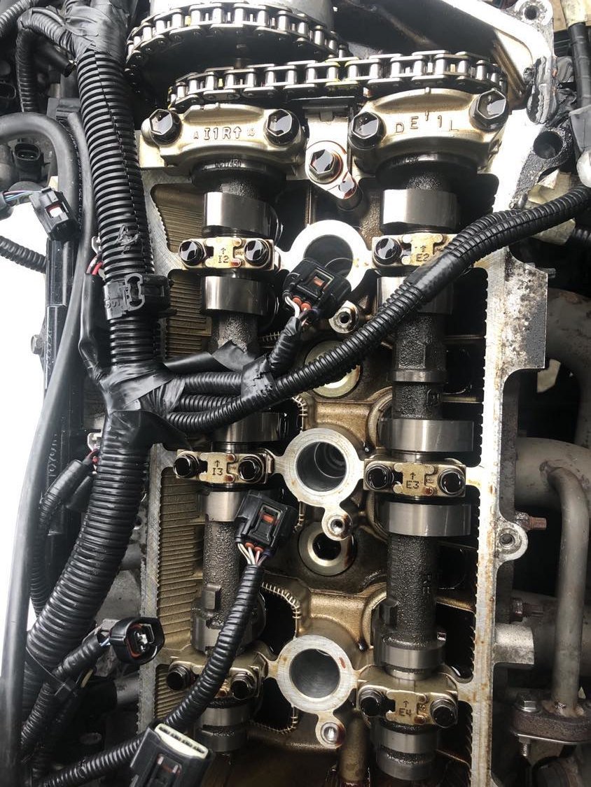

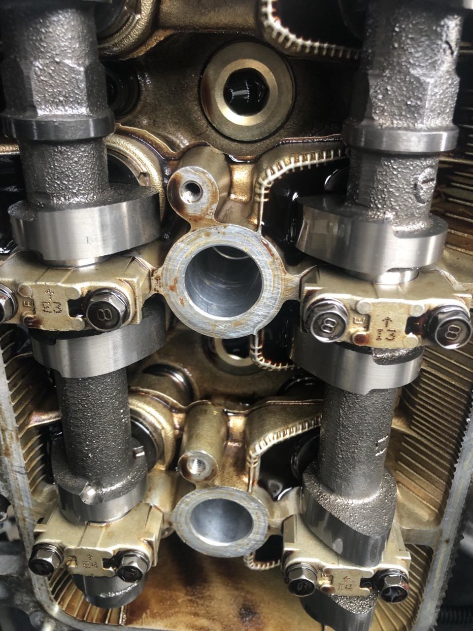

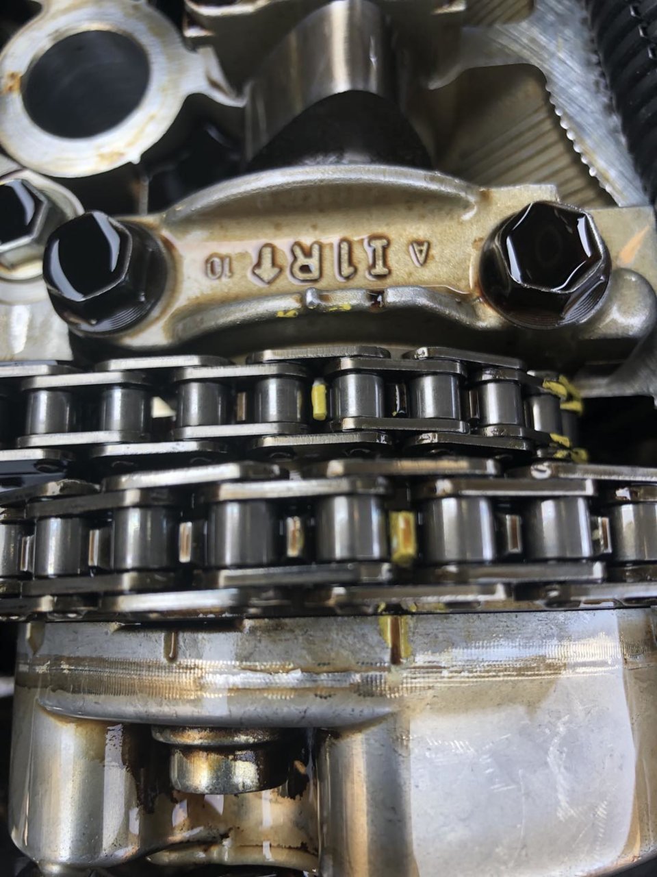

    Hard to tell, but maybe a tooth off on the intake cam?

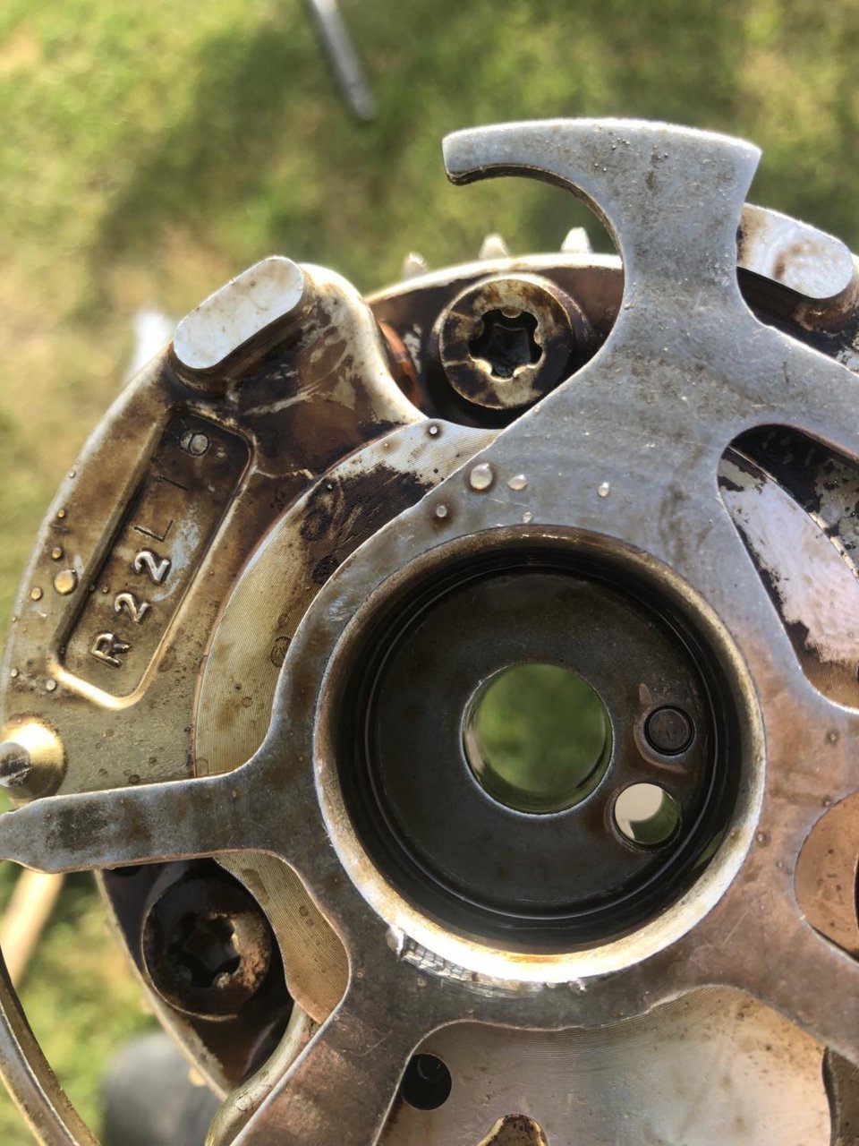

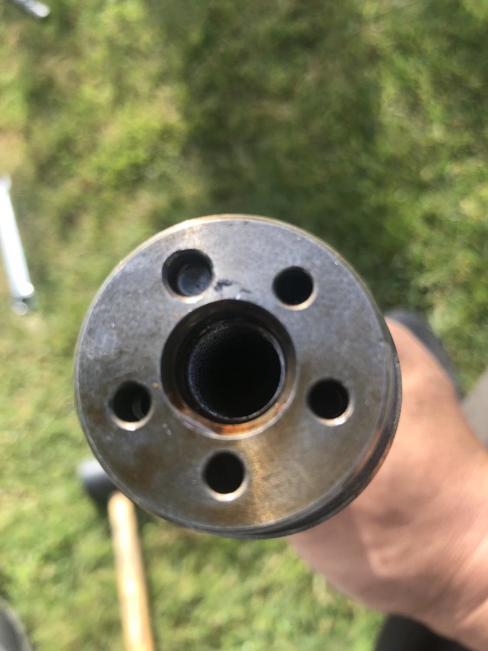

    I had to use a mallet to get the sprocket off. The key pin is pushed all the way in. Now I got to replace both parts

    I wonder if I can salvage the sprocket

    You cannot tap that pin back to position? Out of the cam gear?
    Regardless, I am glad that you found the issue. :thumbsup:

    Honestly, you're not the first member that I have seem do this. It happens, so thank you for sharing. Something to be very mindful of.
