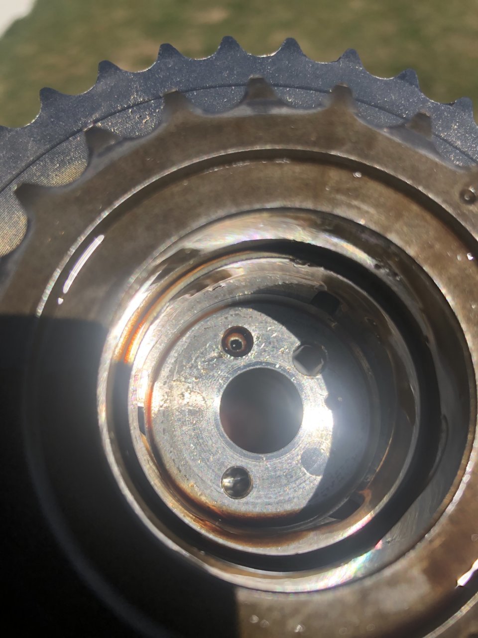

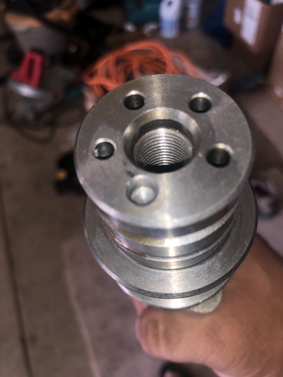

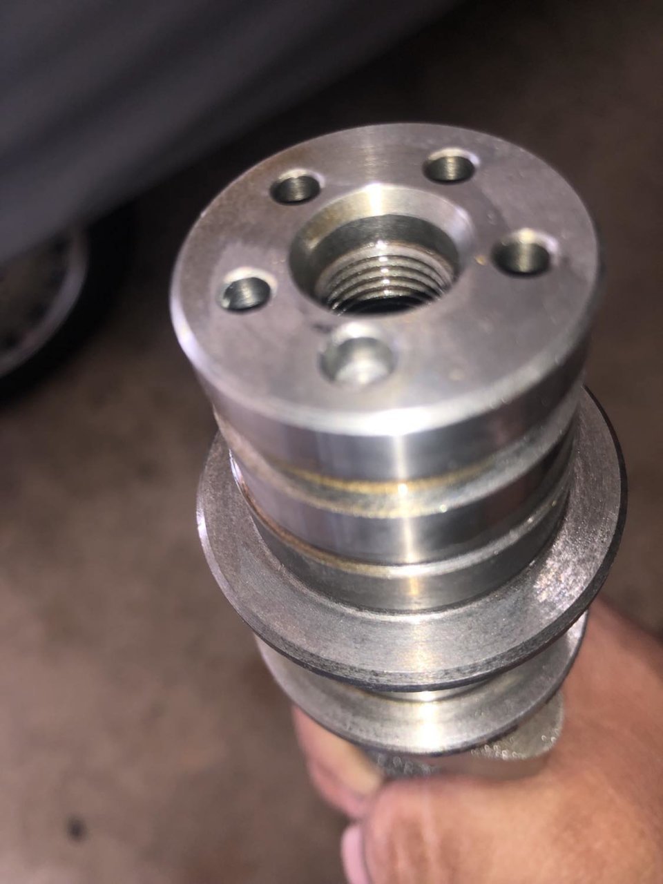

    I'm not sure of its original position. But the camshaft doesn't slide in anymore. Its tight now

    You will need to get that pin out, to put back in the cam. Or at minimum to find a properly sized replacement pin.
    Standard Motor Products makes excellent intake cam gears (on RockAuto), if you don't want to purchase a new OEM one.

    I probably need to get a new camshaft from kelford though. Probably no way to pull the key pin out

    Is there even a pin in the cam, or is that just the recess for the pin? Hard to tell.in the photos.

    no I'm sorry, the pin is in the camgear now

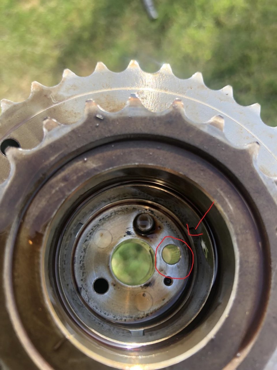

    I think it went into the wrong hole. The right hole is the red circled one

    Looks like you could pop it out then, and possible reassemble correctly.

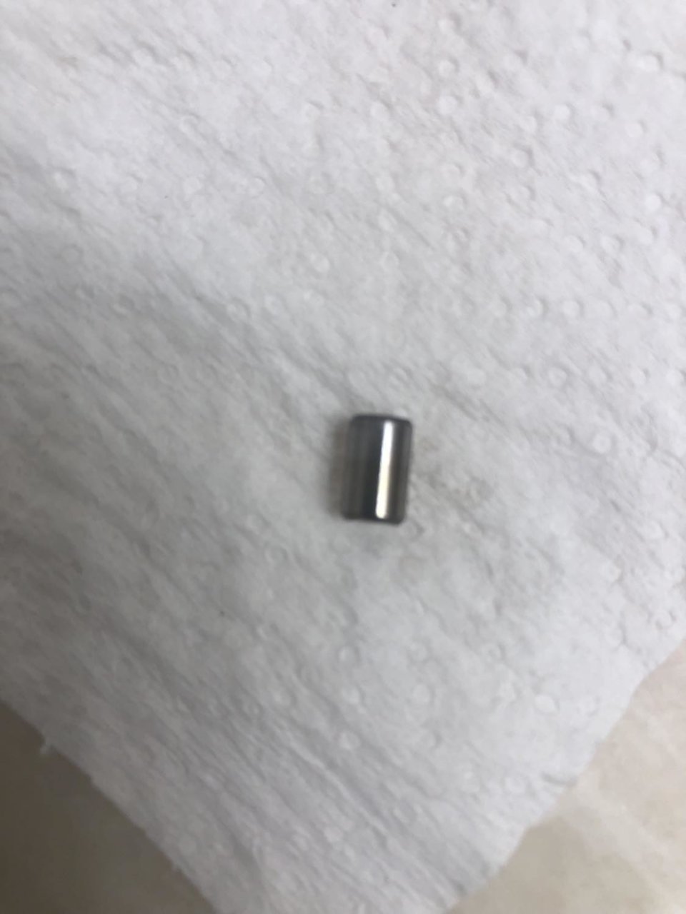

    that was a smaller hole. the pin is probably damaged. Can I get a new dowel pin from any machine shop?

    That pin is a harder material than the aluminum it was going into. It maaaaay be fine. But you need to check it.

    pulled a dowel pin from my old camshafts. looks good

    Still get the other one out

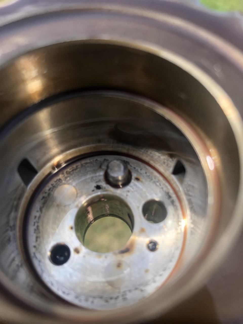

    Got the pin out. Is this hole I took the pin out of okay?

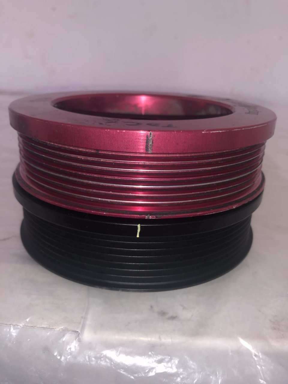

    my pulley matched up pretty close to stock replica one.
  20. Jul 30, 2023 at 3:27 PM
    #100
    chueflee
    chueflee [OP] Well-Known Member
    Dec 23, 2017
    #239192
    302
    Chue
    2013 toyota tacoma TRD offroad extended cab 4x4 v6
    afe intake, urd spec u headers, urd y pipe, 76mm throttle body, kelford camshaft, trd supercharger, urd cam gear, urd thermostat, ucon ems, NST pullies, ipt valve body, stoptech disc brake 323mm front, sos rear disc conversion
    It was damaged a bit when I first installed it. Key was not in slot perfectly and one side was pushed out, but it did works it way back. I never had a problem with it. Might just get a new one
