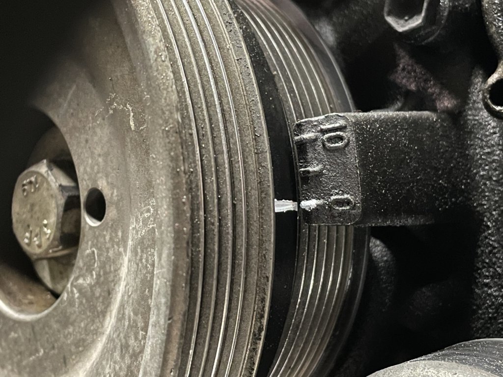

    I am working through an issue with my timing chain and questioning if my timing is truly off.

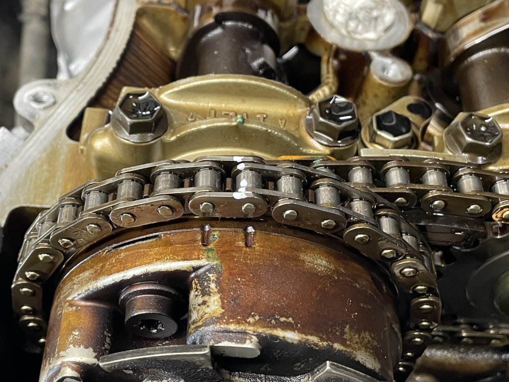

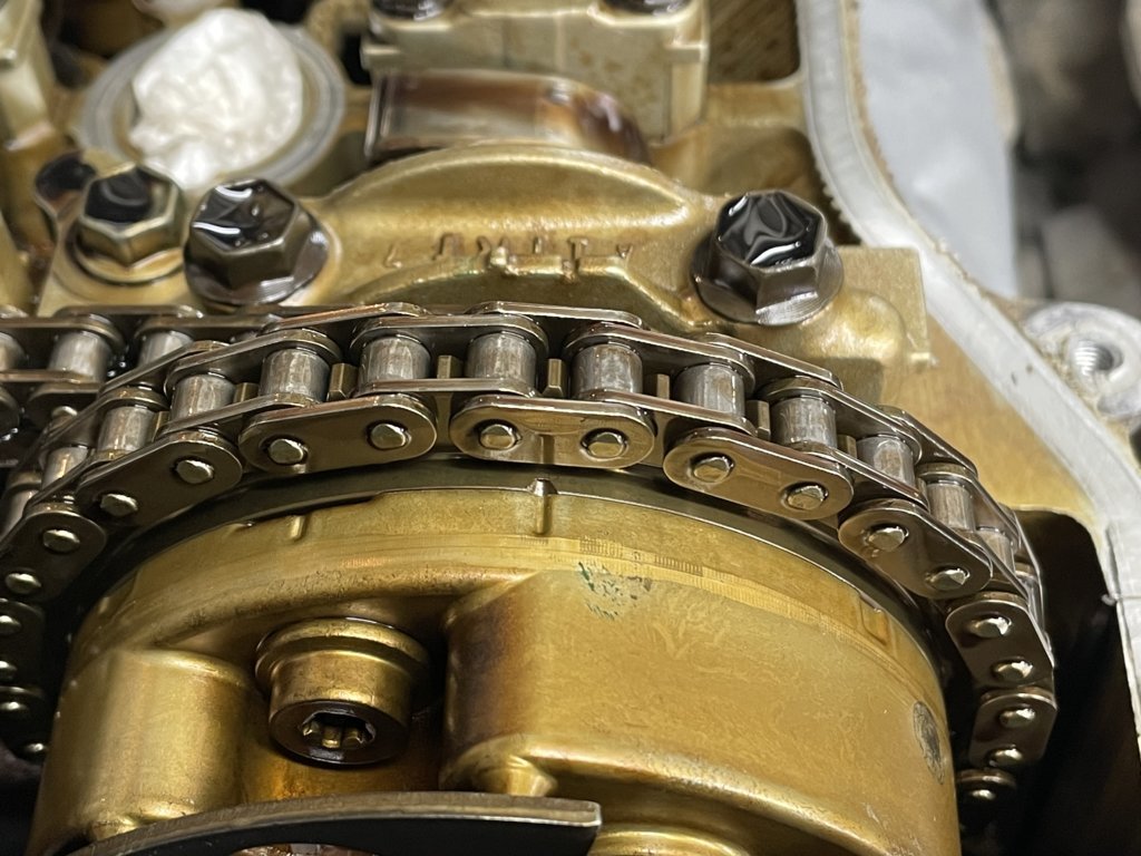

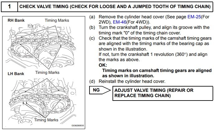

    During the process of disassembly to replace the valve guide seals in my 1GRFE I noticed the timing marks were not in exact alignment with TDC. All the cams were in alignment with each other but the markings were always just behind the Crankshaft.

    I measured all 3 chains per the manual and they are at 5 3/8" for every 15. Spec is under 5.72
    All the IN/EX sprockets are aligned.

    It's possible the balancer has slipped on the hub, have you verified the TDC mark is indeed at actual TDC?

    I'd verify the mark lines up with true TDC, older balancers tend to sometimes be slipped slightly.

    Now that the pictures loaded it looks perfect to me, maybe a degree or two off which at 200k isn't bad.

    If you’re chasing something and need to be 100%, then by all means verify TDC mechanically. It looks like less than half a tooth on both sprockets, I’d say you’re fine.

    Confirmed with a screwdriver that the "0"= piston #1 is TDC.
