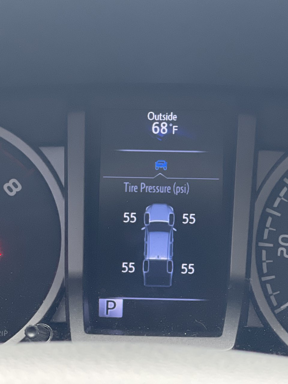

    E load will require more PSI to support same weight as SL load. With 285/75/16s, door jump psi number is useless. I would do at least 35-37. 55 psi is way too much and will cause your tire to wear out in the middle. Also, not great for suspension because of the rougher ride.

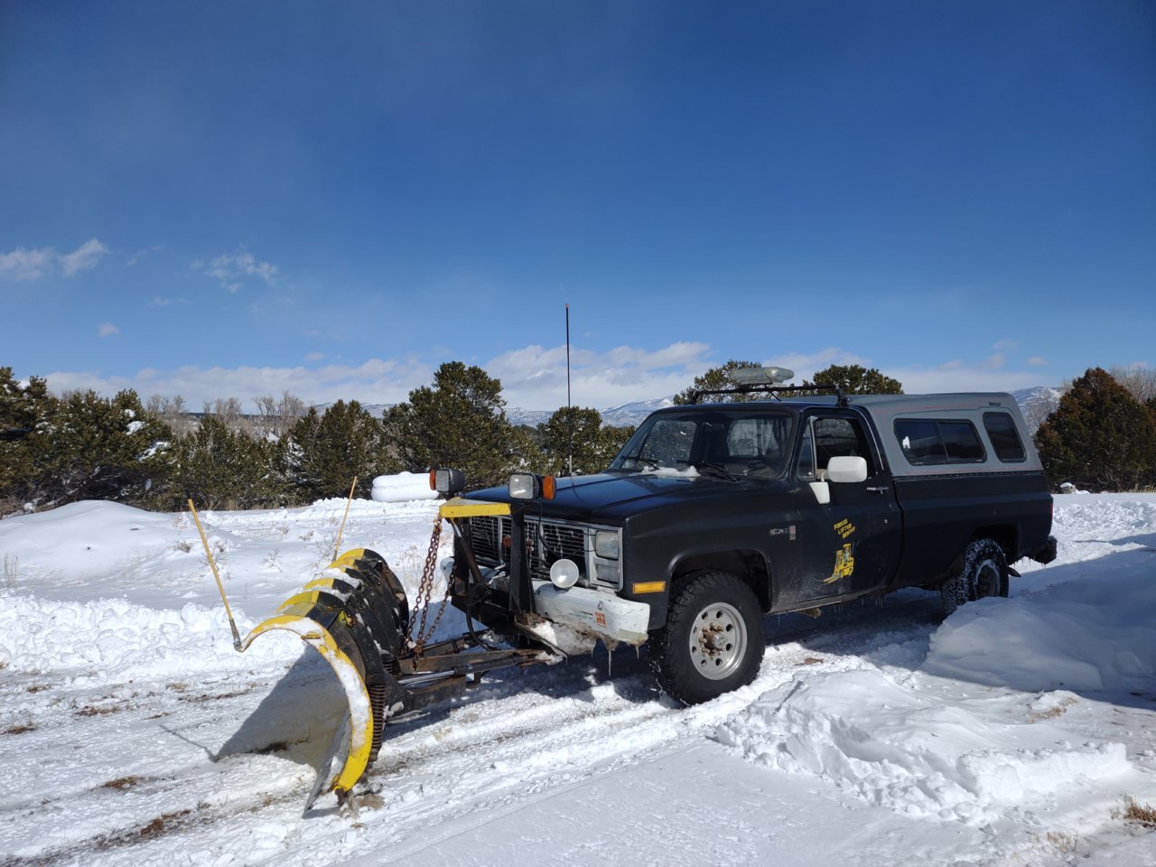

    IMG_20220224_132443593_MP.jpg I run this pig, 7500lbs, shod with 235-85-16 K02s at 40psi................

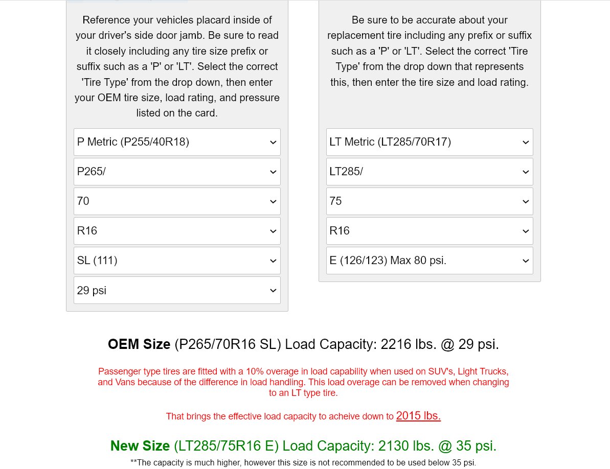

    I believe your OEM tire info is off.
    It's a euro-metric 265/70/16/112 @ 30 psi; not, a P-metric P265/70/16/111 @ 29 psi

    If that's 55 cold I'd hate to see what it is after a run on the interstate in the summer.
