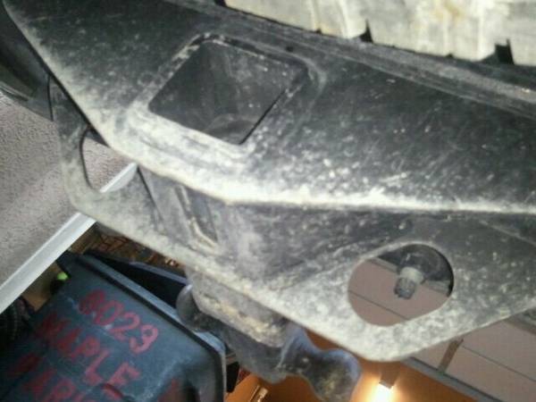

    I bought an 05 tacoma last week and the ball thing was stuck in there. the pin is missing. I wanted to remove it, but can't. Tried pounding it with a sledge and nothing.
    So I decided to look at the back and found this.
    Is that welded on at that joint? It sure looks like it to me. If it is, how the heck do I get it out without a blowtorch?

    Grinder

    That, to me, looks like just the receiver welded to the frame of the hitch
    judging by the rust though, i'd bet that the ball is just rusted into the receiver

    get you a can of PB blaster or whatever the hell its called..spray liberally..give it a few minutes..then try pounding again...

    Factory! Pic of side, rear, etc..

    doubt its welded, you are in IL, meaning rust and other crap buildup. doubt its selded. get a grinder, some PM and a strong swinging arm. BUT, you might wanna consider a new bumper.

    Make friends with someone who has a good air hammer, it's just rusted in. If you do tow anything, be absolutely sure you put a pin in there first.:cool:

    Looks like a stock hitch. I don't see any ball.

    Allow me to reinforce this!
    End thread! Unless you show us a pic of an actual ball in it!

    ....or find someone with a set of Acetylene/Oxygen torches and heat the receiver till its red hot, then just pull it out.

    OP, the "ball thing" is your receiver. I bet you don't have a hitch inserted into the receiver, which is why there is no pin. Hitting the receiver with a hammer might be fun, but it's not doing your truck or tools any favors.
