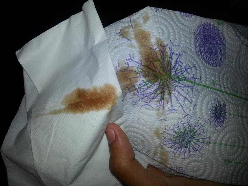

    My 01 automatic transmission has been acting a bit different lately, such as not shifting until higher rpms when cold. I checked the fluid today and its brown with a strange smell. Not exactly a burnt smell but smells exactly like crayons. Thats the only thing I could think of to compare it too. The tranny was serviced around 115k miles which i believe was a flush or drain and refill. It was unspecific on the toyota website and it was when the previous owner had it. Now im pushing 177k miles. Should I go ahead and do a full flush or drain and refill. Worst case scenario if I need a new tyranny or a rebuild can you guys give me some estimates on how much that would cost. Thanks in advance. First picture is with flash.

    When the fluid is cold it will affect shit points. How high are the rpms before it will shift to 2nd? Is it the first shift of the day only or is it all shifts all day long?
    Do you have the ECT button in the on or off position?

    The transmission shifts at higher RPMs to warm the fluid faster. For me it stays in 2nd until ~35 when cold.
    As for the change, yes. I believe every 30k miles is advised.

    Around 2500 rpm which doesnt seem like alot but Its not normal. It will only do it once in the morning after the truck has been sitting all night but it hasent done it in a while. No the ect button is not on.

    With all that being said do you think its a good idea to change the fluid? I dont want the tranny to crap out on me right after the change. If so should I just do a full flush to get all the old fluid out?

    2500 is about what mine does when the fluid is cold. This more of an issue during the winter. I don't notice it much during the summer/warmer months. Fluid temp also affects when it will shift to 3rd. Once I see 90 degrees or higher on the scangauge, it will shift to 3rd normally, meaning any rpm if there is no or minimal load.
    I would do the full flush to get rid of as much of the old fluid if possible. Then decide if you have a problem or not.

    To the OP, from what you are saying everything seems normal. I have an 2004 V6 auto with 70K miles. The fluid looked good but I had a full flush at ~68K miles. After every startup 2nd gear runs a bit high before shifting- almsot to 3K RPM. After it shifts into 3rd gear or a few minutes of driving (whichever is first) it shifts perfectly smooth. As someone else has said before, when the tranny is cold it will shift higher (2nd gear just seems to be most noticeable to me). If it shifts hard all of the time, cold and hot, then you potentially may have a problem.
