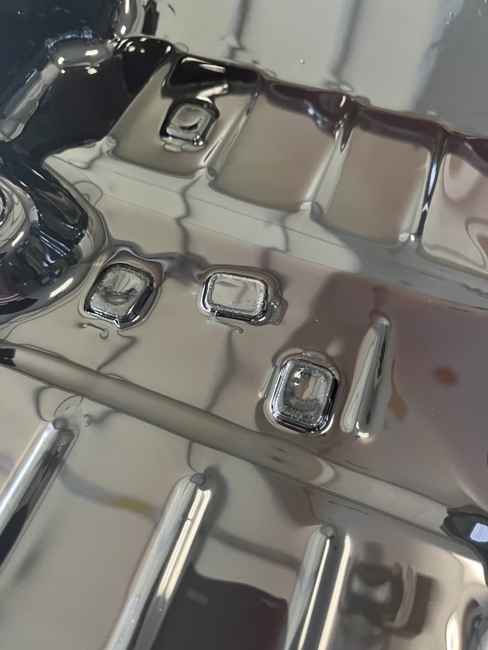

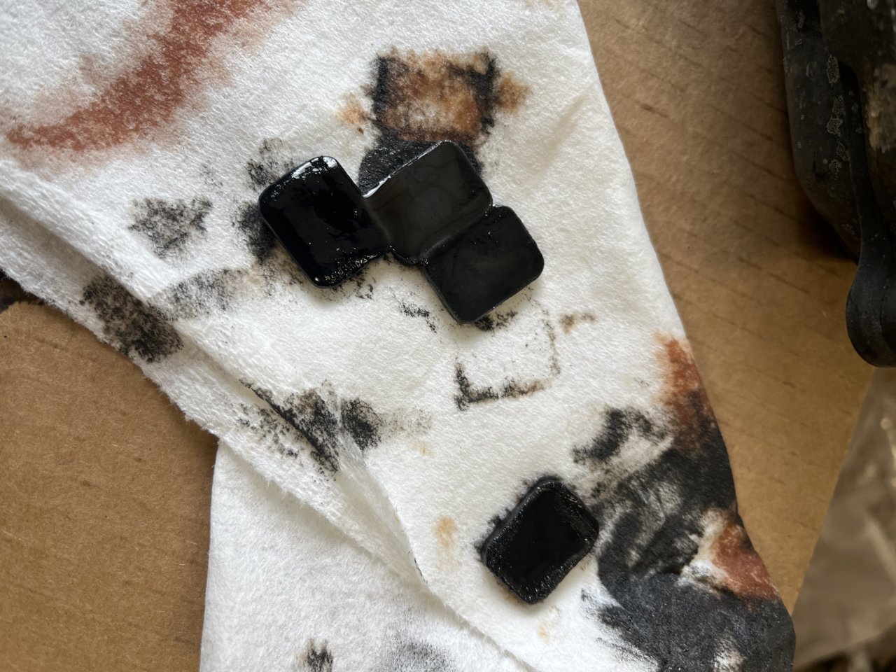

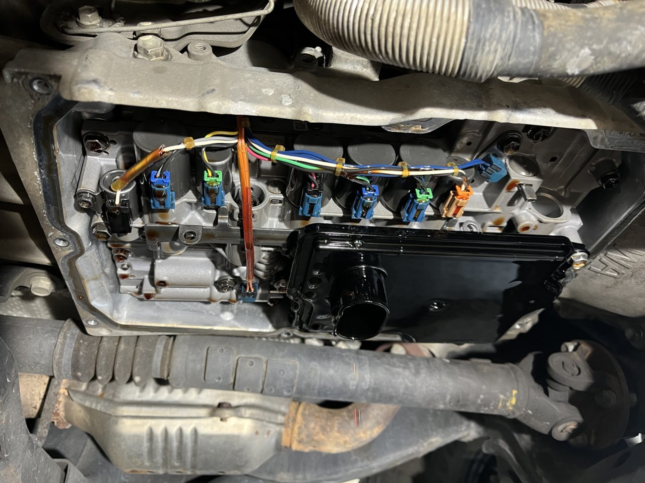

    Well I drove it in sport for a week before doing the transmission pan drop. The shudder was almost completely gone. The fluid looked about as expected but not terrible. I had about a quart run out the fill tube when I first opened it(cold). Almost nothing on the magnets. Mine took a full gallon to refill. Lubeguard will go in on the 2nd drain. Amazon shipped by USPS .
    Shifts fine, can’t get it to shudder but only about 10 miles of testing. If I had known how easy this is I would have done it sooner.
