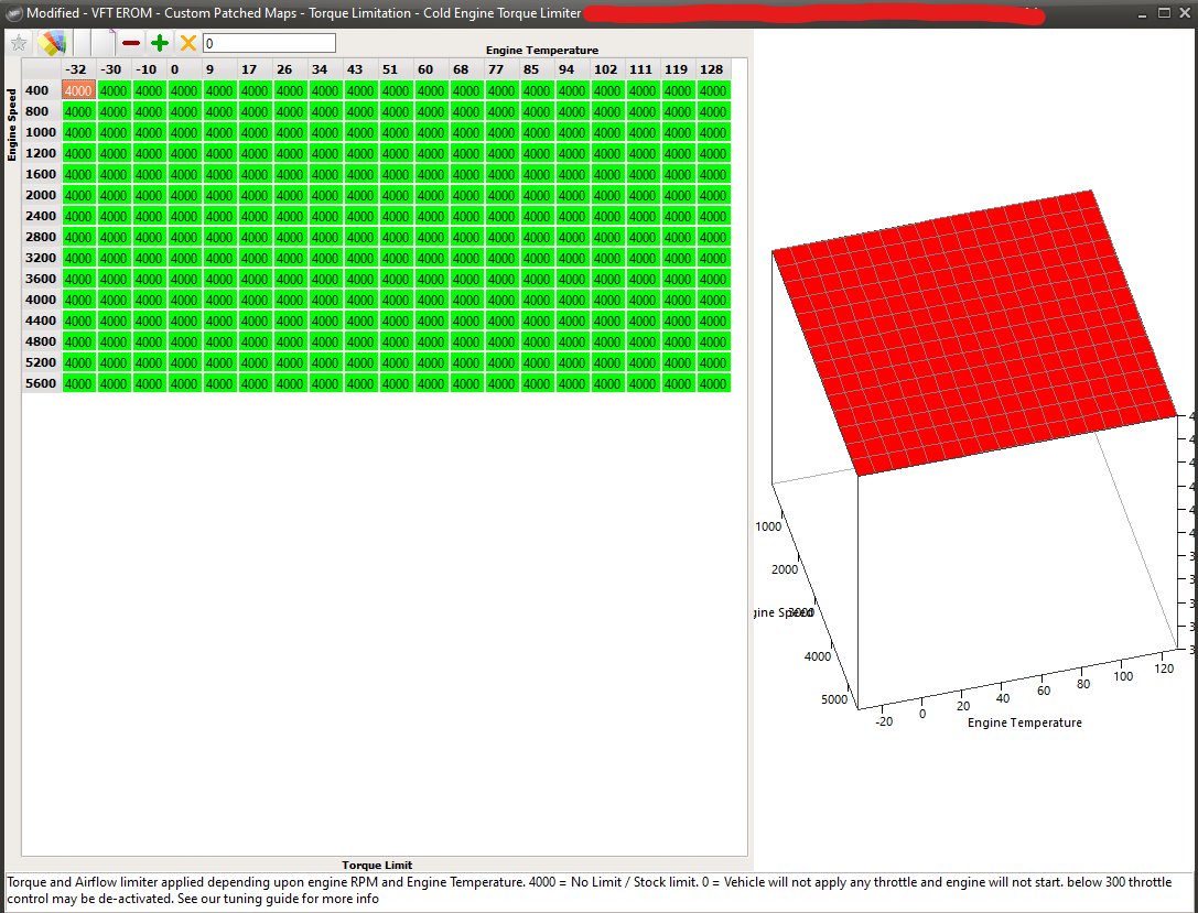

    As discussed with you previously via email, we (@Formidable and I) determined via testing that under 38F the ECU was limiting via an application of throttle limiting, almost certainly a safety system

    Your welcome.
    Yeah. One of the YW testers was having a bad time dealing with this. Most dyno shops are open up for runs. The power limitation below 38F could ruin the day.

    Marc,
    We discussed it but didn't come to a conclusion.
    Do you know which sensor the ECU is using to determine ambient temperature? Could it be the sensor that feeds the console temperature display? (The sensor by the hood latch)

    It's not like we can confirm whether or not we have access to every table. I chalked it up to an unavailable table which is basically a guarantee if it's a safety system

    Could even be in a completely separate ECU, like the Skid Control.

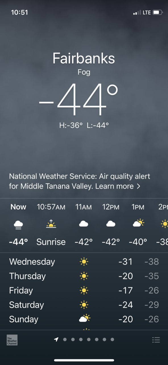

    No issues with power here. This is my weather for the last 10 days. Like this every winter. Only thing I’ve ever noticed is sluggish steering.
