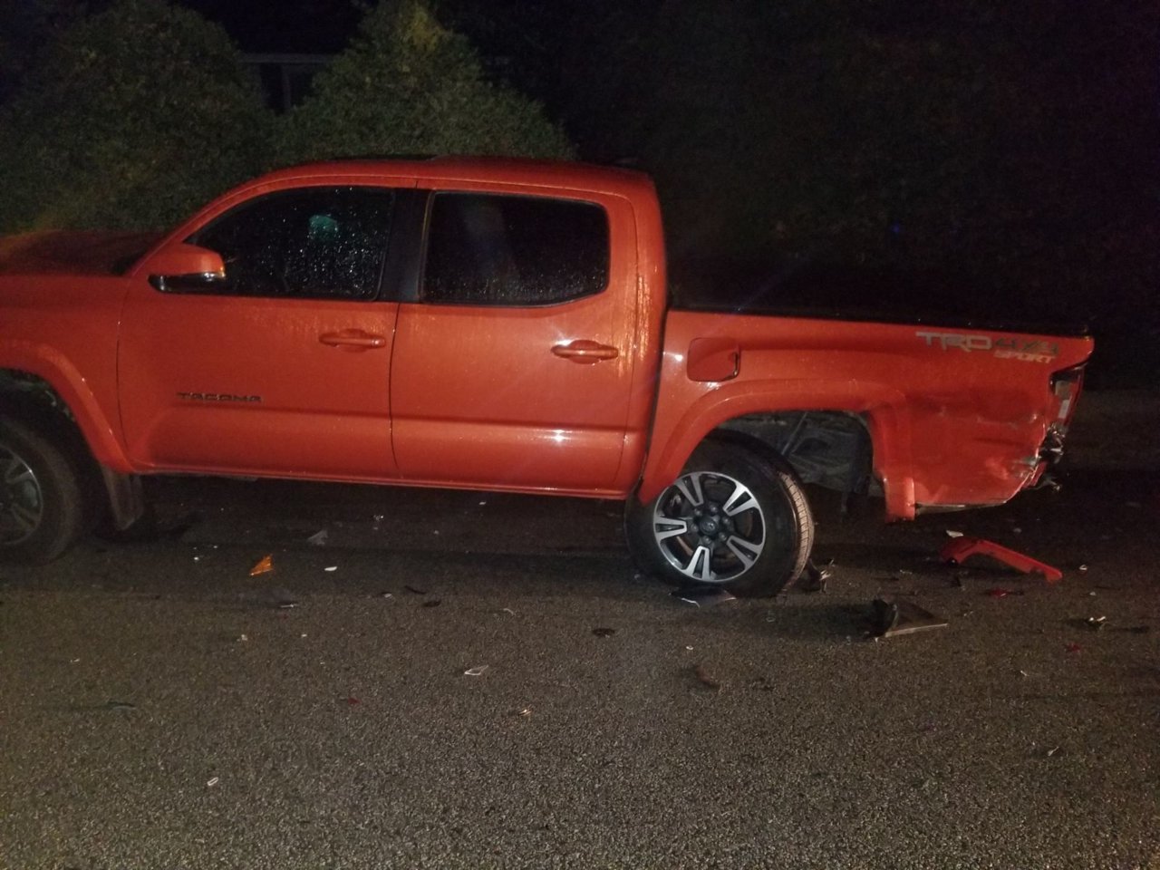

    They can always pull the frame or even replace it.

    These “trucks” are made of butter… I’m in the process of getting mine repaired after what should’ve been very minor damage from a rear ender. The rear bumper is completely useless, it’s only purpose, it seems, is to serve as a cavity for overpriced sensors.
    Yours looks totalled to me, sorry.

    Frames arent really a write off thing as much anymore. ive fixed lots or Swap a new frame on. They dont cost a ton either in the big picture. I.had a similar experience in Vancouver with my 2016. The big thing is the cab repair.. if you look into it, these trucks are using an incredibly strong metal in the structure.. that severely limits repairing and makes the job wayyyy more involved due to how the repair is allowed to be done. HSS and UHSS cant be sectioned like regular non structural. I cant remember off hand but i think they are using boron aswell in the cab. Id say it would be close to a write off but not sure american insurance companies work. depending if the composite box is damaged or not thats probly 3k alone. Cant quite see much. Its unfortunate for sure. Mine wrote off 3 months after i got it. Resized_20180909_025745_9780.jpg Resized_20180909_025849_2593.jpg received_246149106083969.jpg Screenshot_20180911-173258_Samsung Internet.jpg

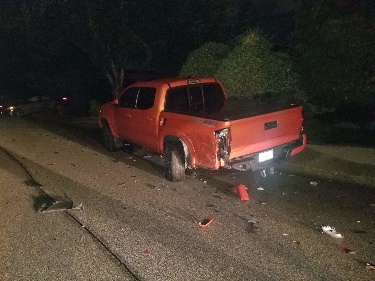

    Jesus looks like it took out the gas port too. I don't know man, I've seen vehicles totaled for less. If your doors and hood do not open that's usually not a good sign.

    Literally purchased a steel bumper the week before the accident for that very reason, but hadn't had time to install it. Had it been on the truck, it seems like it may have just ended up distributing more of the force to the frame but that's just pure speculation from someone who got a C in high school physics.

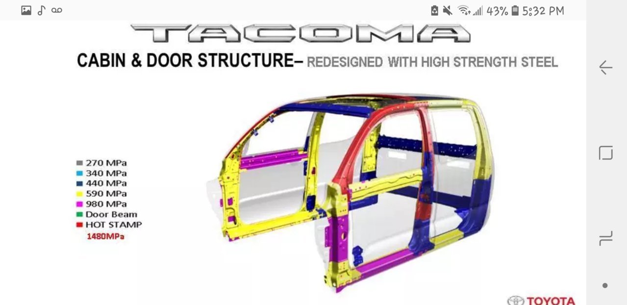

    Yeah, those pictures aren't great. The bottom rear corner of the cab was banged up--looks like its 440 MPa HSS section on the diagram. Thanks, very informative post.
    Gas port is obliterated, but the the connection to the hose and evap system seem intact. I'm definitely not holding my breath at this point.

    I'd be mostly concerned with the cab damage and the rear axle housing being bent. Sorry to see your truck like that.

    I worked as an estimator at a high volume collision shop for a little while. I've seen MUCH worse repaired. Given how these trucks hold their value I suspect it will likely be fixed. But the doors not opening is not a good sign. Could be big dollars there. We had a lifted 4 door wrangler come in once. Apparently the woman was drunk, ran off the road, took out a fire hydrant and smashed into a tree. She tried to drive away. Unfortunately the fire hydrant ripped the steering box in half. We fixed that one and it was REALLY messed up.

    I definitely request the shop use OEM parts. Alot of factors determine whether it's totaled. If the repairs are 75% of the vehicles value it may be totaled.
