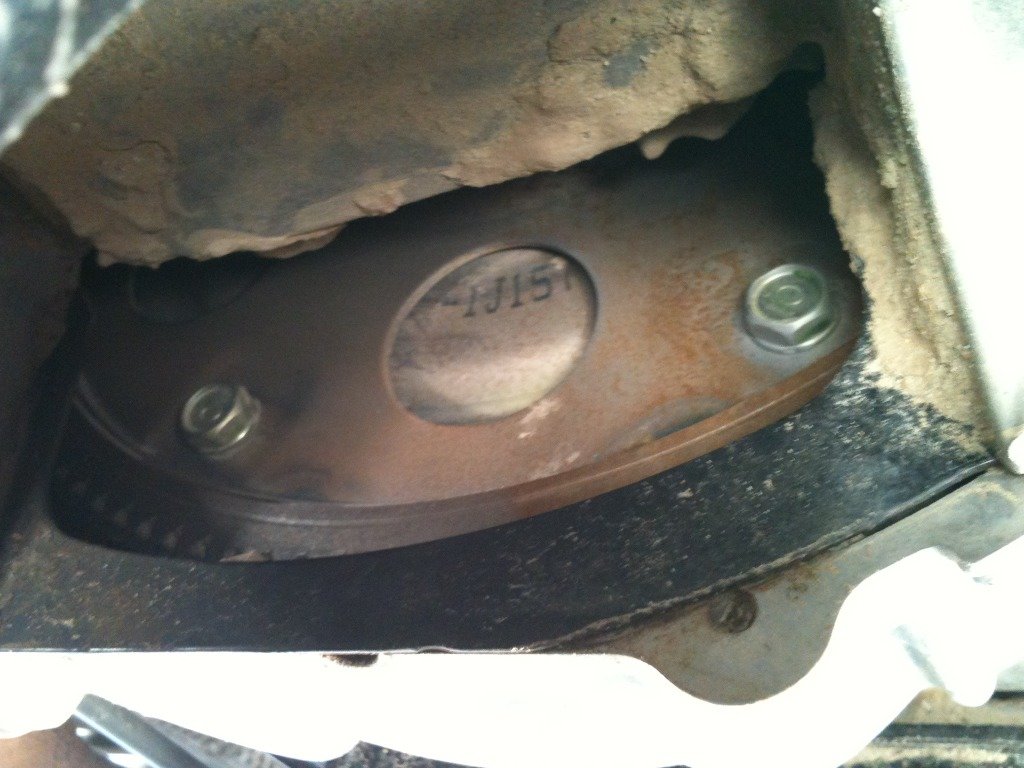

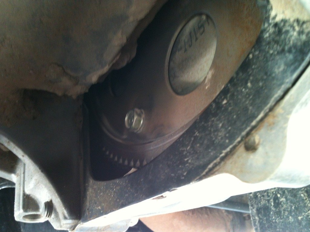

    Hey guys,
    I was power washing the mud from underneath my truck and i noticed that my flywheel is exposed. I did not see anything that seemed to be broken or torn off. But i just can't see toyota leaving it exposed like that.
    Thanks in advance!!
    Here are some pics of the flywheel

    Maybe an inspection cover. :notsure:

    Yes. Your inspection cover is missing. Two 6mm bolts (10mm heads), about 20mm long, and a little metal cover.

    Ps. Your holes are filled with mud.

    well that sucks, and now i can see the holes..
    Is that part likely to come off like that?

    There is a rubber cover missing, I replaced one on my '94. I am doing a little searching. I can't find it but take it back in ... warranty is a wonderful thing.

    It's not rubber on second gens. It's metal with rubber edges. It could easily fall off, not a huge deal. Just get a new one from a scrapper or a dealer.

    well i just ordered it from the toyota dealership by my house. it came out to be a whopping $9.44!!
