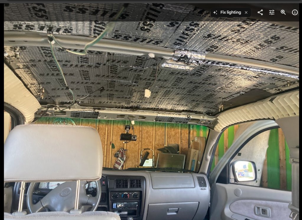

    Do it with the Amazon stuff. I can notice the only noise now are the lifter tick and the air noise from the weatherstripping. My truck can keep up with the heat outside now that it is insulated.
    I used Siless sound deadening and the other product they offer - mid grey looking stuff(not the aluminum lined sheet):
