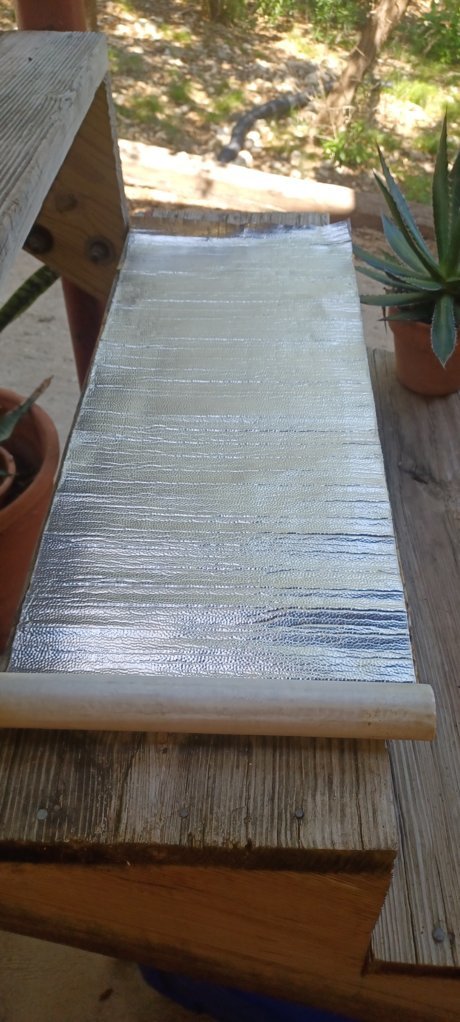

    Cool, i would use the other stuff dont get me wrong if it was a bargain. No brand name on material I used its generic foil backed peel n stick butyl comes in a roll no label basic roofing supply house stuff. I live in San Antonio 100 deg here all summer long no lasting smell for me once applied at all. I also put it in newer type vehicles and 3 of my own. Twas no down side. Here's a Pic of my leftovers. It smells inert as of now I actually just smelled it. I think a new roll has an odor but not like anything you would run from or wanna hurl. Never lasted a day after install. Smell for a day and save I'm in. BTW it's primary use in the roofing world is a moisture barrier.

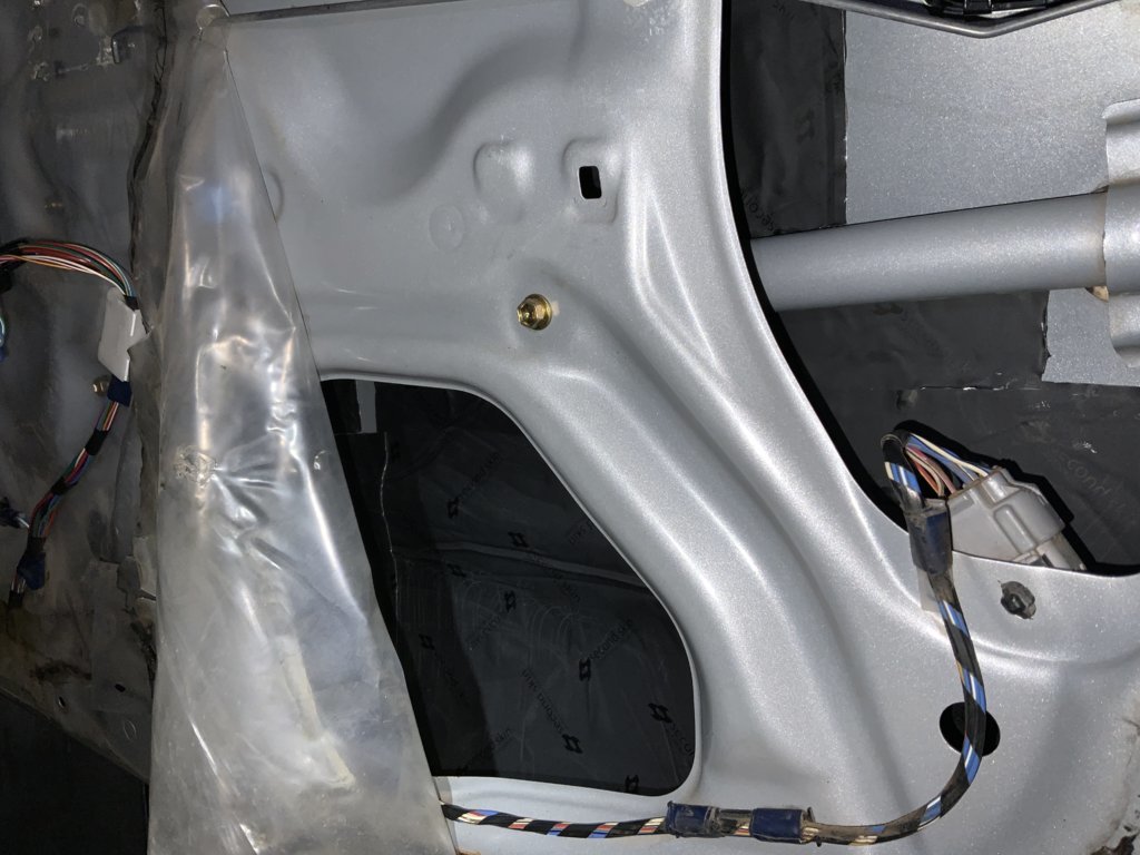

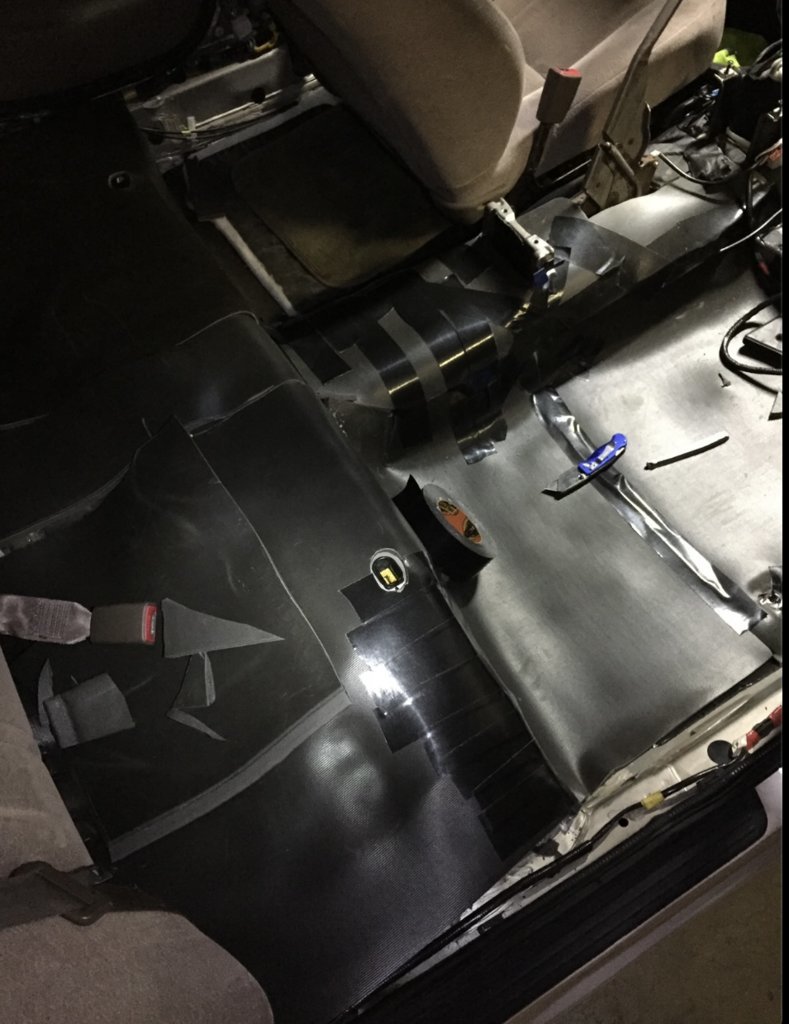

    So true. I did as much of the decoupled MLV over dampener as possible in my old Camry. It wasn’t fun trying to make it fit under the carpet. Could only do dampener in the doors. The goal was to make it as quiet as a LS400. Started approaching the point where it was counterproductive because you can’t really stop vibration or wind noise from the mirrors and standard, non acoustic side glass. It may reduce overall noise but it draws attention to spots you can’t do much about. I expect the same on this Tacoma but it won’t be at highway speeds often. Also there’s a lot more tire and mechanical noise from below.
    Man I just love how well made these old Toyotas are. Working on them is so rewarding.

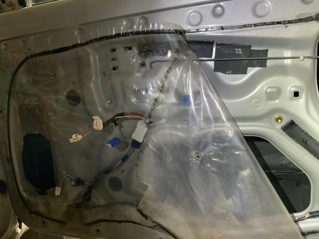

    Yeah, it’s totally worth it. I went over this one again more completely. Inside the door skin, behind the inner door frame and in the stamped valleys behind the door panel. I used to carefully measure and cut the dampener to make it look pretty. Now I just eyeball it and slap it on.
    The only issue is now the gear noise seems louder. It’s not and eventually it will get some attention.

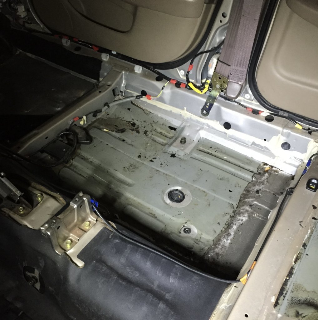

    I had to get the interior of my 2013 gutted so when everything was out I sound proofed everything. In hindsight I would have liked to have used more insulating foam but had an abundance of the heavy duty sticky stuff and no more $. new speaker sound good though and are loud enough to get over any cab noise. Good luck!!
